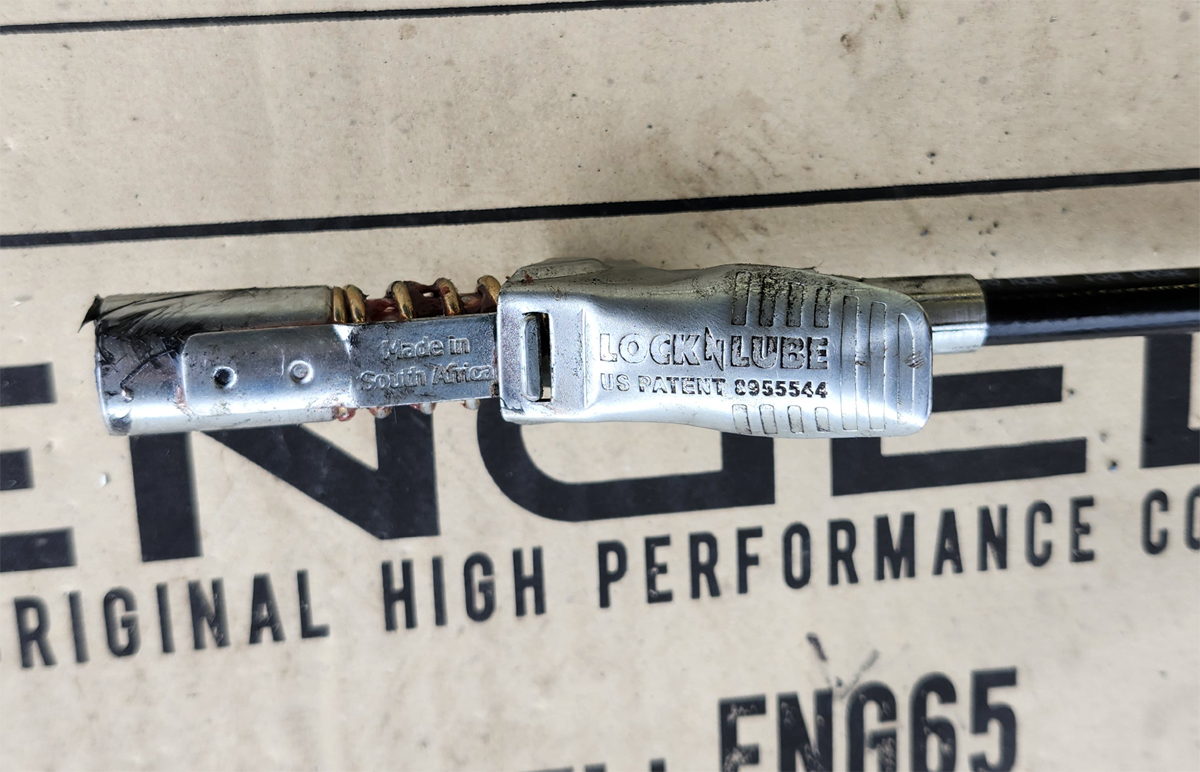

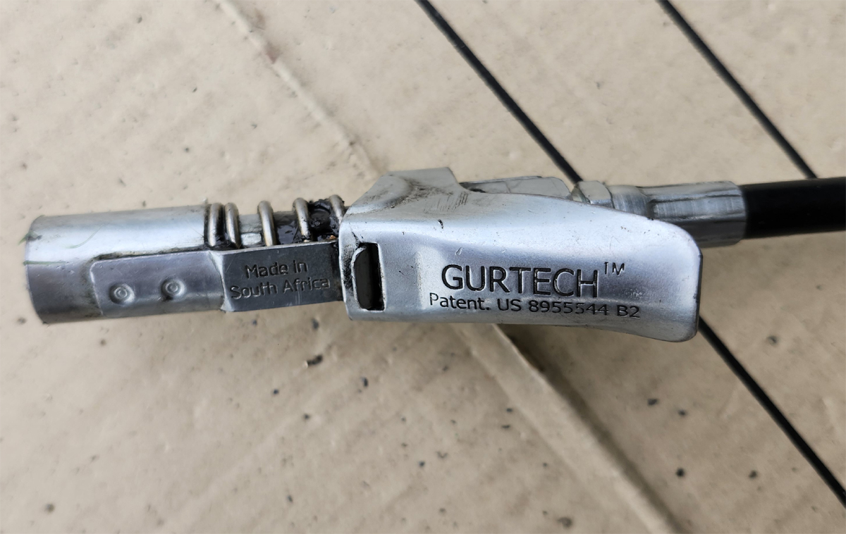

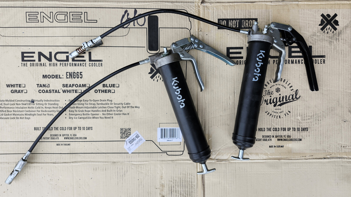

Congrats on the MX5400. I'm a fan of the MX series of tractors for sure having owned two MX6000s (still have one). I have four grease guns including two Kubota branded ones, a NAPA one and a DeWalt battery powered model. Looking at the photo of the Kubota grease guns below, I much prefer the first one I bought on the left to the last one I bought on the right. I modified the handle of the one on the right since I couldn't stand it. I much prefer the pistol grip type which only require one hand to operate. I would say that almost more important than the choice of grease gun is the addition of a LOCKNLUBE coupler available from Amazon and similar.

I would recommend a Lock N Lube coupler for your grease gun. They are a little pricey and have some limitations, but by-and-large make the process much quicker.

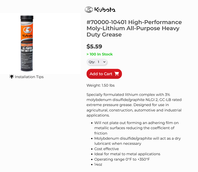

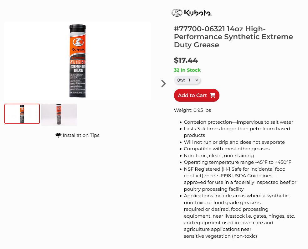

I buy grease from the Kubota dealer that's three miles from my house. I have the moly grease in one of the Kubota grease guns for the loader (it's almost black in color) and the synthetic extreme duty (green) in the other Kubota grease gun that I use for anything on the tractor. If you just want to use one grease then the polyurea is the one that many recommend.
But just like oil, there are lots of suitable products available from a number of manufacturers.
