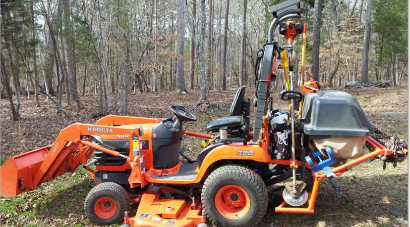

I leave the FEL on.. partly for not going through the hassle of taking it off, but also use the bucket for debris, bush trimmings, etc. I do have to be extremely careful in a few areas where I'm close to the house.. Bucket is down all the time on the slopes, but I have areas where goes all the way up so the front end can get close to fences, bushes, etc.
My ballast weight on the rear is the rear bagger assembly, plus other items back there that add substantial weight.

that's an interesting place for the bucket hooks, what's the good and the bad about them?
I use them with a wrap around rope or chain to pick up logs too big to get in the bucket.. the two on the back are oriented for the rope to go down underneath the bucket and under for example a large log and then back up to one hook centered on top of the bucket and then down underneath the log again on the other side hook..
This arrangement keeps the load centered directly underneath the bucket so it doesn't lessen the lifting capability by the load being further forward.
It's just the way I thought about putting them on, before I saw other methods in this forum.... Haven't found any down sides...
