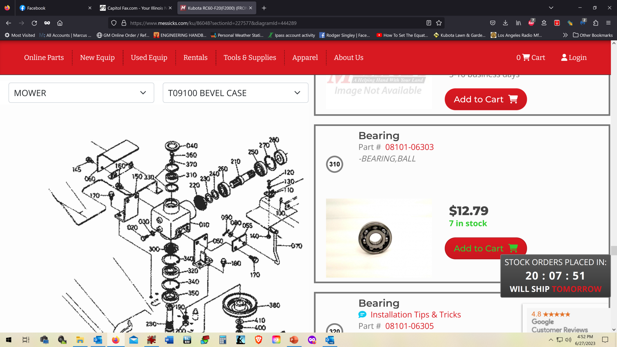

You could pour oil thorough the top bearing but I think you will find it much easier to fill through the check port without removing anything but that one bolt and without the likelihood of damaging something else.
This is the parts diagram courtesy of Messick's website:
