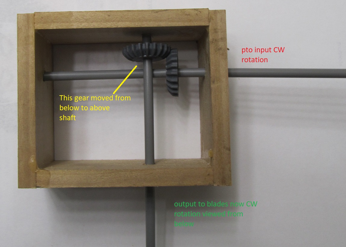

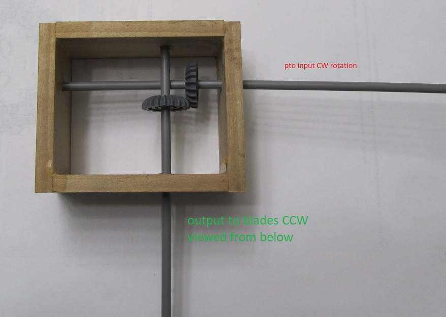

It would have to be the input-shaft or output shaft gears… the side gears would not accomplish that.
I am the first one to admit my ability to visualize machinery in 3D is greatly lacking so please keep that in mind when deciding how much weight to give to these comments.
In the mower gear boxes like the one for the RC48 deck, there are only two gears. This differs from 3 pt hitch style snow blowers where there are two outputs from the gear box. One output for the fan and a second for the auger. These two outputs are at 90 degrees from each other and these gear boxes must incorporate more internal gears than a mower deck gear box.
When the issue of reversing rotation first came up many years ago, I had trouble picturing the internal workings in my mind.
I bought educational model parts so I could easily play with the possible variations on my desk instead of fighting with oily. greasy parts.
These are my simple models showing how the relocation of one gear reverses the output shaft rotation.

I realize the relocation of an internal gear will not be as simple as in a model. Machining may be needed. My point if to provide a possible soultion if nothing else works.

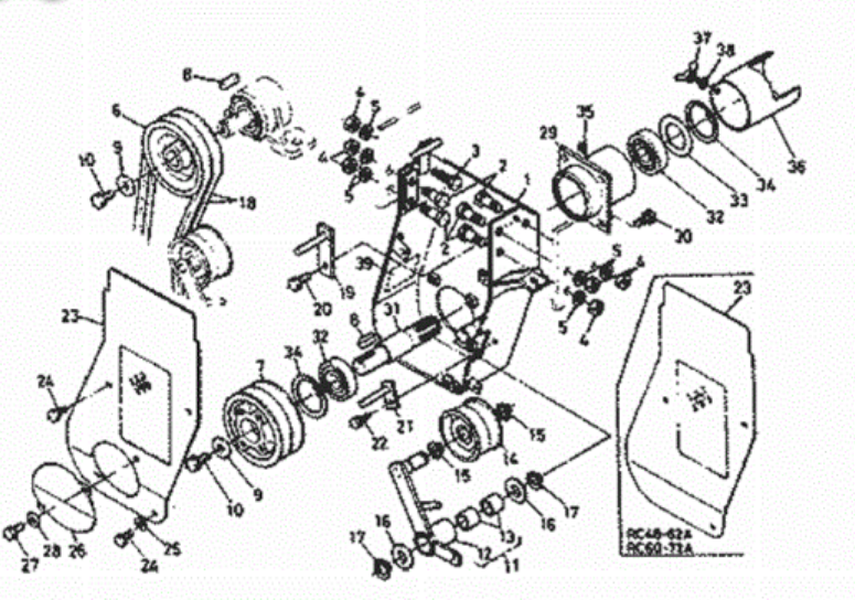

The RC48-62A front PTO kit
The gear box the same mower. It does not appear to be any way you could move the gear without fabricating your own output shaft and even if you did you may not have the room inside the gearbox to accommodate the change.
Actually, I don't think the diagram rules out the possibility (although it's not clear, for sure).
If the output gear can be flipped over and installed above the input gear by re-arranging some spacers, it might work.
If the same basic mower was made with front- and rear-facing input shafts, it would seem plausible that a convertible gearbox might be used. The fly in the ointment would be that the input RPMs have to be the same so the gear ratio is the same.

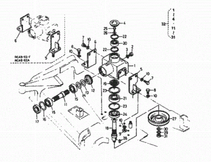

I don't see on the RC48-62A gearbox any way that I can flip/turn it to reverse the rotation and use as is. I am contemp;ating the possibility of re-routing the belt so it is driven in the other direction by the drive pulley at the bottom of the gearbox. Current problems in that approach:
1. I need to remove the center blade spindle pulley to get at the bracket on the side of the gearbox (needs to be modified for belt clearance): there's a 22mm nut on top, and I can't jam the pulley tight enough to break that nut loose.
2, The belt re-routing I am currently looking at would leave the flat side of the belt being driven by the V-groove on the drive pulley--not an ideal power transmission. Any suggestions for a flat-groove pulley to substitute for the drive pulley, and things to watch out for while changing it over? Or, could I take a short section of a v-belt and glue it in place in the pulley groove, leaving the flat side of that piece to match the flat side of the mower belt??

Your RC48-62A has clockwise input. There is/was a RC48-62H designed for counter-clockwise input. It seems to be similar, except the driven gear is on top instead of bottom.
It has a different shaft but the same gears, so I was optimistic that you could just install that shaft in you gearbox. Alas, the bearings and gear housing part numbers are different, so they probably don't interchange. Unless you have a dealer/source where you could physically compare the parts, I don't know how to figure it out for sure.
A RC48-62H gearbox would probably fit your deck, but a new one is about $800. I don't have any idea on the availability of a used one.
I'm afraid your idea to reverse the belt is doomed. Driving the flat back side of a belt would only give you a fraction of the drive horsepower of the vee side. I have seen pictures (but never hands on) of double-sided v-belts made to drive off both sides. But I suspect they have stricter reverse bending allowances, and they may be fractional hp only.

It might be worth the time and effort to get the parts info for both the gearbox you have and the 'h' version PTB refers to. Maybe you just need to buy a new output shaft ? as I assume the gearboxes,bearings and seals might physically be the same ??
The housing and output bearings have different part numbers. So, unless OP can physically get his hands on them to compare, I don't know what to advise. I didn't compare the input shafts and bearings.
