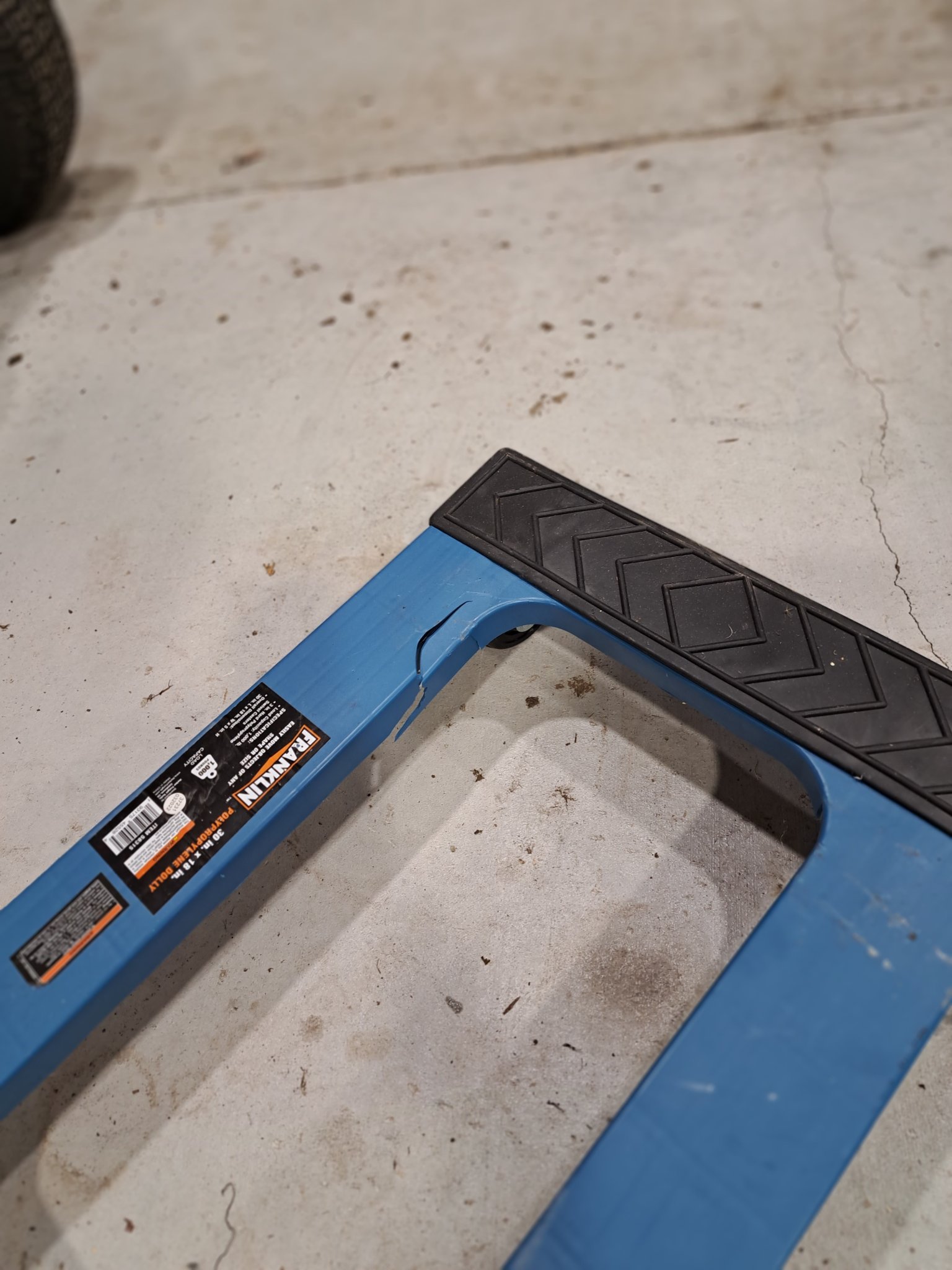

Although I have about 10 of those HF dollies, there is no way in hell they can support 1,000 pounds.
I have crushed a number of them with my ballast box. The first pic is the HF "Mac Daddy" dolly after setting my ballast box on 2 dollys.
After building a number of dollies for various things, my main advice would be to use wheels no smaller than 5-6 inch's. Unless your garage floor is as clean as a surgical room. (the wheels in the pic are 6 inch HF wheels)
These homemade dollies handle my Ballast box and Backhoe with no problem, and they rollover small stones with relative ease.
5 year old grandson pushes them around.
