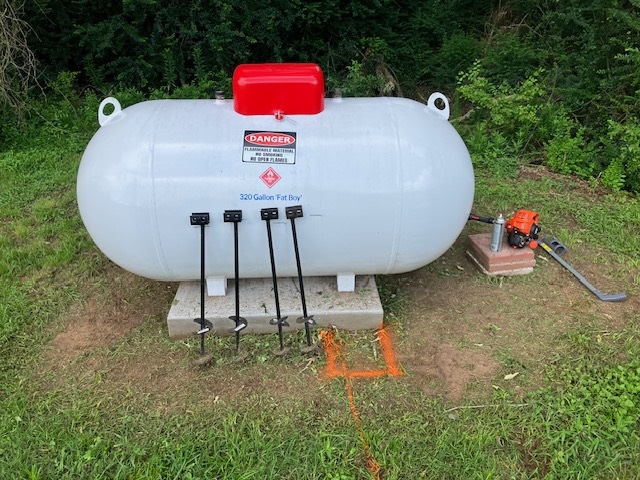

Yes, and using the curl/dump you can regulate how tight the chains get. I'd think you don't want to curl the bucket to the point you add more load to the chains than needed.
Depending on the lift capacity of his FEL....he may need to 'curl' the bucket to lift the tank.
My tractor's FEL would just barely lift my 320 gallon tank using the boom function and I had to 'curl' the bucket to get the rest.
