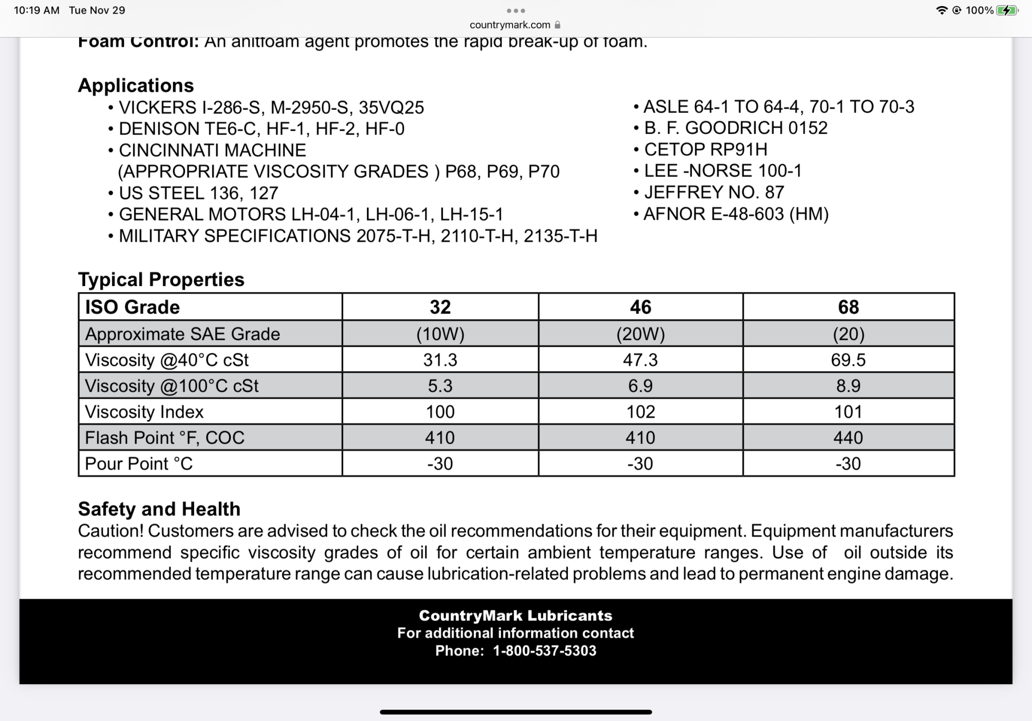

They use different bases but all the additives are generally the same.
46 is a mineral oil base, 32 is low temperature hydraulic, 32 may be a PAO base. But guess what, PAO and mineral blends have been around for at least 40 years.
Most AW hydraulic oil is mineral regardless of grade. For those that dont know the AW denotes a beefed up anti-wear formulation. Synthetics are uncommon and expensive. SUDT2 is a decent AW32 hydraulic oil.
