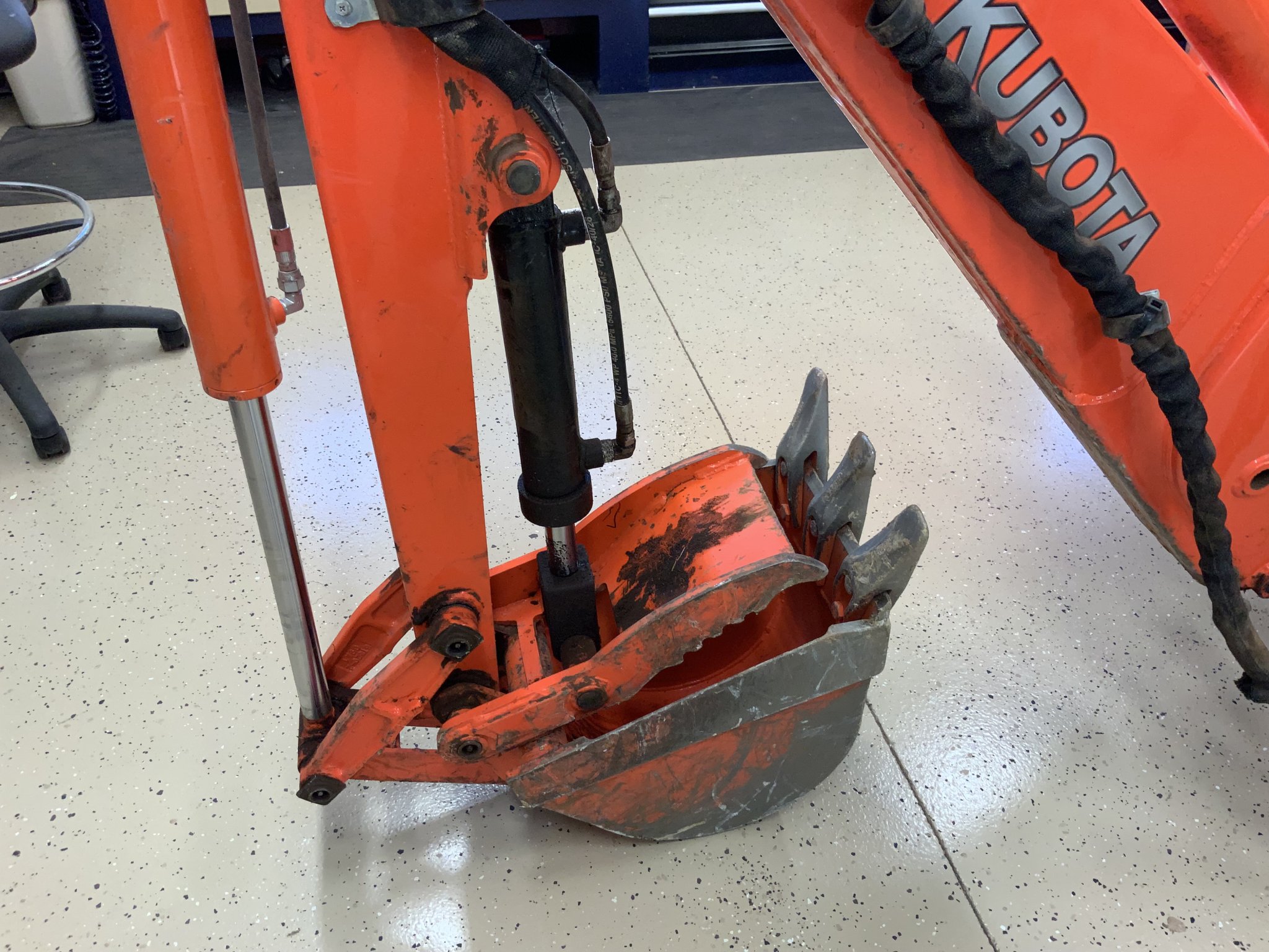

This is what you want. It gets very tiresome hopping on and off the BH.
And as mentioned, you are the brains of the rig…and will feel/hear the stopping point. View attachment 112731
I figured I'd "walk" before I "run"! LOL
