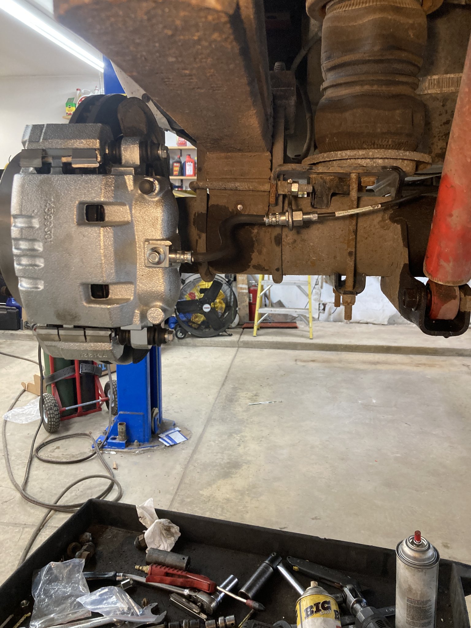

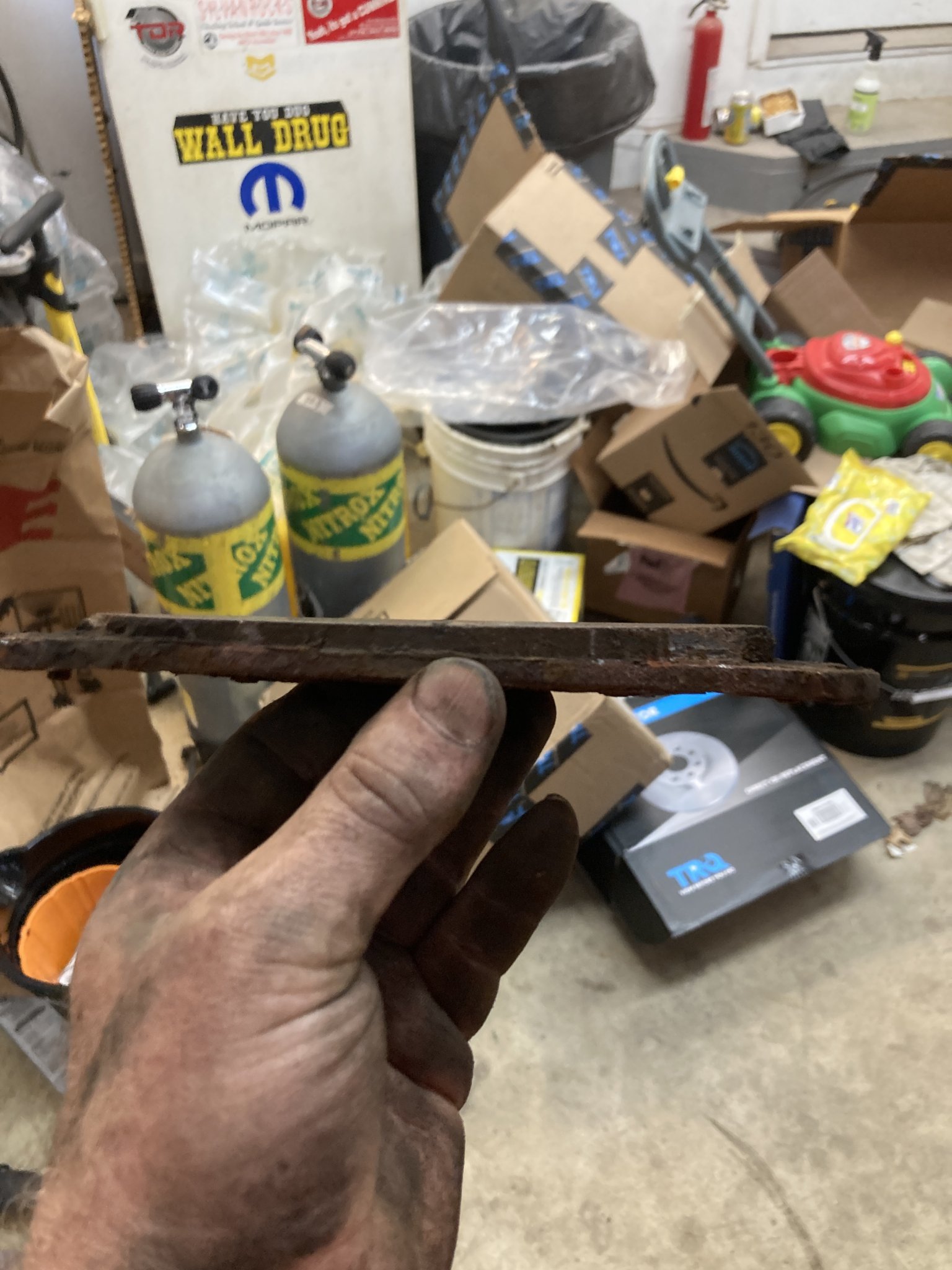

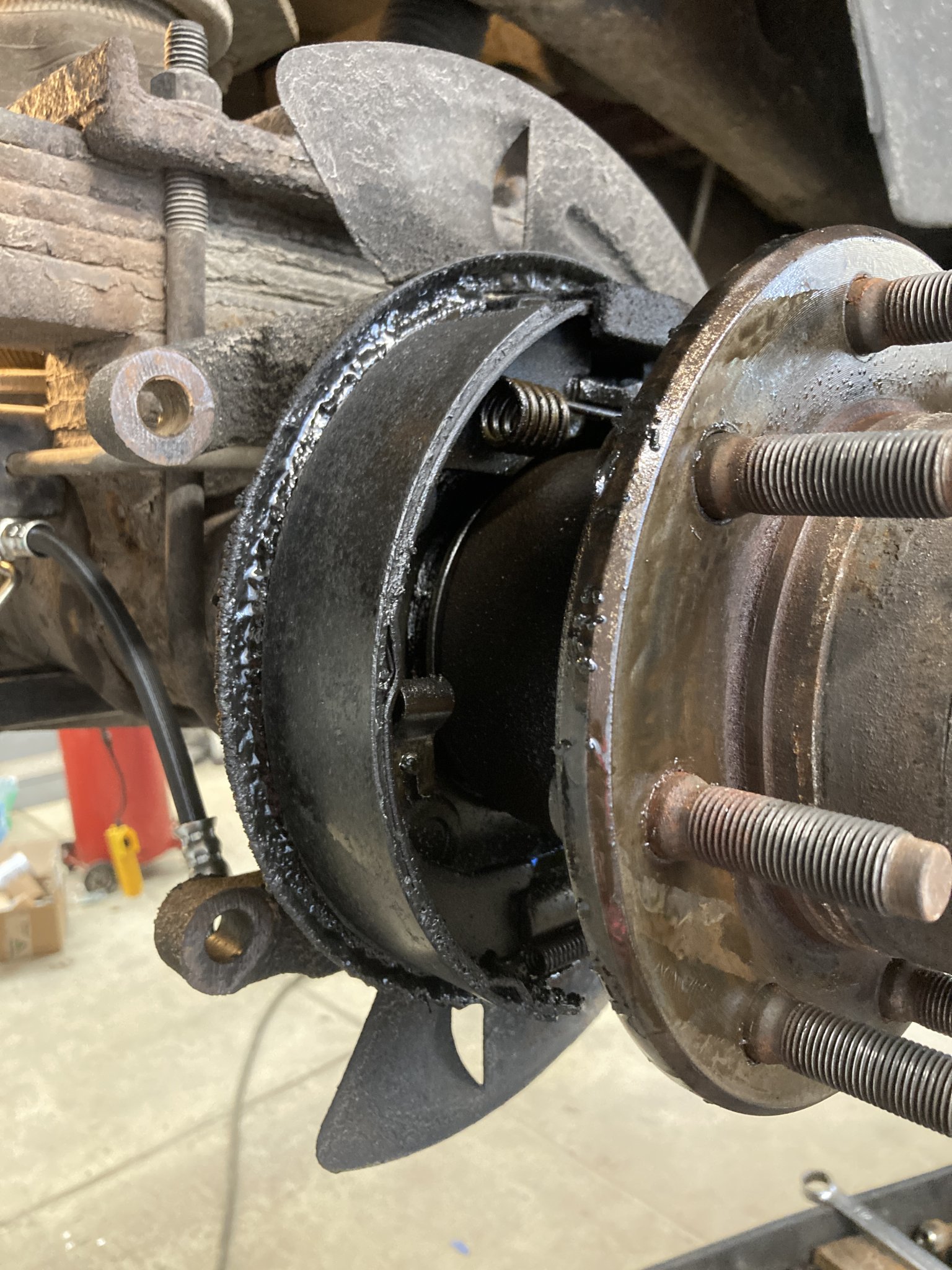

Here is the outer pad when I got it removed.
Something is "clearly wrong"

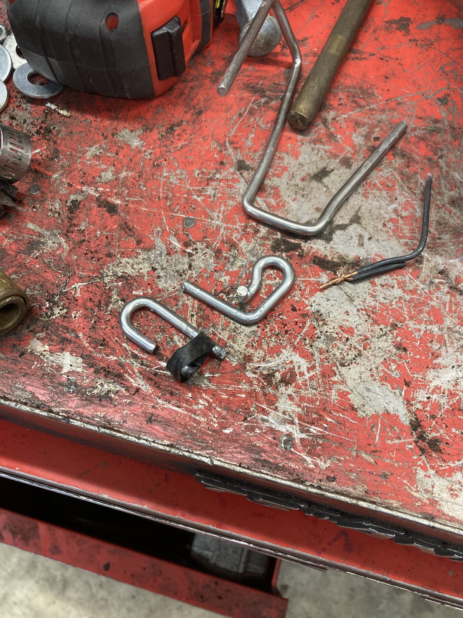

Here are the first casualties, the bolts for the brackets that hold the brake lines/hoses
I didn't even try the brake lines, they are in the kit so I just cut them.
But now the lines/hoses will be "flopping around" and I just can't have that nagging my subconscious.

Ironically, as I am looking at the pic I just took of the "carnage", I notice that piece of SS TIG welding rod that I had used as a "test bend" for another project, and it looks suspiciously like the "proper'ish" diameter of the piece I just broke.
Now my mind starts 'whirling"......hmmm......

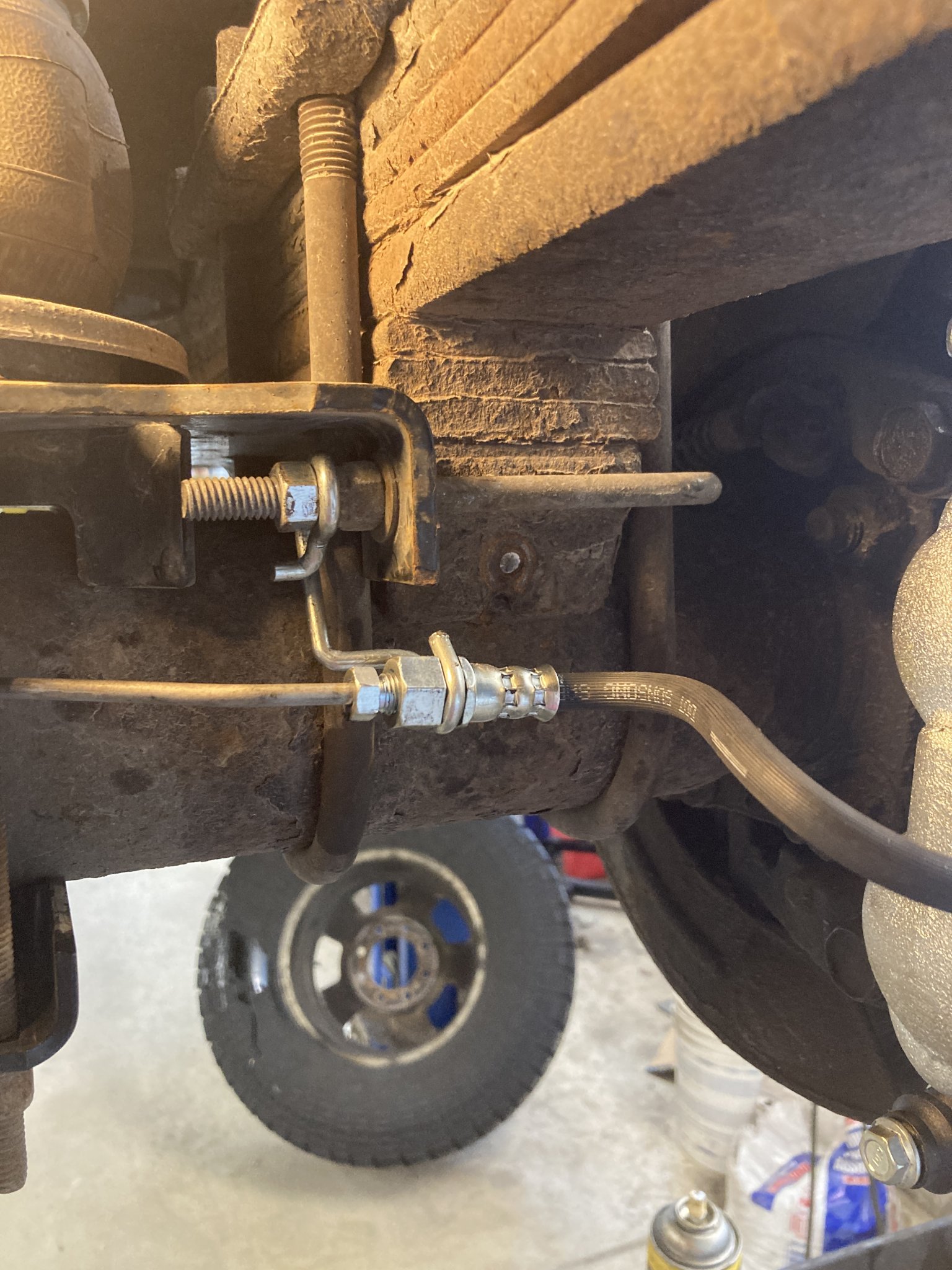

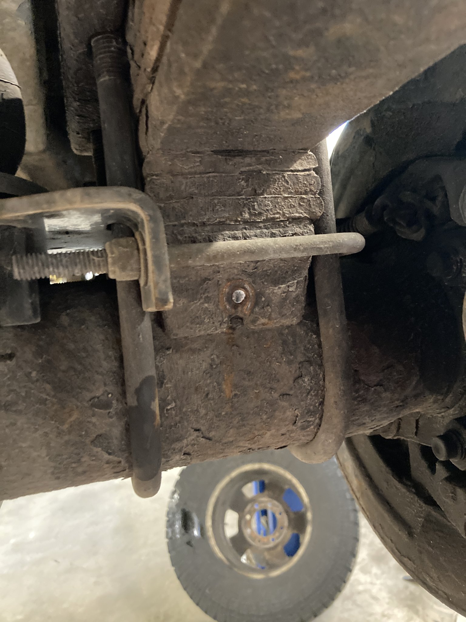

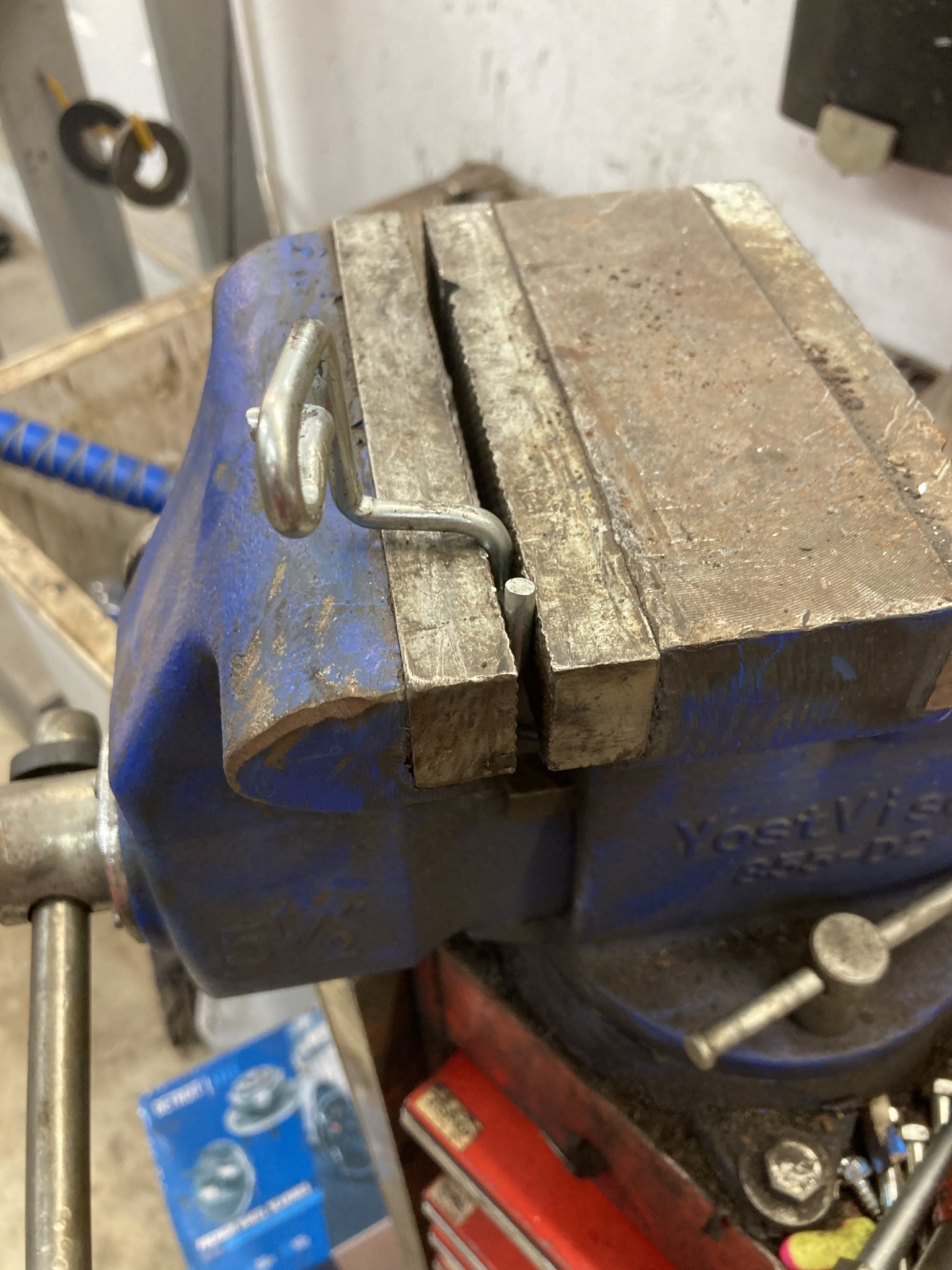

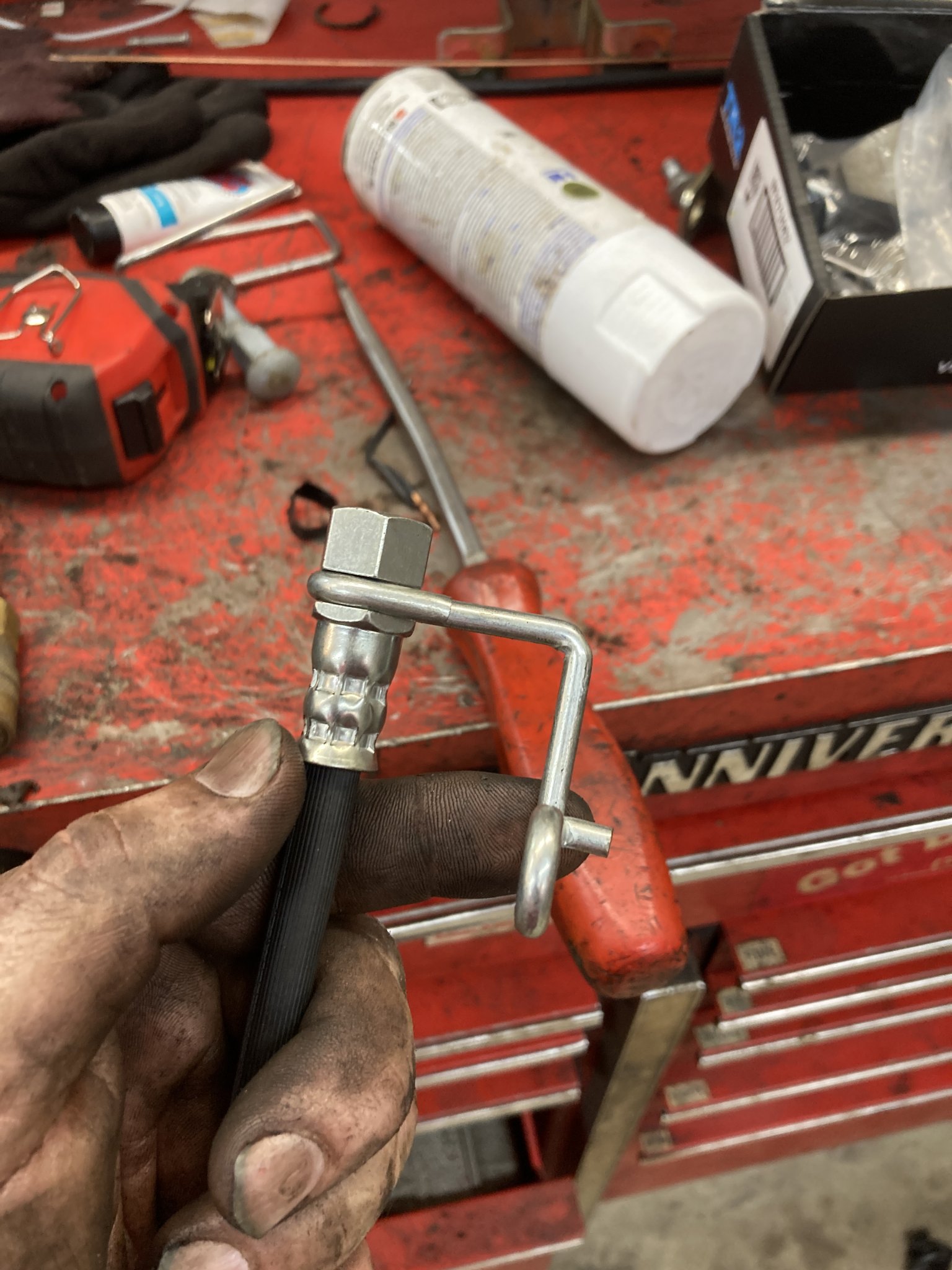

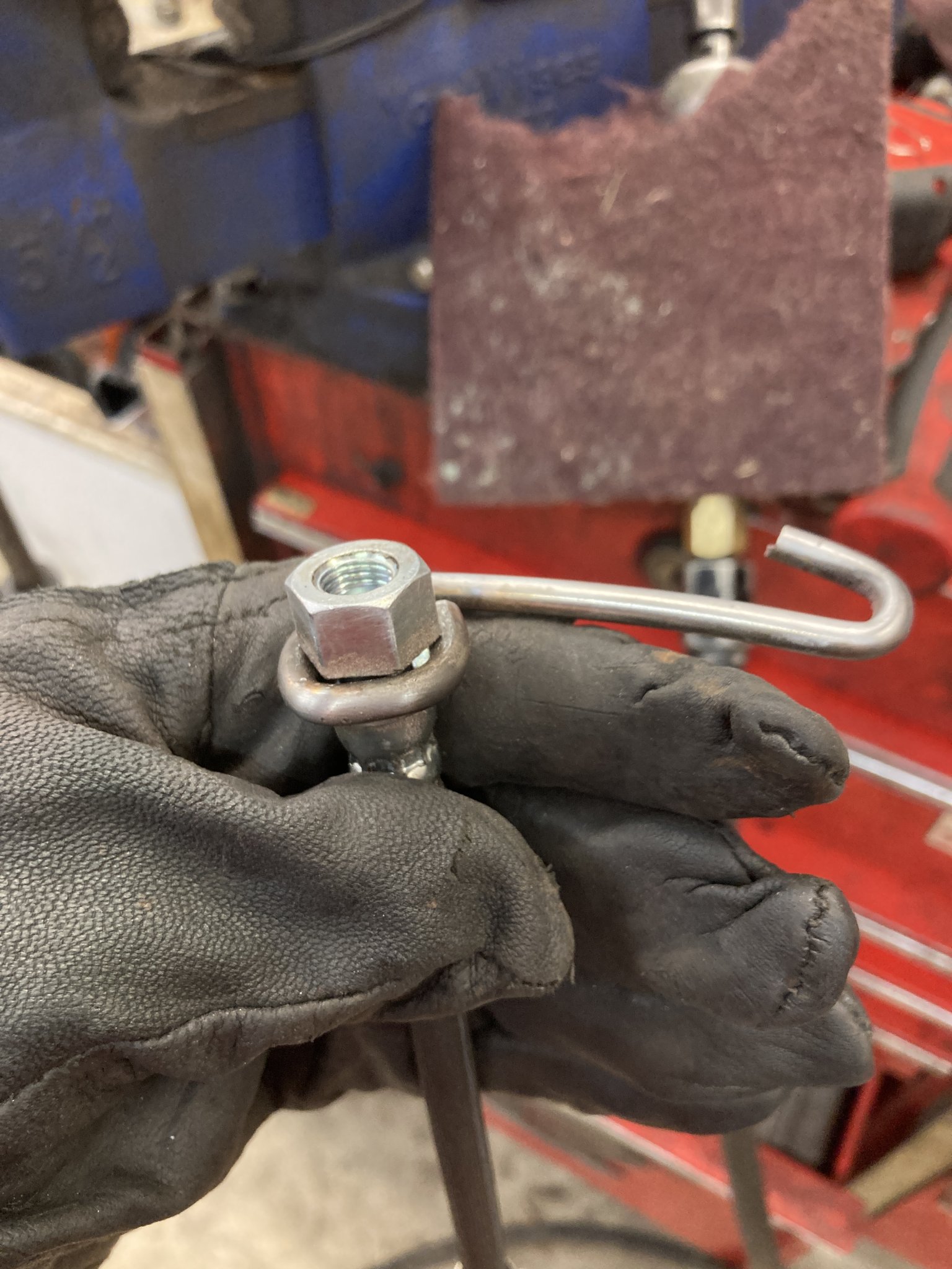

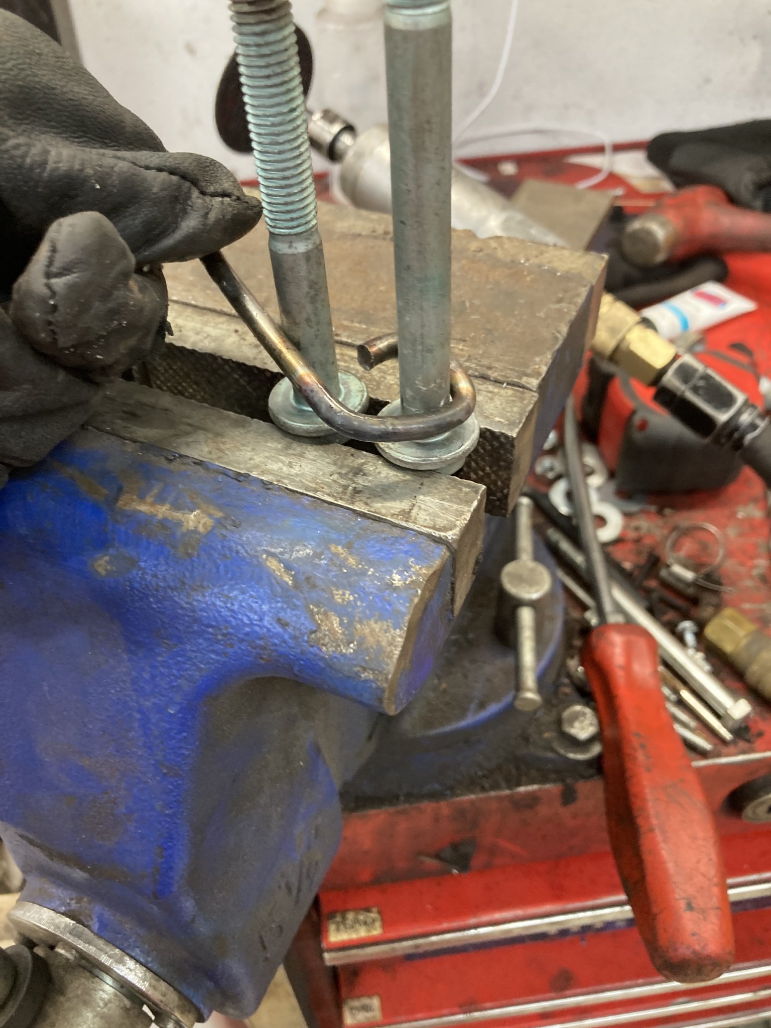

I decide to make a " quickie jig" in order to put the necessary 'sharp bends" ,
a little heat, and some "finagel'ing" and I get a "not so pretty, but useful" bracket.
I decide to make use of that long bolt sticking out of the rear air bags I installed a couple of years back.
The threads aren't too rusted......yet.
Both port and starboard sides come out "reasonably well
Should be "good nuff" for now......
I did however find that both axle seals are leaking
DAMN IT.........it's always something, aint it?
I am contemplating just rebuilding both axles simply due to "age " .........
Look at that! Can't stop an ole tech from MacGyverin something up.
That looks pretty darn professional sir. Wish I had a setup like that at home for workin on my own junk.
