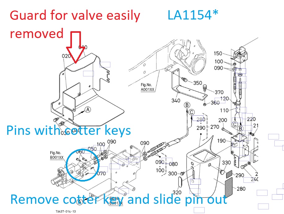

Could be the loader control cables. Disconnect them on one side and see if the lever moves freely.

I think there is a metal guard protecting the loader valve which is easily removed.
Disconnect the cable connection to the valve spool as JasonW suggests and see if the cable moves freely.

Figured out what the problem was. I removed the lever/controller cover in the cab. I was able to see some corrosion on the tops of the pivots and there was some squeaking. Applied lots of WD40 then lithium grease to the controller and cleaned the pivots. Added WD40 to cables and links. It now works like new. I suspect that moisture and dust had worked its way up the cable and in the linkage. Something to add as part of my regular maintenance.
