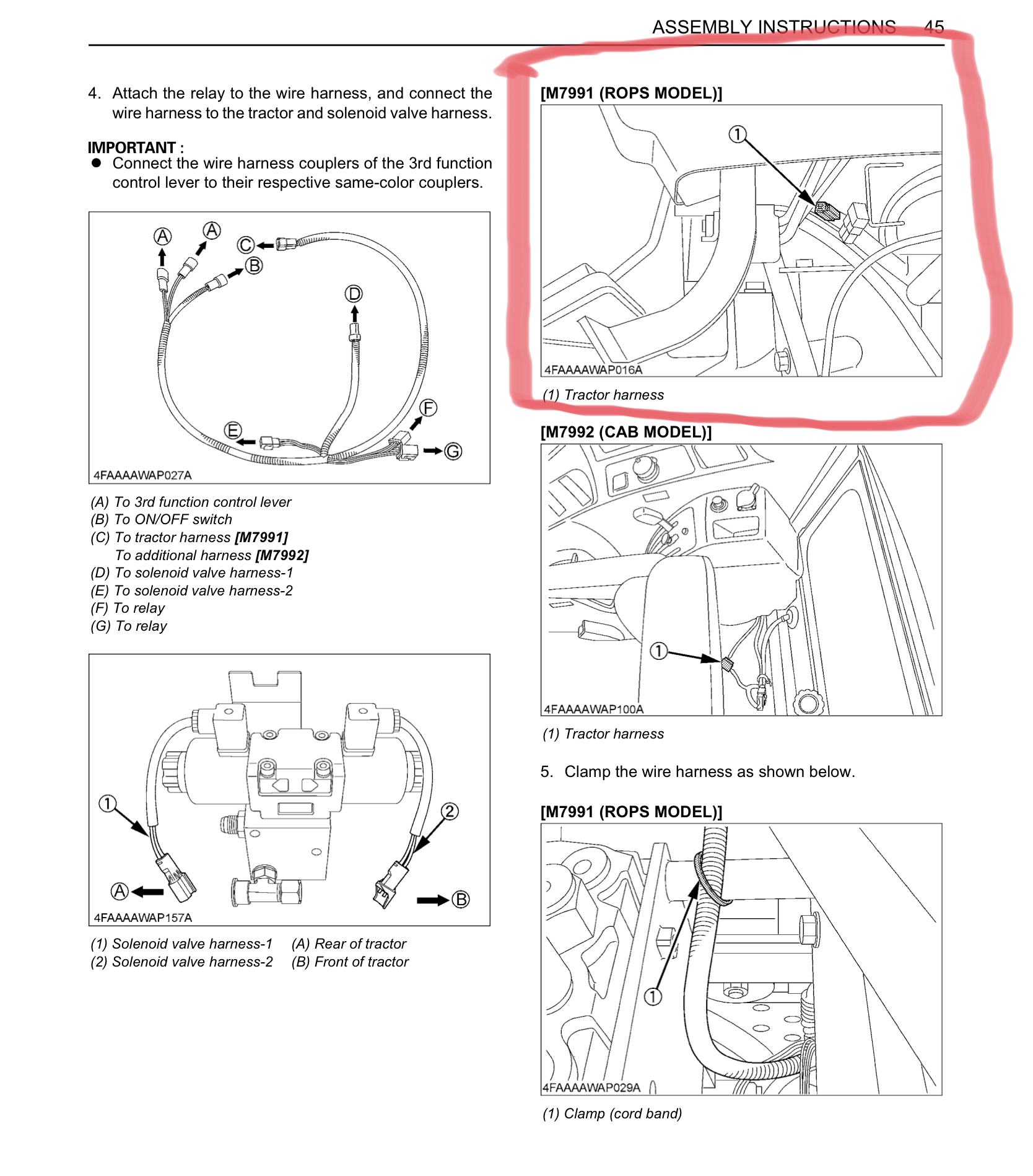

I have been working on a Kubota 3rd Function Kit install and am finding that the wiring harness install is a bit confusing. Working from the diagram in the LA1154A Loader assembly instructions (see below) I see that C, the kit harness connects to 1, the tractor harness. I can’t tell from the diagram exactly where that is on the tractor. Also, is this connection made to a connection that is open on the tractor? I don’t see any non-used connectors anywhere near the valve assembly that I mounted.
Any help would be appreciated.
Also, If there is anyone out there who has installed this kit and is willing to DM about it with me, that would be greatly appreciated.
