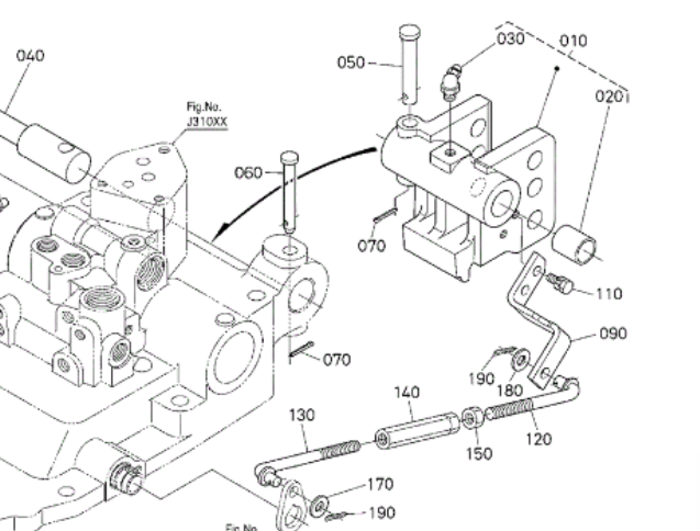

Status Update:
I have the 3ph working properly now on my 7060. Yea! Stop reading now if the details bore you.
I did download the service manual as suggested by Dustyx2 and focused on the section on position and draft control linkage. I started with the position control and adjusted the position control rod back to factory specs, then went on to do the other adjustments listed in the manual. Well, I could not achieve right results before going back to reset the position control linkage back to about where it started. Bottom line, there was no issue with the position control settings. The lift arms worked fine with no implement, both raising and lowering, and so I decided to test it by putting the implement back on. No good. It still would not lower with an implement on without moving draft control lever back an inch and return to full forward.
Next, and after reading the manual for adjusting the draft control, I realized the draft control works based on force from the top link. There is another rod called a draft feedback rod and I figured it would be the key. I adjusted the turnbuckle a little in what turned out to be the wrong direction and the implement would not lower no matter what I did. But, when I turned it the other direction I was able to solve my problem. The surprising part is that I measured the rod against the turnbuckle before I started and it only took a 1/16" adjustment (1/4" total change in rod length) to make everything work properly. It now raises with the position control lever and the speed control valve works as it should too. I didn't have the tools to fully test the draft control as outlined in the manual, but I am not really worried about that.
Thanks for all the advice from you folks on the forum.

Thank you for the details, my tractor was working perfectly and while using it the 3pt wouldn’t lower. It was acting exactly as you described when moving draft control it go down almost too slow to see, adjust the feedback link and it works so thank you again for the details.
