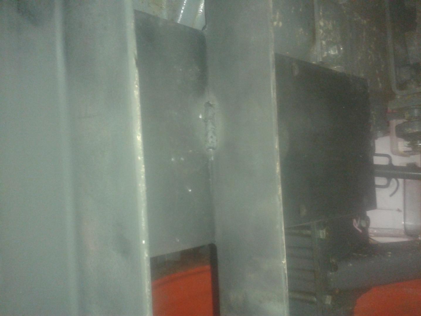

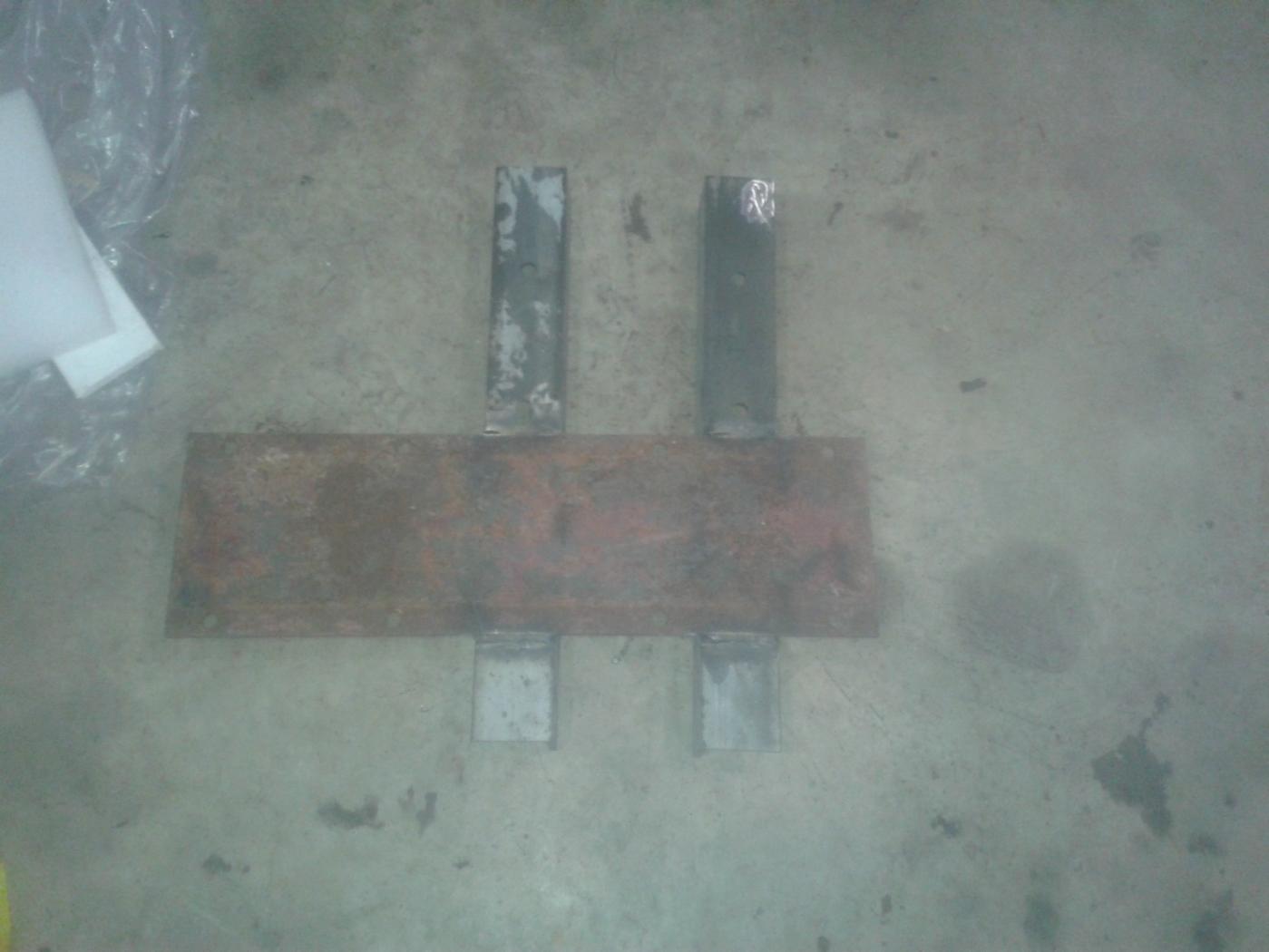

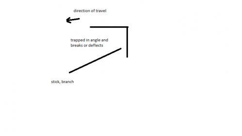

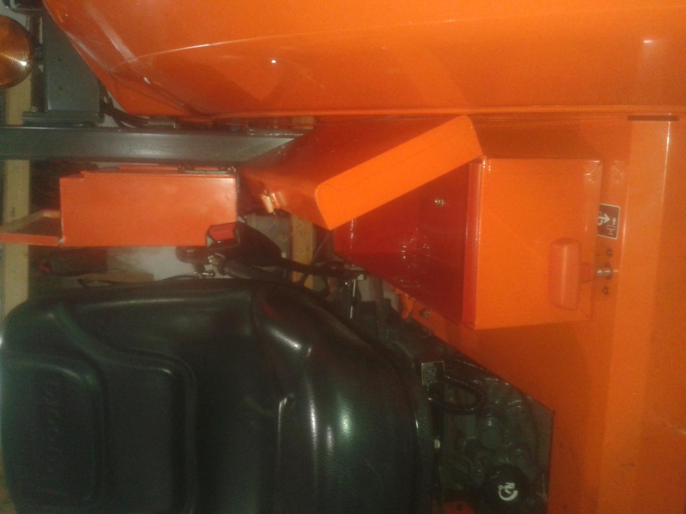

here are some of the things I've done to my M7040 tool box was $17can from Walmart.ca. its 16"x6"x6.5" just fits between 4wd shifter and rops, lid dosen't open all the way but still enough to get whatever is needed, and it's not plastic! Skid plate I just through together with what was laying around. the angle iron is longer in case I decide to add to it. IMO if one is to use angle iron for support have it with the angle so a stick will ride up and get trapped in the angle and break instead of riding up the face and into the tractor. see attached image.

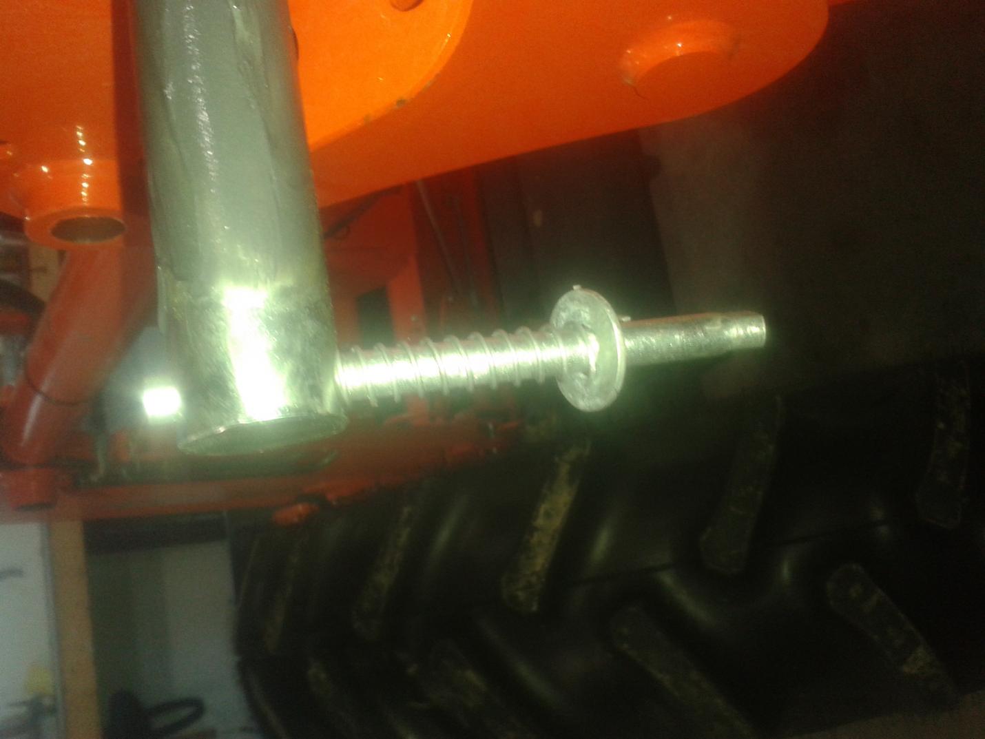

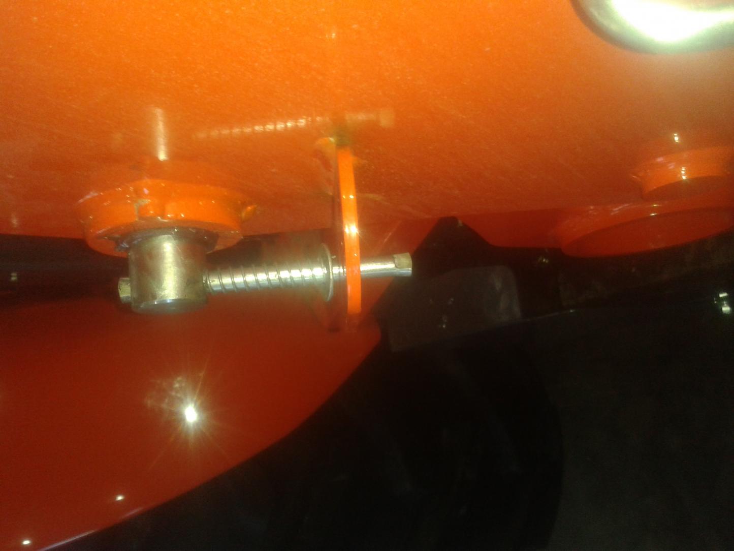

good to hear, I found there's not as much info on the bigger tractors so that's why I posted it. also if you have a loader have you seen the loader pin mod with the spring and washer have hear of guys having the pins back out on them. cheap insurance
Is there some kind of pin keeping the washer from falling off? Can tell from the pictures.

great Idea on the ammo box just saw them the other day in the flyer. wish I would have thought of that instead oh well!! And yes I used a cotter pin just drill a small hole in the keeper pin part than slide your spring on than washer and install cotter pin and bend! done.
