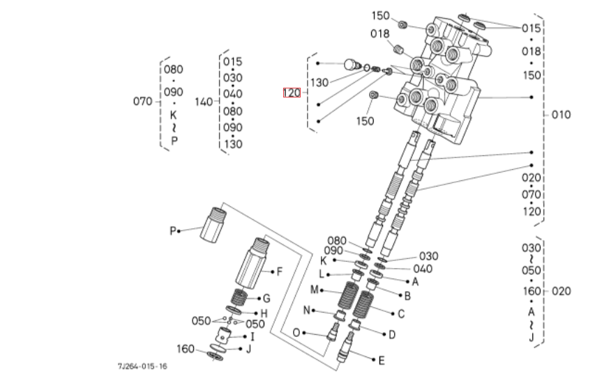

I am assuming you have the LA1154 loader. It came standard with the valve shown below. The self leveling valve was available as an option and is a lot more complex. Nothing in this diagram jumps out to me as a relief valve. Item 120 is described as "valve" but it looks like a load check to me. However quantity list says one but the diagram shows it going into two ports and quantity for oring 130 is two so something is clearly wrong. I am betting its a load check, there are two of them, and the pressure relief is somewhere else in the system.

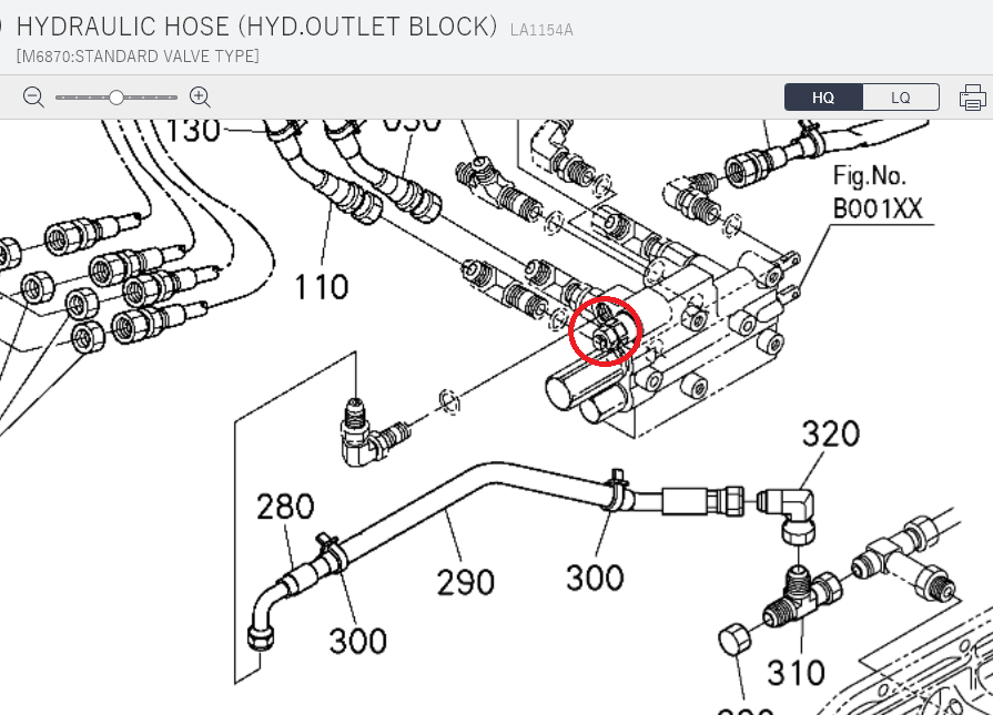

Damn Kubota documentation sucks. Here is the parts diagram for the hoses. The item circled in red sure as hell looks like a relief cartridge/valve of some sort.

Yep you are right LA1154 and that is an adjustable pressure relief valve. That was one of the first things i checked, even switched with the one on the 3 point. Both where clean and seated. Tried adjusting with no luck. At first I thought I would find some trash stuck in a relief valve from installing the control valve and hoses to the front for the grapple bucket.
Thanks for the diagrams!
