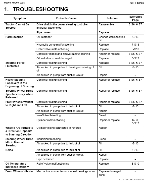

You might be right, but symptoms of an issue with the steering controller include the following:
  • Hard steering
  • Fluctuating steering force
  • Heavy steering
  • Steering wheel turns on its own when released
  • Front wheels wander to right AND left
The OP states that the tractor merely wanders to the right, not right and left, and didn't mention any of the other symptoms. It'll be interesting to see what the problem is. Of course, the WSM information below is for the M7060/6060 but I imagine it's similar for the M6.
  • Hard steering
  • Heavy steering

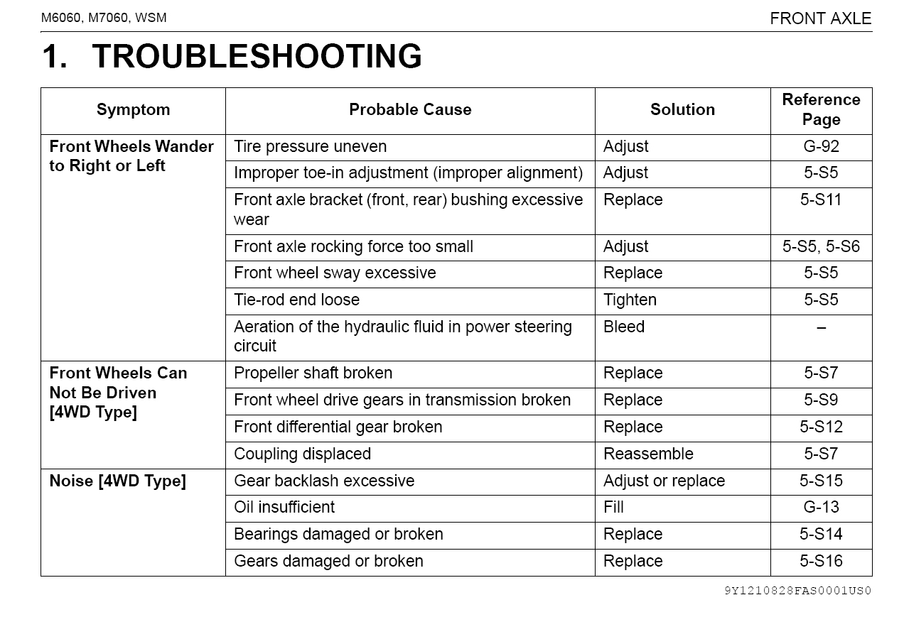

Any update @Stanky Lipshitz? I was looking at the M6060/M7060 WSM this morning and noticed this in the front axle section for the symptom of front wheels wander to the right or the left. Uneven tire pressure and toe-in out of adjustment are the first two things to check.

I hope it fixes it too, but if it doesn't, you might want to revisit the last WSM screenshot that I posted.
I definitely saw that, and laughed. It wouldn't surprise me at all if the problem is in the front end, as suggested by your post. But hey, who doesn't want a new steering controller??? (I don't for sure, if it doesn't fix the problem)
