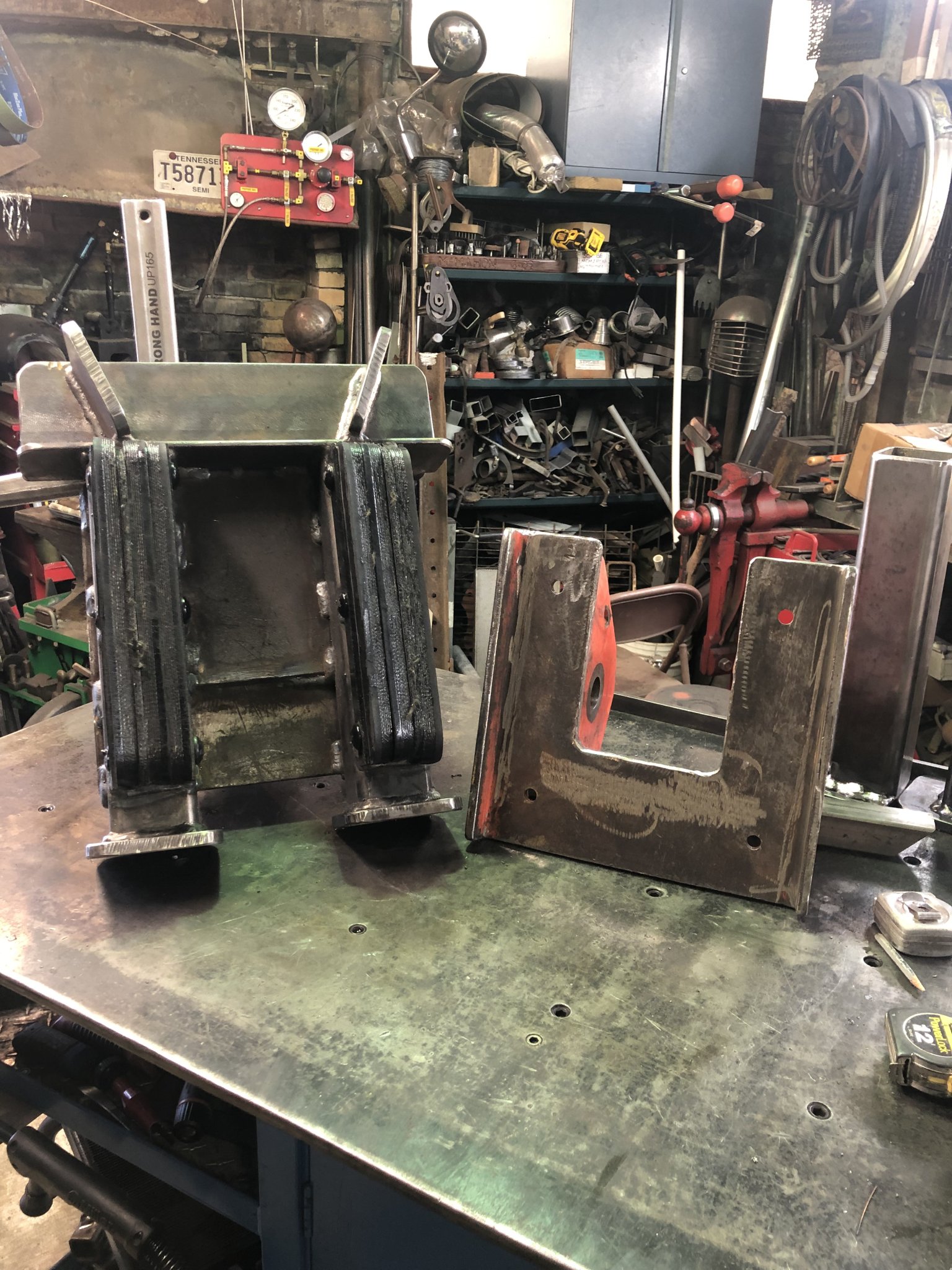

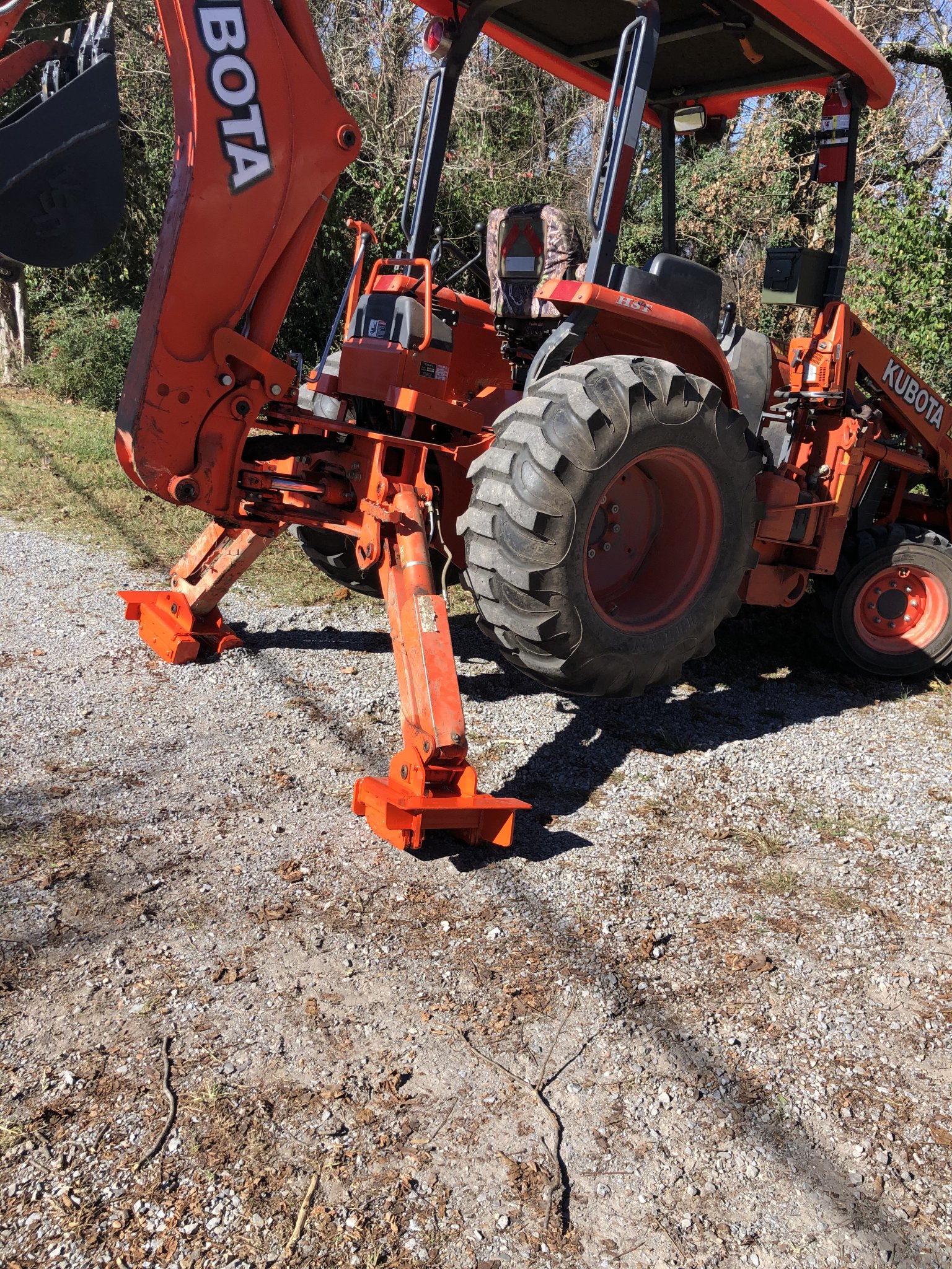

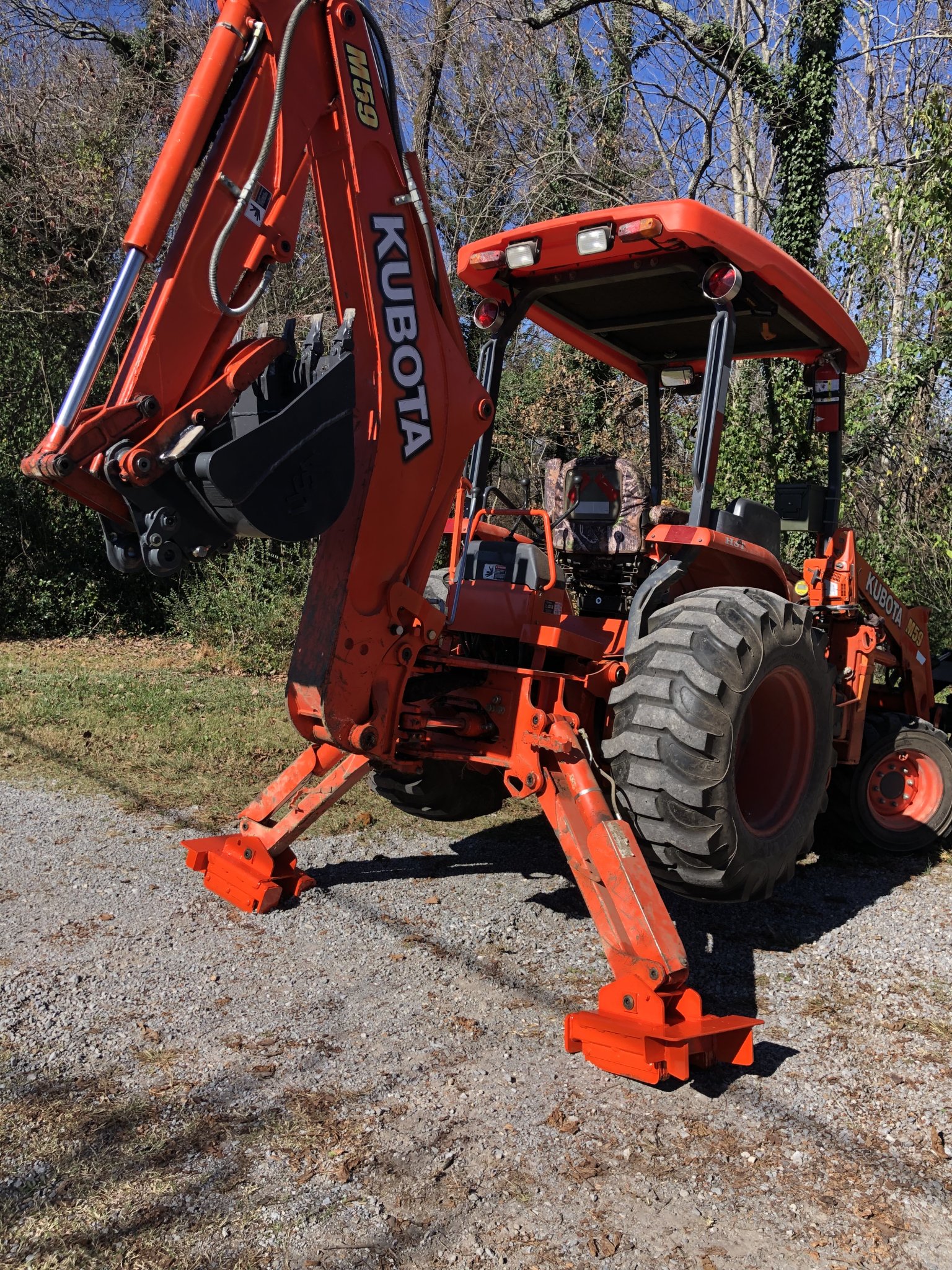

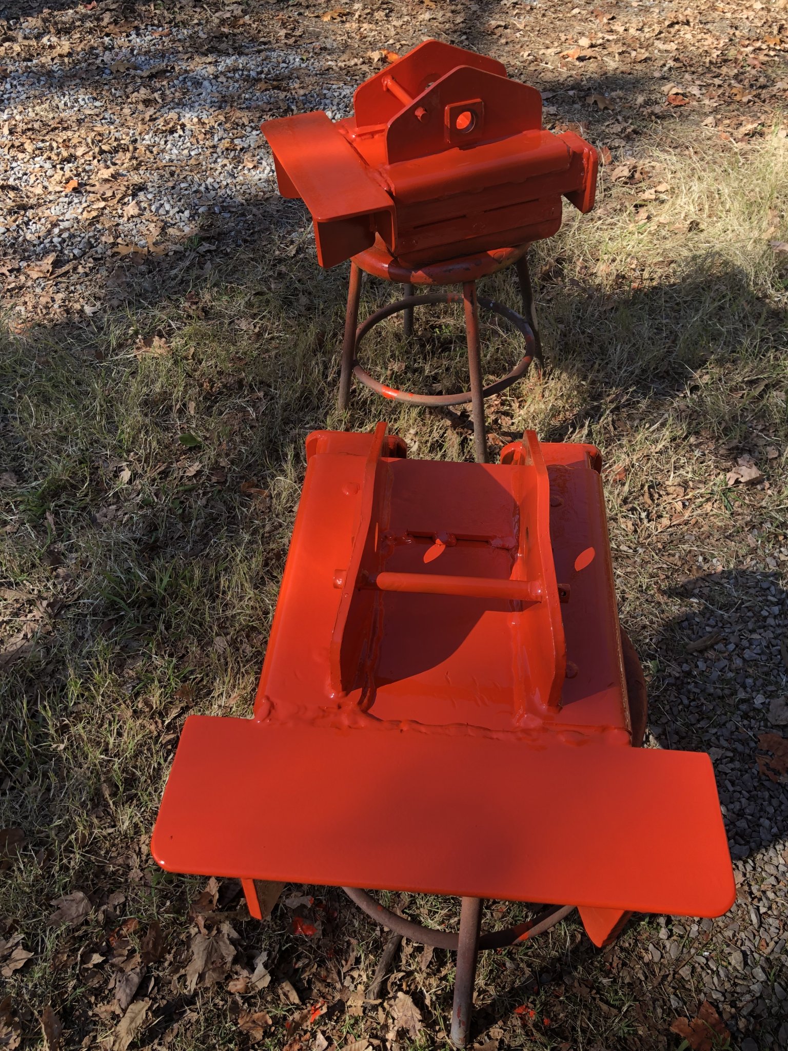

Increase area 2.5X to prevent sinking.
Increase height 6”
Rubber pads engage 1.5” before cleats.
D19B0FE5-BB97-4AA2-A9B2-548EBF79B8BE.jpeg 72223448-000B-47EE-8FFF-838334782786.jpeg 0E7BCB88-6FC9-47BE-895C-B1F1DF664228.jpeg 4F010E49-D85C-4776-AAE5-45F32893AA65.jpeg

Agree with keeping CG low as possible. Some ground is soft so increasing area and height will help. Digging on slopes also need height to plumb machine for stability. 5.5” longer should help tipping sideways.
Increased pad weight from 21 to 82#.
Rubber pads helped sliding on all surfaces on other backhoe. Kinder on hard surfaces and landscaping.
Pairs well with recent excavator quick attach buckets.
