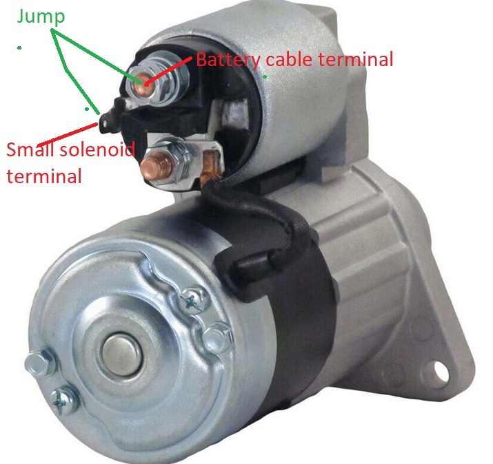

This would be a good time to learn to jump a starter. Extreme caution must be used as you can end up getting run over with your own tractor or having a run-a-way machine. Best to have someone in the seat with the brakes applied.
Jumping the starter is the best test to ensure the starter and battery/cables are good. Use a screwdriver or short piece of wire. Expect a small spark. The engine should crank instantly if the battery and cables are OK.
