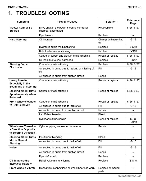

I doubt bad seals in the steering cylinder would cause that. It doesn't usually work that way. I'd say more likely something wrong on the hydraulic side of the steering circuit, or maybe even something mechanical in the front spindles, but not the cylinder.

I don't have an M5 or the WSM for it, but here's the Steering Troubleshooting section from the WSM for my M6060. If you don't have the WSM for your M5 you might want to get it, but maybe this list will help you.
