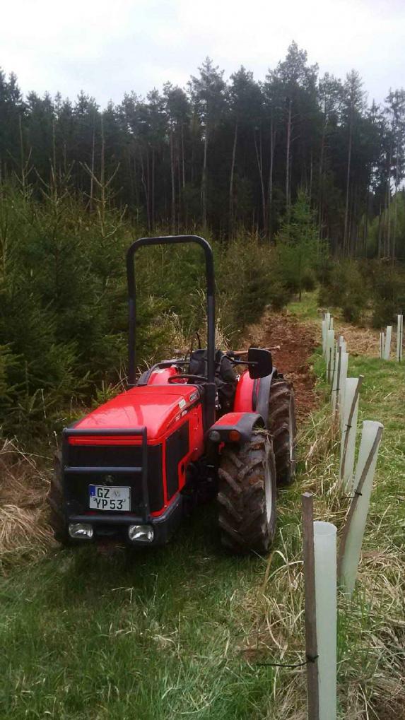

Hi,
All depends, what hilly means for you,
A 1in1 grade sideways is tricky especially with hidden rocks, stumps or the like. Les then that depends...
The italians sell alpine trctors, makes are
Ferrari bcs pasquali and antonio carraro,
Low center of gravity and wide track width, twin tyres help a lot too
If you can go up and down your hill a fwd is helpfull, more so going downhill,

Hello,
Then let s just keep things simple:
Twin tyres on the rear help a lot,
The smaller the diameter of the tyres, the better too.
Enjoy your tractor
Rgds
Robert
