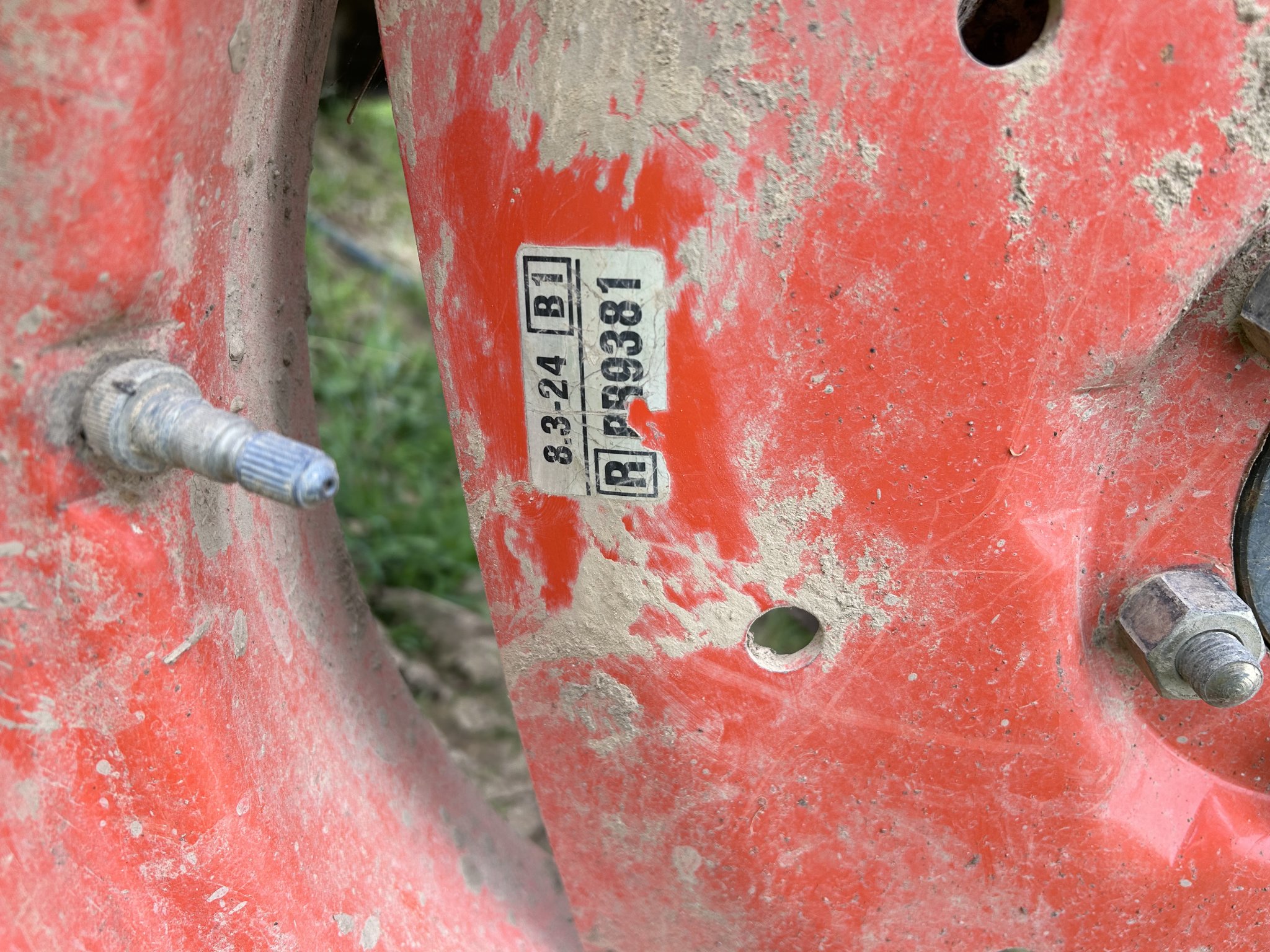

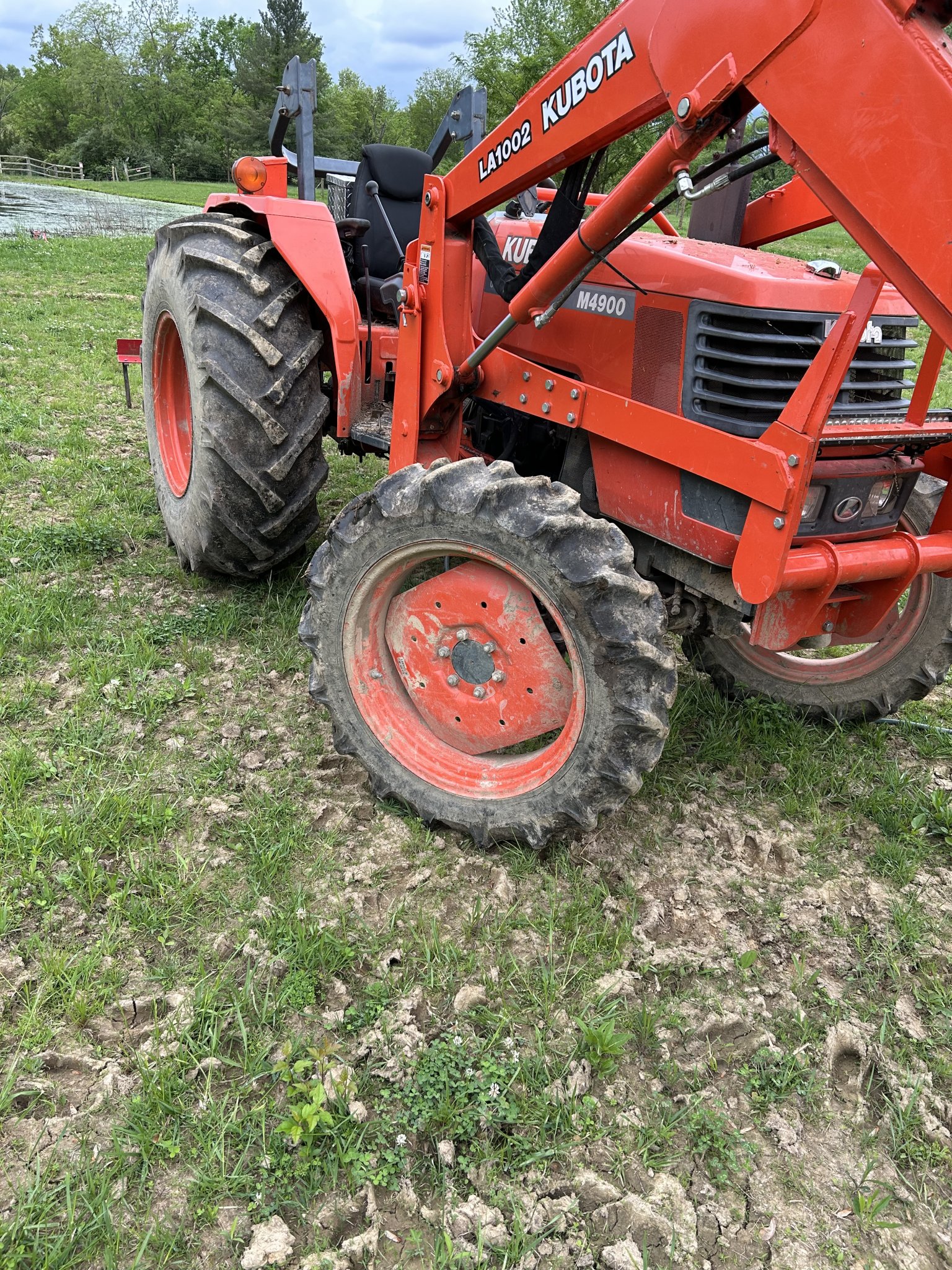

Hello, I have a 4x4 M4900 Special Utility.
My lug nuts came loose and both my rims are cracked. The rims are 1 piece 8.3-24. I can’t seem to find any replacements and all the 2 piece rims I find say 22”. Can anyone point me in the right direction?

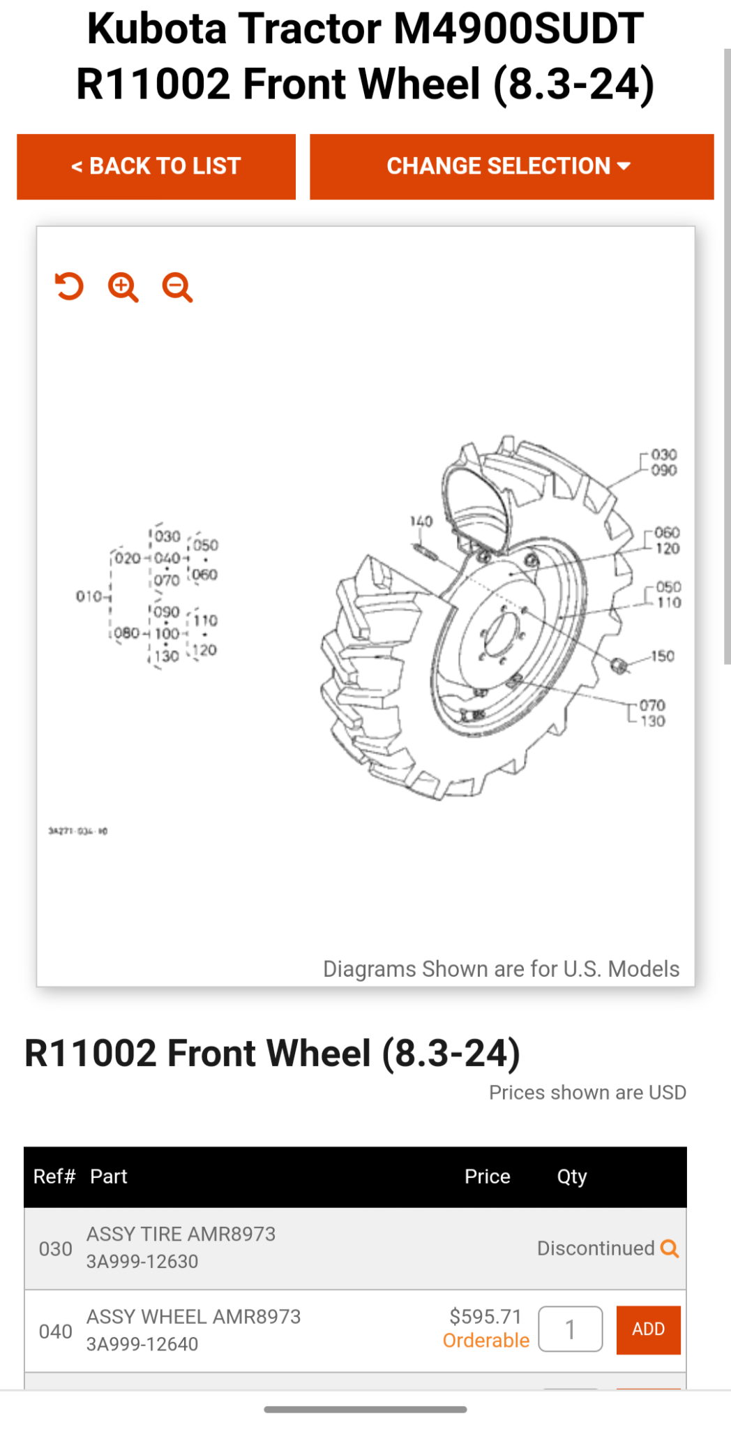

Thanks, what web site did you find this diagram? I did call my local dealer and she was no help at all.
PoTreeBoy
L35 Ford 3930
Mar 24, 2020
3,516
2,102
WestTn/NoMs
It's a parts diagram from WWW.KubotaUSA.com.
I looked at several M4900 models before I found a 24". BTW, you won't like the price. If you look long enough, you may find a one-piece. If it was mine, I'd have it repaired, these aren't highway vehicles.
