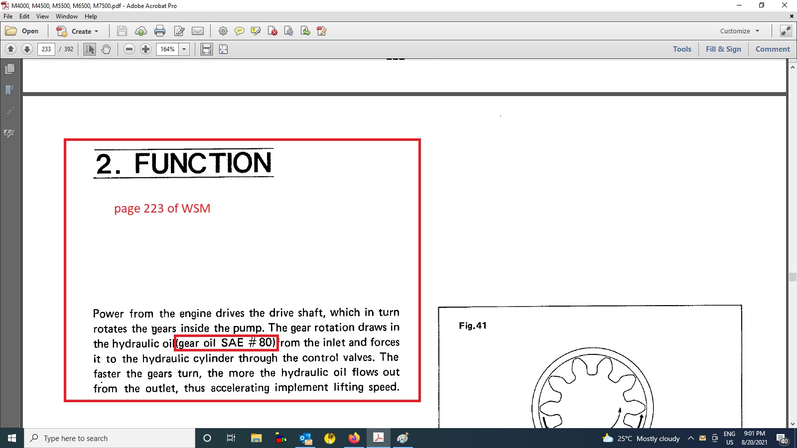

Your vintage Kubota is more like a Fiat tractor painted orange. My point is that the usual Kubota oil cautions are not so relevant.
From page 223 of WSM:
You need to rule out any air leaks on the suction side of the pump. I have shown typical locations on the parts illustration.
