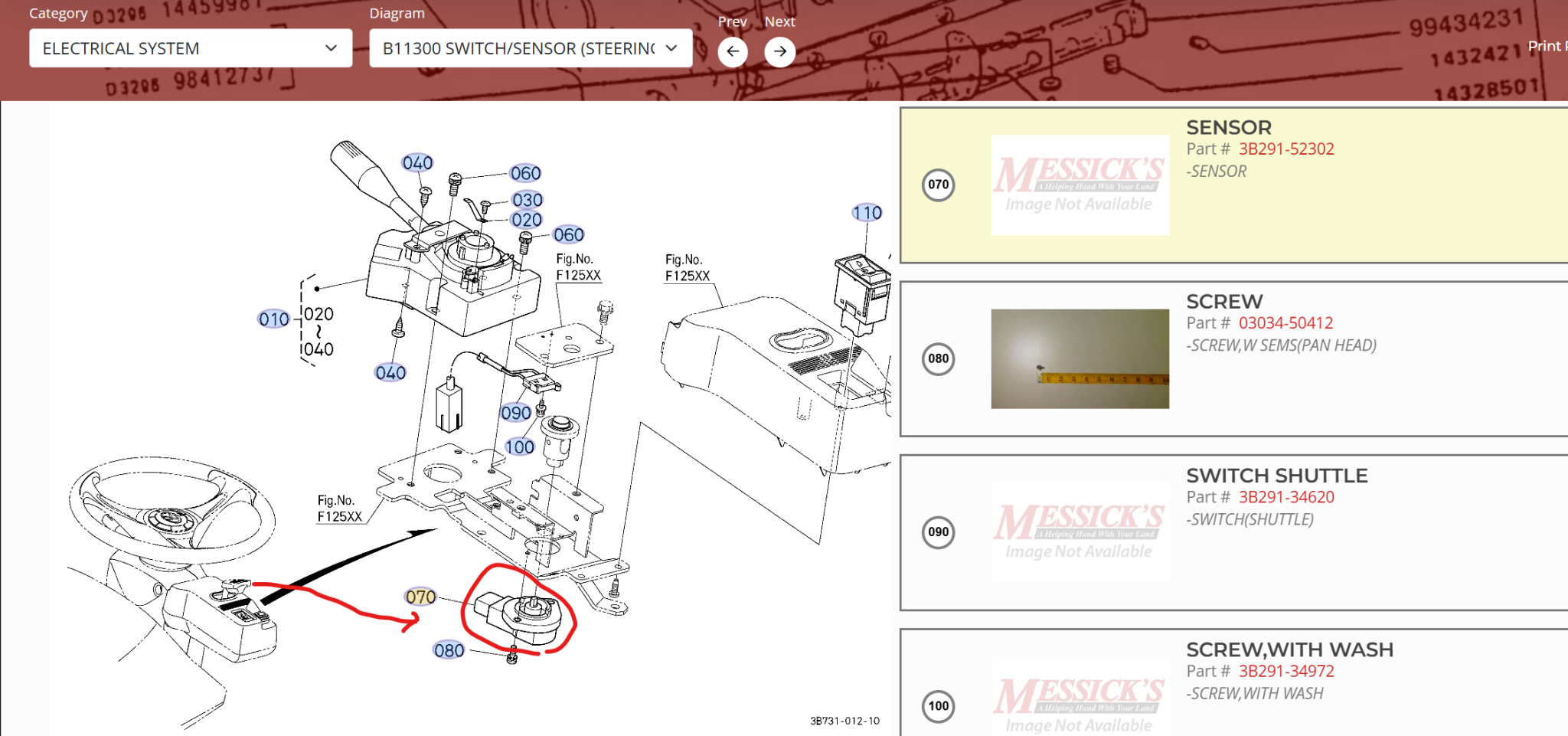

Since it does move smoothly sometimes, I suspected something electronic. I replaced the shuttle sensor located under the shuttle lever (shuttle_sensor.png screenshot) but it did not fix the problem.

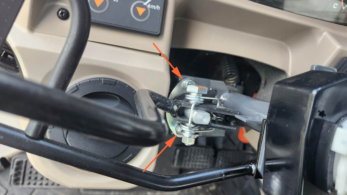

This might be utterly irrelevant, but a few months ago the shuttle shift lever in my M6060 felt odd. I wasn't experiencing any issues related to getting into F/N/R, but I removed the plastic cover from the steering column and noticed that the two bolts (see orange arrows) were loose. I removed them, applied blue Loctite and reinstalled them.
It can be tempting to jump into the deep end of a problem only to find that the solution is at the shallow end. Since this is shuttle related, it might be worth checking that the shuttle lever is working as it should. I would expect the M4 to have a similar system to the M6060/M7060.

@McMXi thanks for the comment! That was actually my first thought - start with the shuttle shift lever and work from there. My M4-071 has a sensor there instead of linkage though - and so I replaced that sensor first (screenshot here with the sensor circled) but it is acting exactly the same way afterwards:
