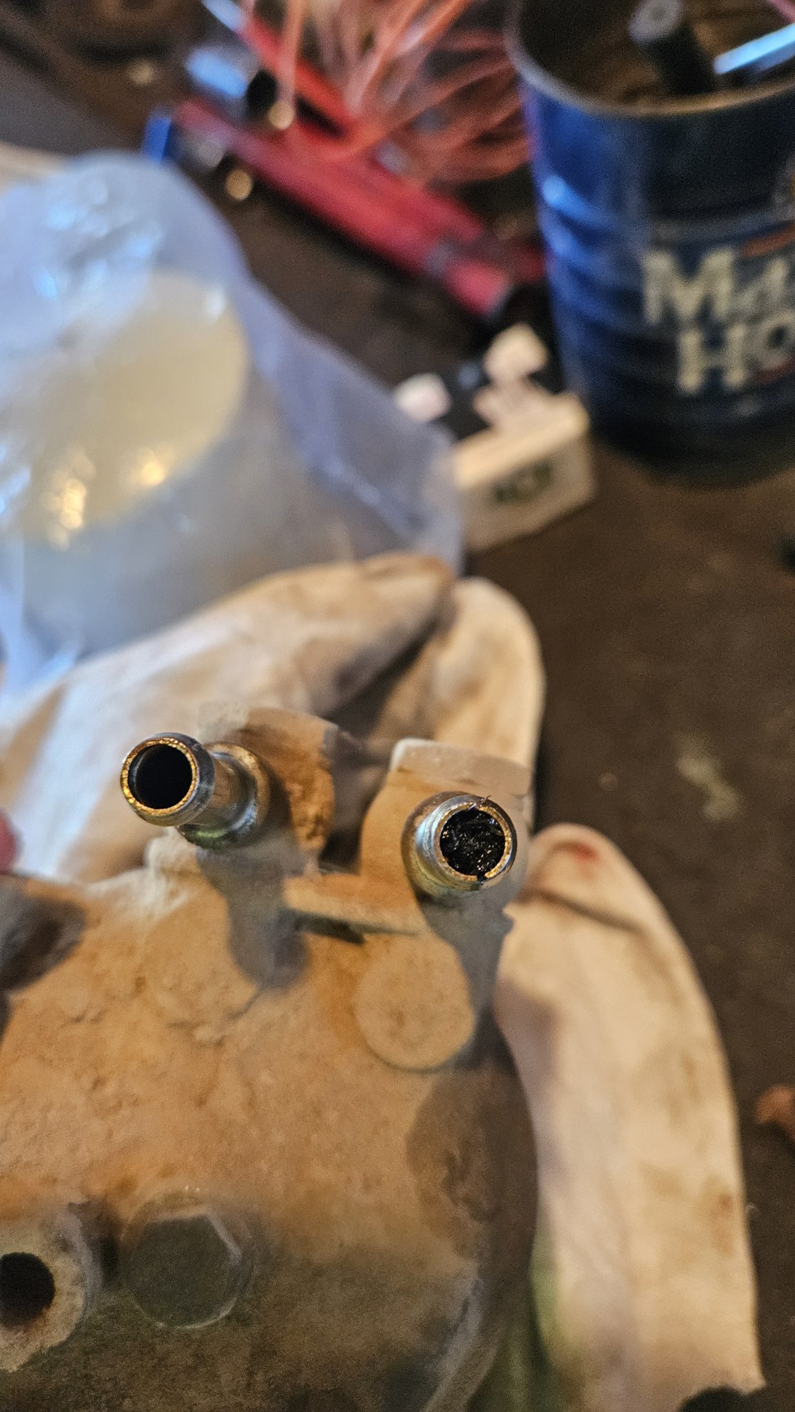

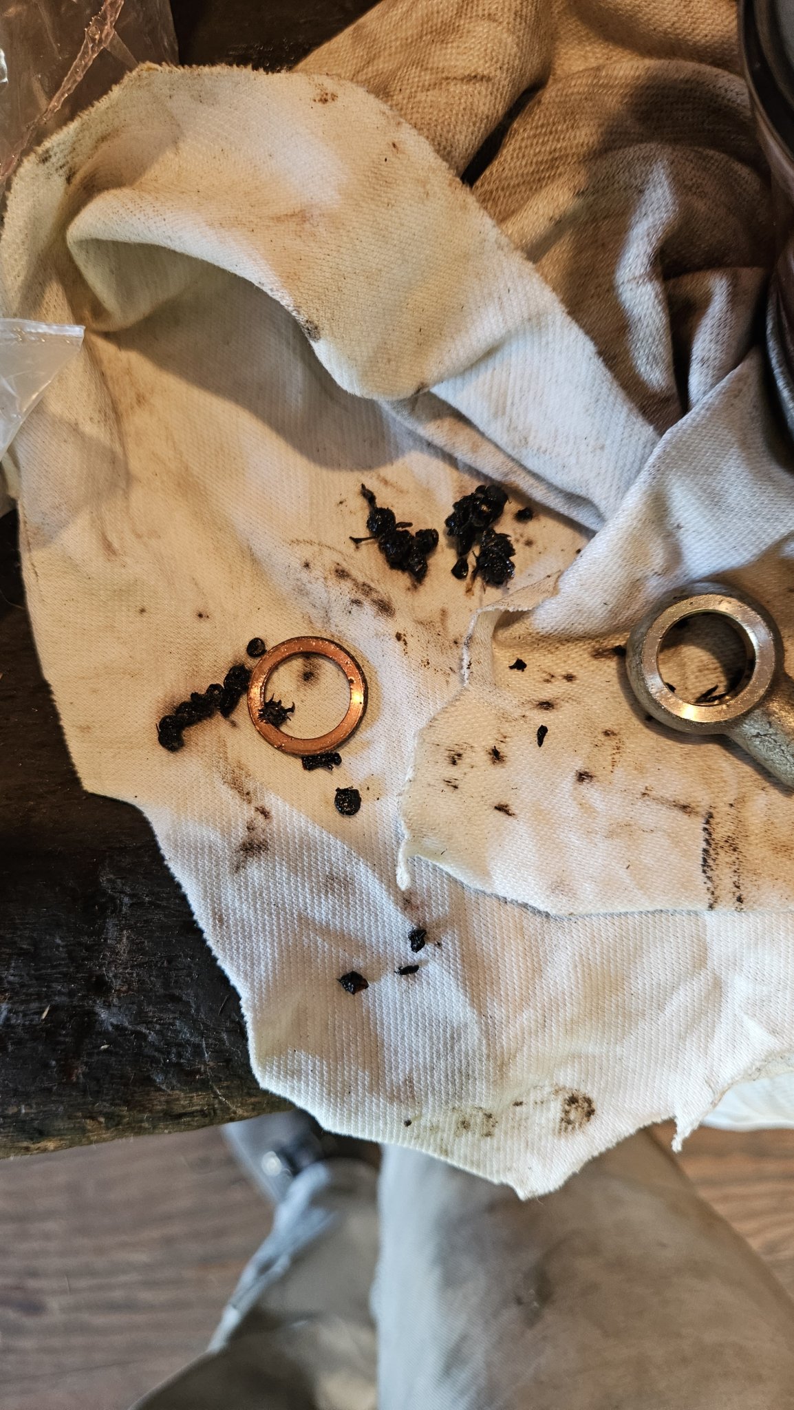

Finally got a break here with no rain and some time to dig into it. Pulled the fuel separator off the tractor...and there was the problem. Tank side of the separator was completely blocked off with hornet carcasses. Cleaned it out, took off the motor side, blew everything out, removed the feed hose from the tank, blew that out, and pulled the hose off the hand primer and let it drain looking for debris but it was clear.
200 hand pumps on the primer later,2 cycles of starting the tractor at full throttle and backed it to half and man what a difference. Like a new machine. Anyone in the future reading this, pull your separator first!
