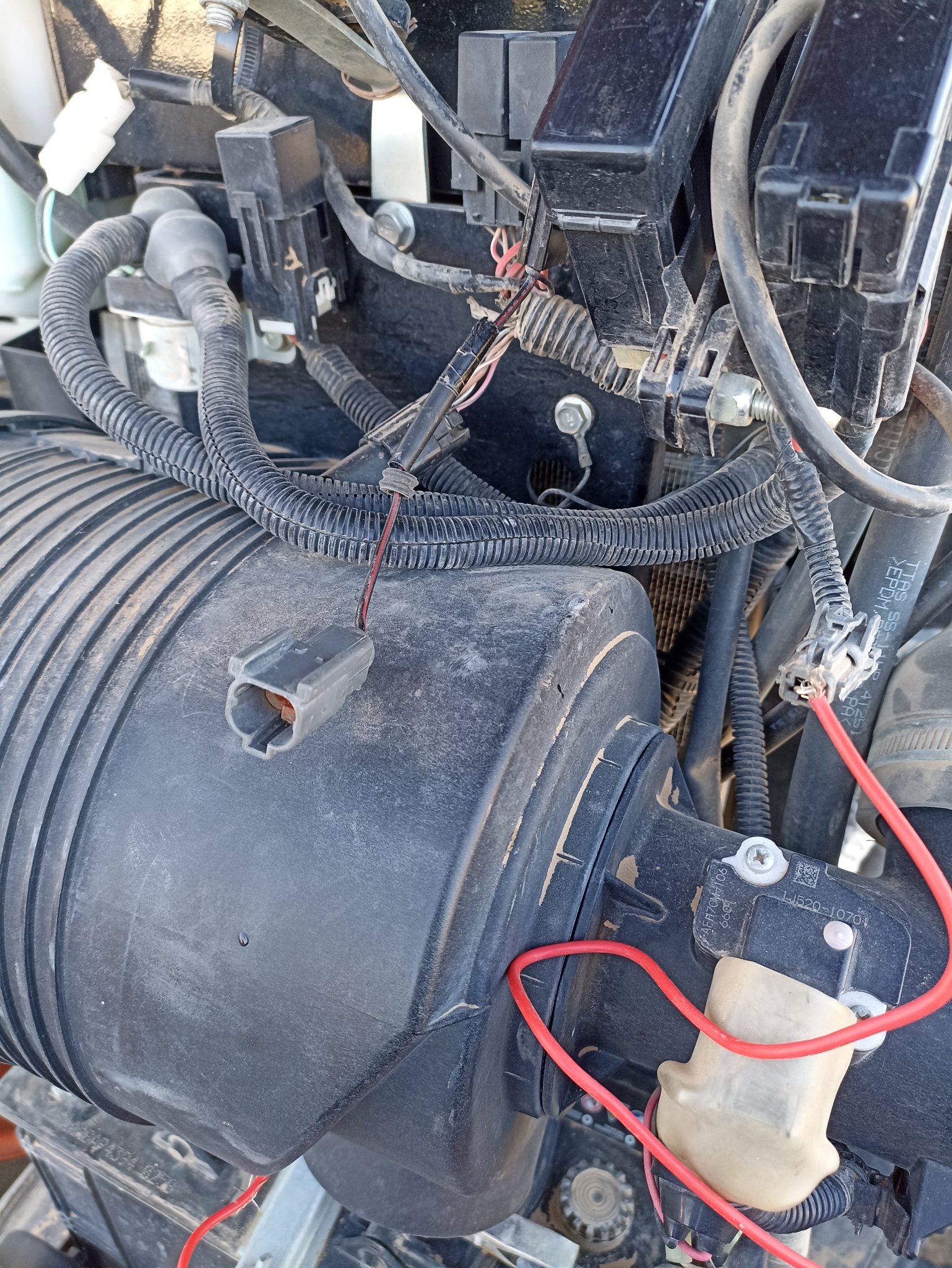

The problem is solved, the problem is caused by the socket in the photo. Sometimes there is a lack of contact in the socket and it gives a short circuit error because it draws too much current when the engine is cold.
