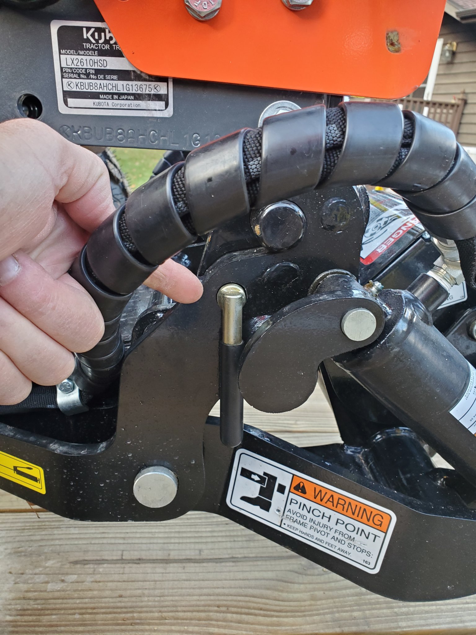

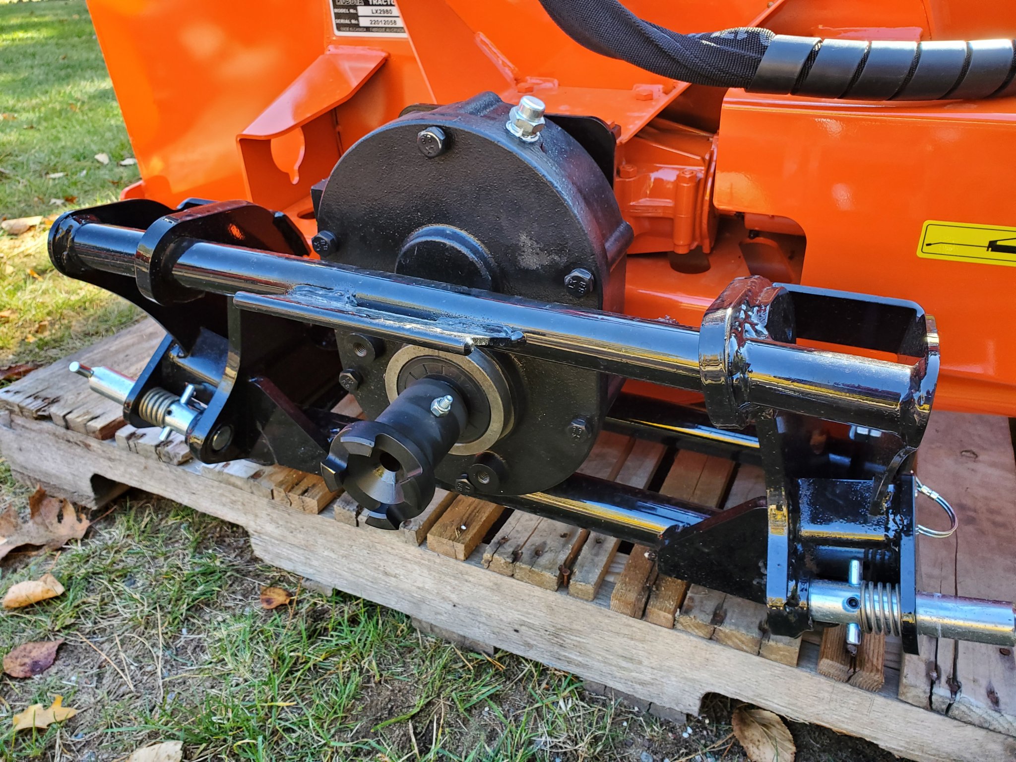

Where I'm pointing, is where the 2nd rod is installed when attaching the sub-frame. The large round post about 2" up and right of where I'm pointing, is where you hang the subframe prior to the any pin insertion. It's relatively easy to lift, just slide back and hang it on those posts.

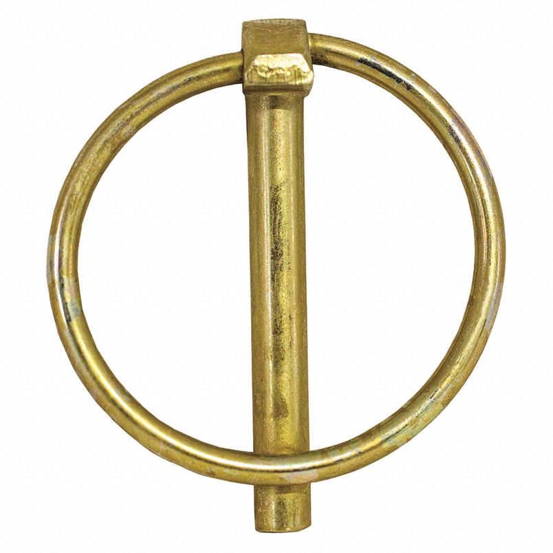

Both rods are held in with a spring pin.

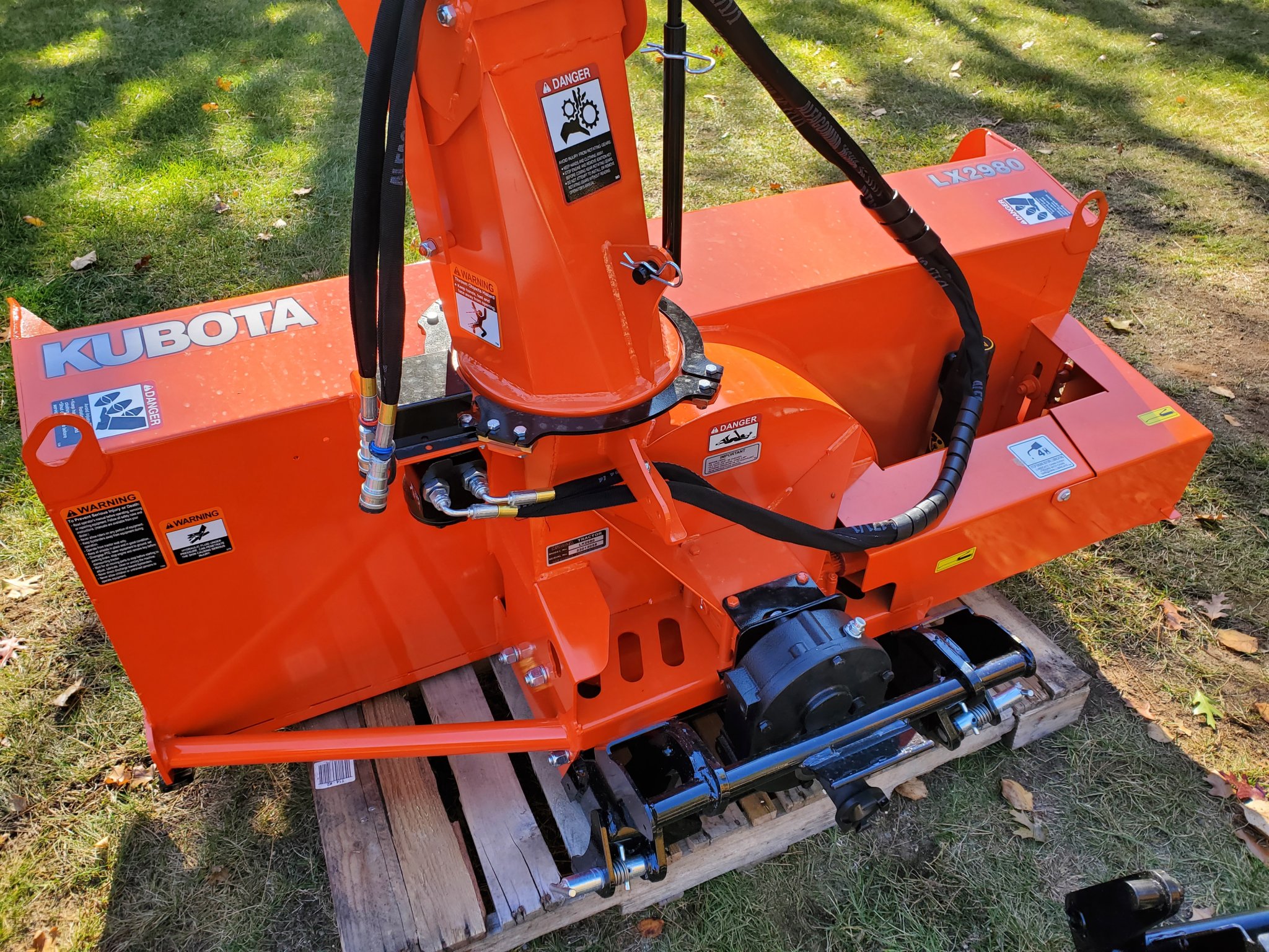

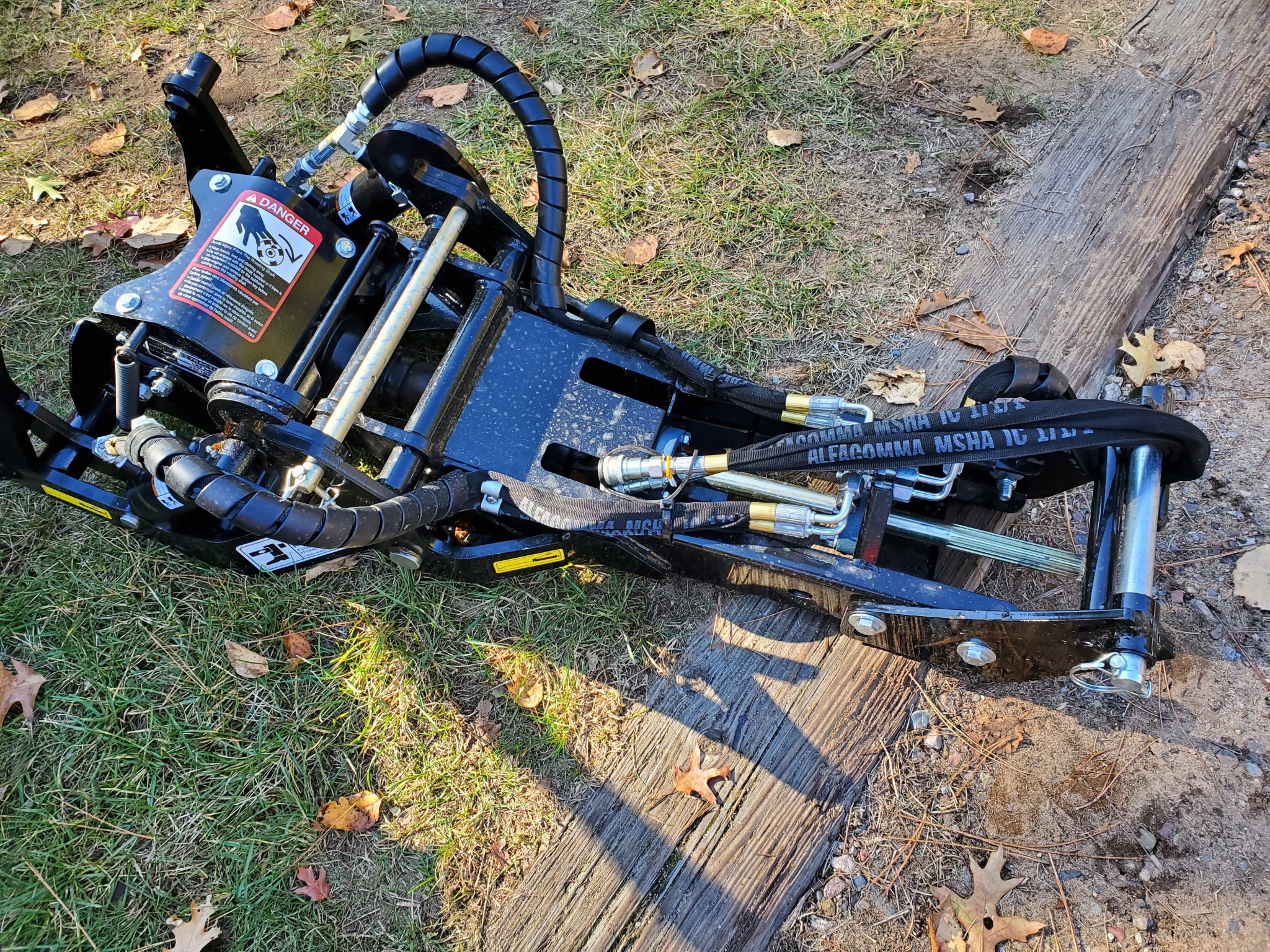

This is the 1st rod installed when hanging the sub-frame. The sub-frame is very well balanced and easily pivoted into position to slide the 1st rod in. I lifted it with a few fingers. Once this rod is in, the front (2nd) rod slides in without effort.
This is the ring all 4 hoses need to be routed through. This ring keeps hoses away from places where they could be pinched. It was easy to route the 2 hoses through it that control up/down of the sub-frrame.
The 2 hoses for the chute rotation will also route through this loop once the blower is mounted. That's where that loop gets a little tight, but 4 hoses do fit. 20201016_170550[1].jpg

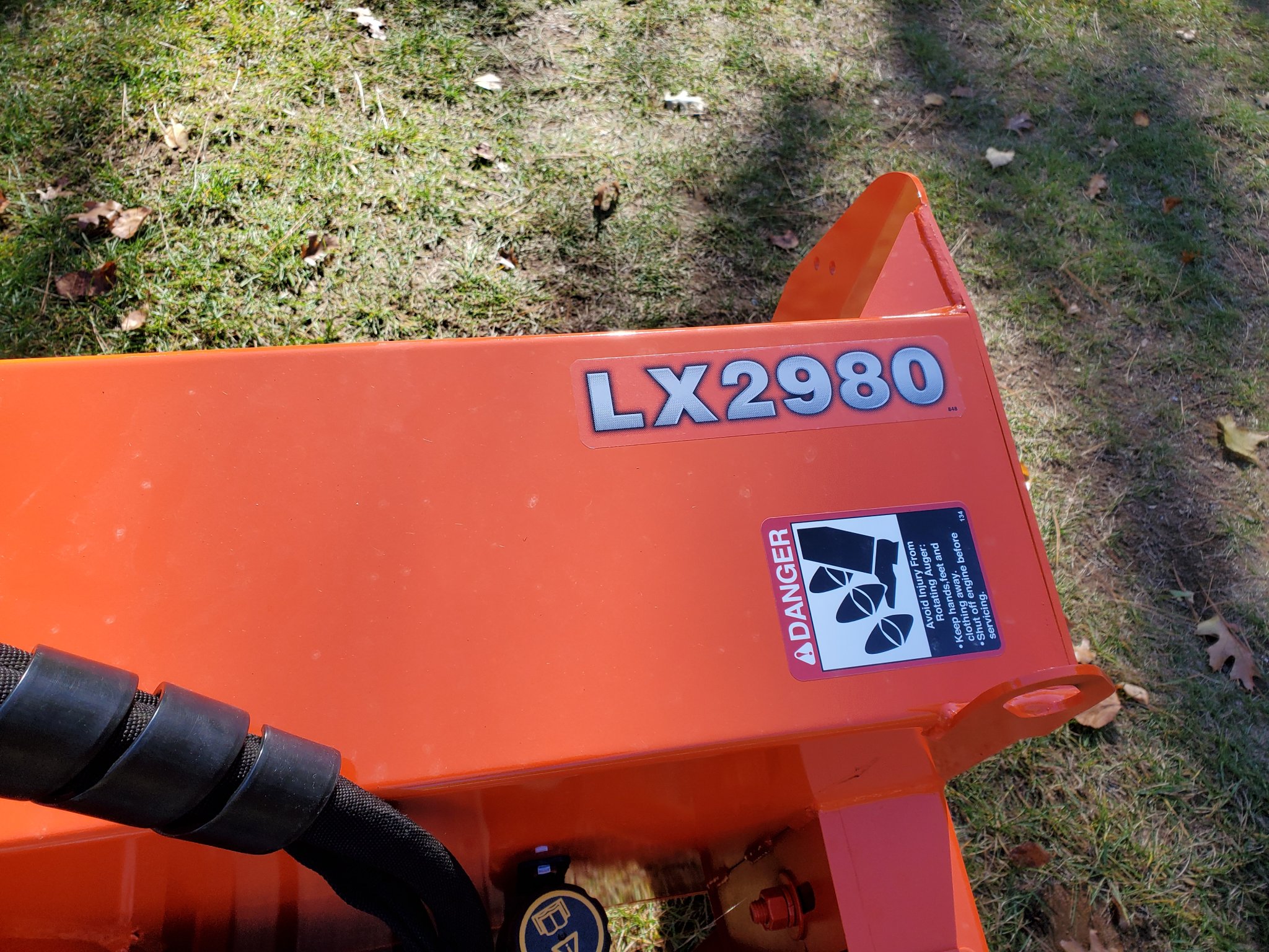

Thanks Gallows! I have several videos after this one on the channel, including the final install and a few blowing some heavy wet snow. I found out my "K64-22" blower is in fact the LX2980 model referenced in the USA. Mine was made here in Canada but to the same specs. Happy New Year to all!

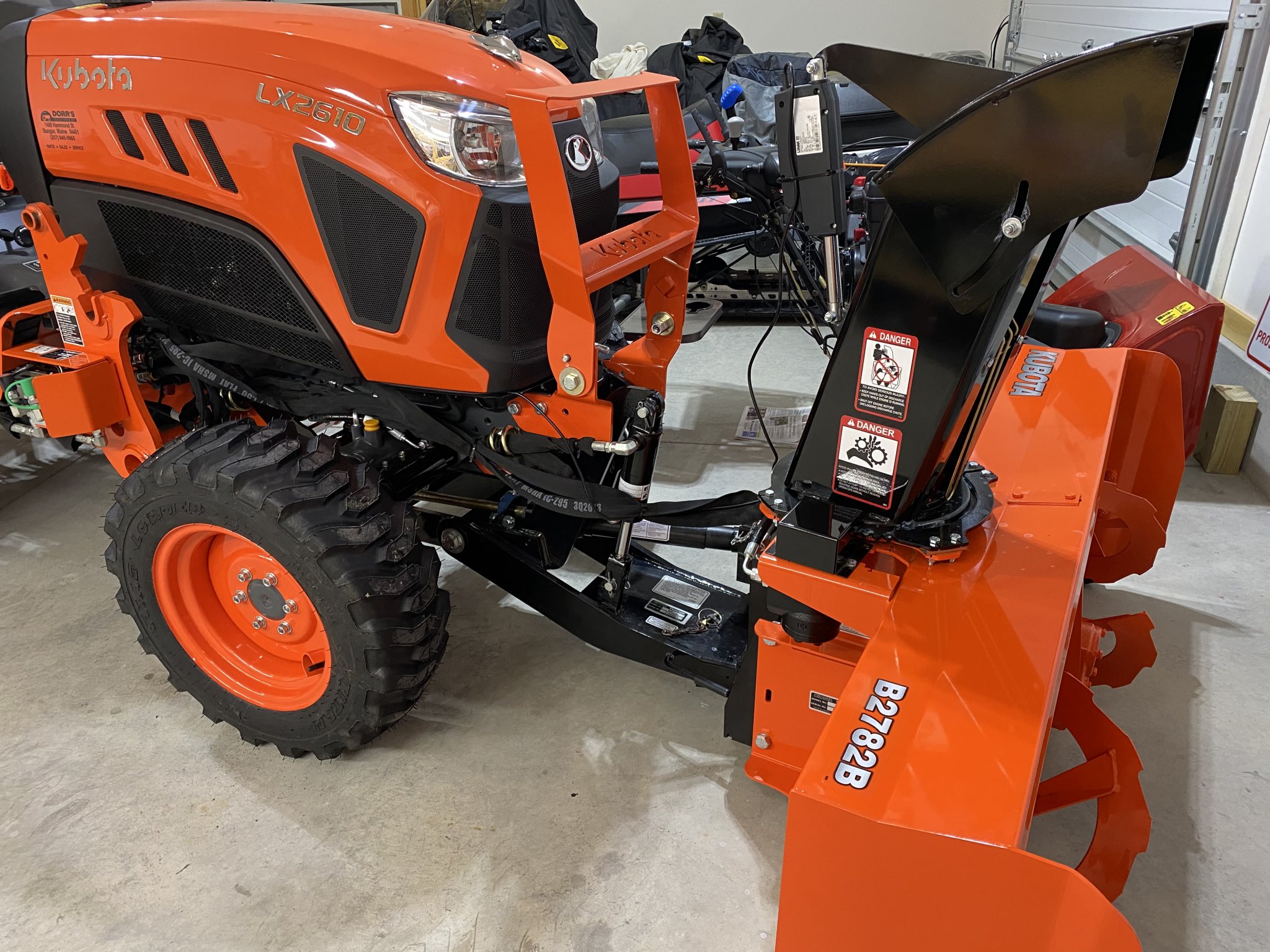

My LX2610 was ordered in June and delivered this past October. I wanted the LX2980 but was told it would not be available till 2021. The solution I was offered was the B2782B that is the residential version. The differences i see includes the older B2650 frame mount that works find on the LX. Chain drive vs gear and no horizontal supporting arm in the back of the blower. The chute comes with a hydraulic rotator but i had to add the electric actuator for the chute up/down motion. We had a 14” snow a couple of weeks ago and the B2782b moves snow on a gravel drive effortlessly. I did upgrade to the larger tires from the SU tractor version and attaching the blower mount assembly is a little more effort as the tractor sits a couple inches higher than stock. Otherwise very straightward blower installation. Just remember the correct hydraulic hose connections.
