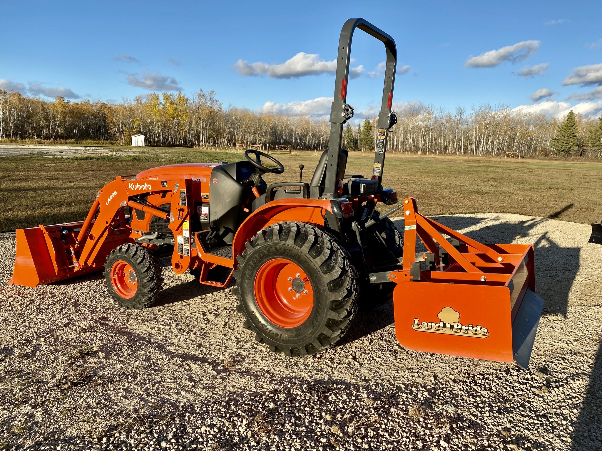

802Driver
LX2610SU 60" Bucket Land Pride54" Box Blade Farm King 4572 Rear Blade
May 18, 2020
122
91
Manitoba, Canada
I investigated this issue thoroughly before buying my B3350.
The larger tires (R4s or R14Ts) look impressive but have several disadvantages, especially for the 2650/2610.
As previously mentioned, the optional oversized tires preclude the use of a MMM, which is not compatible with the SU model anyway. Tire chains are also precluded due to spacing issues with the fenders.
Steering stops are also required increasing turning radius.
Finally, and most important for 2650/2610 models, the oversized tires increase travel speed requiring more HP. Of course, if the tires are loaded, the loaded, oversized tires add even more weight requiring even more HP.
I bought a ROPS model which is available with the optional, oversized tires but found the disadvantages far outweighed the advantages even ignoring cost.
SDT
I know most are "pro" big tires, but I have to agree here, we aren't talking a 60 or 70 horsepower tractor, the larger tires would be like going from 4:11 to 3:55 gears in a car, ( extreme example). I have the smaller tires with my 2610SU and don't see any drawbacks. Just sayin'.
