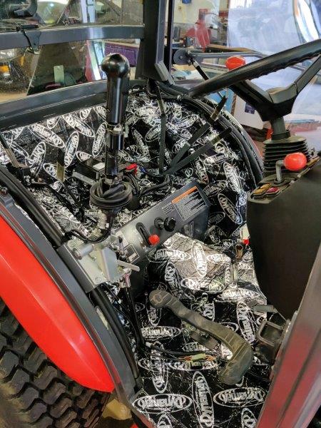

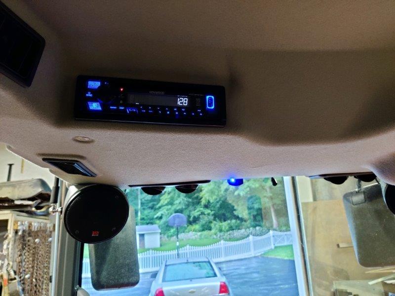

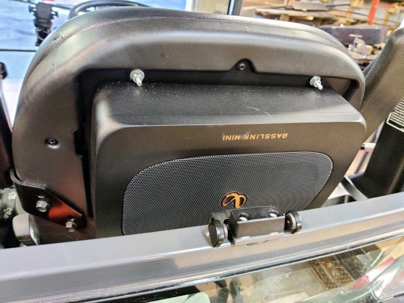

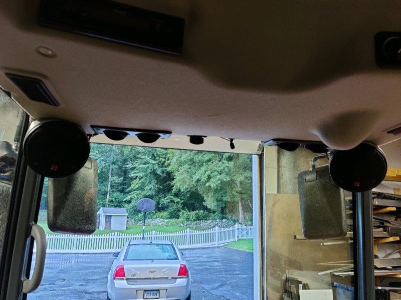

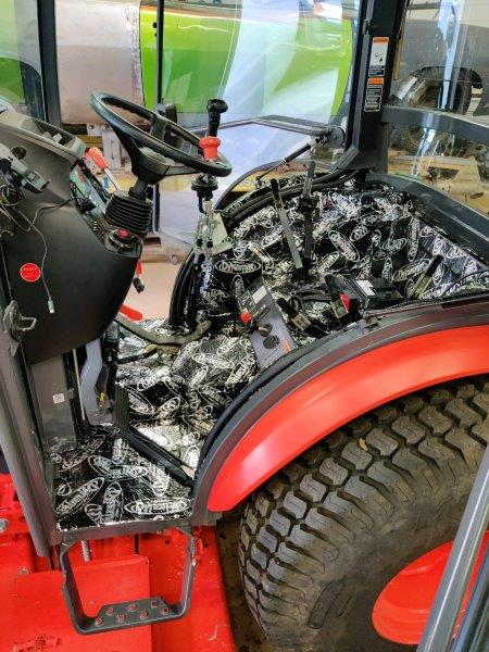

So all i was only able to find was battery power. in the left rear of the cab. seems to work ok since the sub woofer i added requires a connection to the audio receiver and won't turn on unless the the receiver is on.
This was the project
Removed the interior, and dynamatted the inside of the cab, also added a new audio receiver , front speakers , sub woofer and new rear speakers
