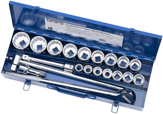

Harbor Freight has a set that looks amazingly similar! I recommend a 3/4" set if you're going to be doing tractor/implement repairs.
For some dumb reason I bought the 1" drive set. It starts at 1-5/8" so now I'm buying smaller sockets and adapters.
