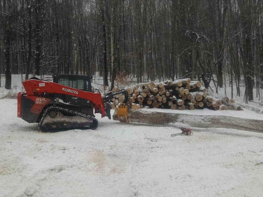

I am having a similar problem as described in this post with my SVL 95-2 CTL. The fuel was treated but I let the fuel get low. Filled the tank in the am with winter grade diesel plus white jug diesel 911. Strated fine but the quit. Typically I can see if the fuel is gelled in the water separator and it looked fine. Started again and ten minutes later it quit. Put the red jug of diesel 911 in water separator plus some in the tank. Started ran and under load it either powered down or quit. Next I tried red jug in fuel filter. Let it run for an hour, and even went through a Regen cycle, put it under load and it wait again. Could this possibly be gelling still? It was all liquid in both filter and separator. Any help is appreciated.

I replaced the fuel filter and everything seems to be operating at 100%. It may be common knowledge for some, however I did not know that when fuel gels and then becomes liquid again paraffin wax separates out and can clog the filter. In my case the fuel had gelled once and partially gelled another time. I was able to get it operating with 911 treatment and a heater. Ultimately I needed to change the fuel filter after 20 hours of operation, which in hindsight I should have done immediately. Thanks for everyone's help.
