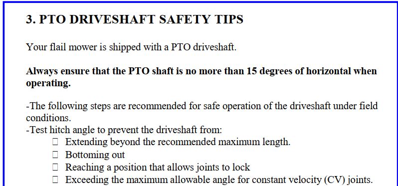

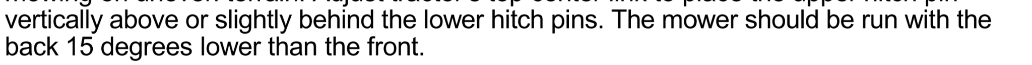

As for 15 degrees, here is the quote from the manual:
So, not sure what to make of that, but when I used it tonight I just set at level-ish.

Thanks. I flipped the black 3-pto semi-vertical brackets around (I had them in the orientation of the setup video, but the switch solved the problem.
Haha. That's interesting. Below is a screen capture from their manual that I have for my mower: Anyway, I'm sure you'll be fine as long as you use common sense.

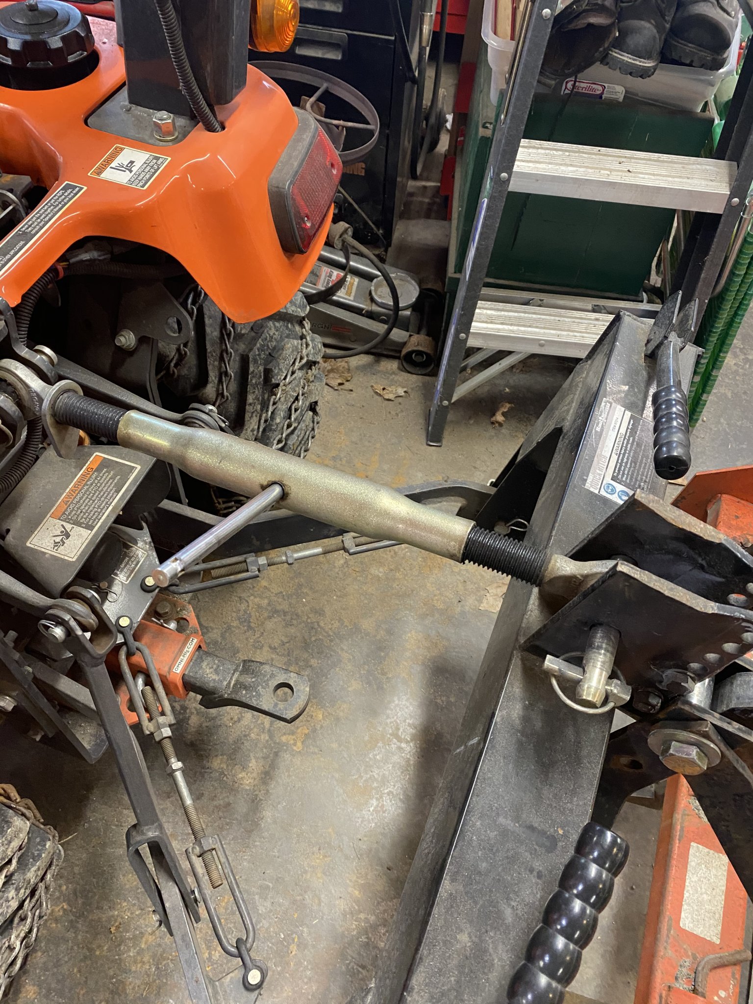

Honestly , I didn't care for the OEM link, and I think it didn't adjust long/short enough for my box blade. Seemed like it was a hassle to adjust too. It's been 8 years, so just going by memory.
I bought a link at a Mahindra dealership, but it's about the same as all the chain places have - - TSC, etc. I think mine little one for a BX with an 11" barrel was $25, and it is a Cat 1 link. You'd want a longer barrel.
I like the bar through the barrel to get a hold of, and also like the more coarse threads. Adjusts quickly and easily.
On a BX, the eyes on the link are often too wide to fit in the tractor bracket. 2 minutes with a bench grinder fixes that. May not be an issue on a larger tractor.
