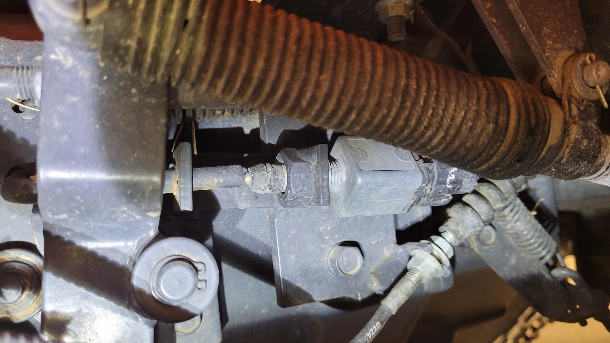

Any guidance is greatly appreciated! I looked all thru the forums collecting clues from threads on other models, but, can't seem to locate it on my MX5100. I have the "dash" pulled off around the steering column and no problem identifying the plunger switch on the clutch pedal. I assume the neutral switch looks similar. In fact, this appears to be the part I'm looking for https://www.messicks.com/parts/kubota/td060-53902 . Just can't find it anywhere.

Look under the floor board, just behind the step. It’s sorta buried up in there. You can see it and adjust/replace from the ground.

Thanks soooooo much!!! I never thought to look underneath over on the clutch side. Included a pic here in case it's helpful to someone else here in the future.

@siouxcitysmitty -- - it's a great thing you posted a photo of that switch.
Could be very helpful for someone in the future. (y)
