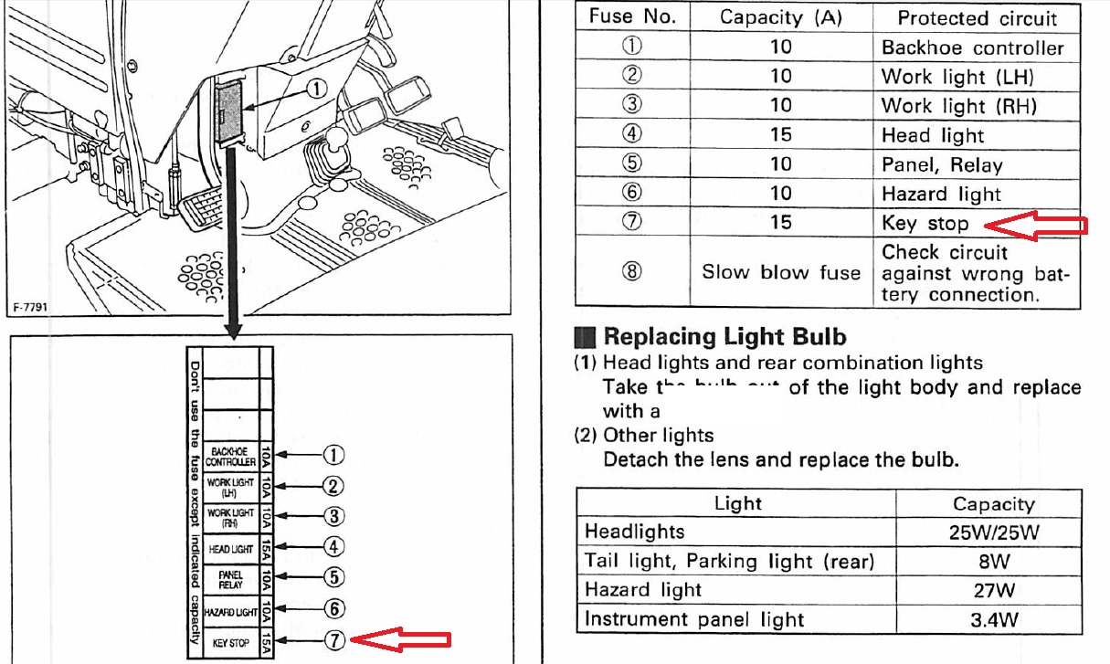

The Fuel C/O solenoid seems OK, it retracts with 12v. The wire to the solenoid shows no voltage before or after the key is switched off. There is a fuse panel, left side, below the instrument housing, with 2 15A and 6-7 10A fuses. All look good. The fuses are not identified as to function . The schematic in my repair manual doesn't show the fuse box, but just indicates a 10/15A fuse in various circuits. Does anyone know the fuse box ID's for an L-35? Maybe there was once a label on the fuse box.

Here is the page from the Owner's manual.
Swap the headlight 15 amp fuse for the key stop fuse just to double check the fuse

Thank you to Dave and wdLanning for good advice and the fuse box ID. Sorry to take so long in replying, I've been busy doing w/o the tractor on the homestead. At 81yrs, I use the L-35 for work that requires wheelbarrow, ladder, shovel, etc. Today I traced the problem to corrosion in the Fuel CO Solenoid connector. Much simpler than I anticipated. I really appreciate this forum. Just reading some relevant threads has increased my L-35 knowledge.
