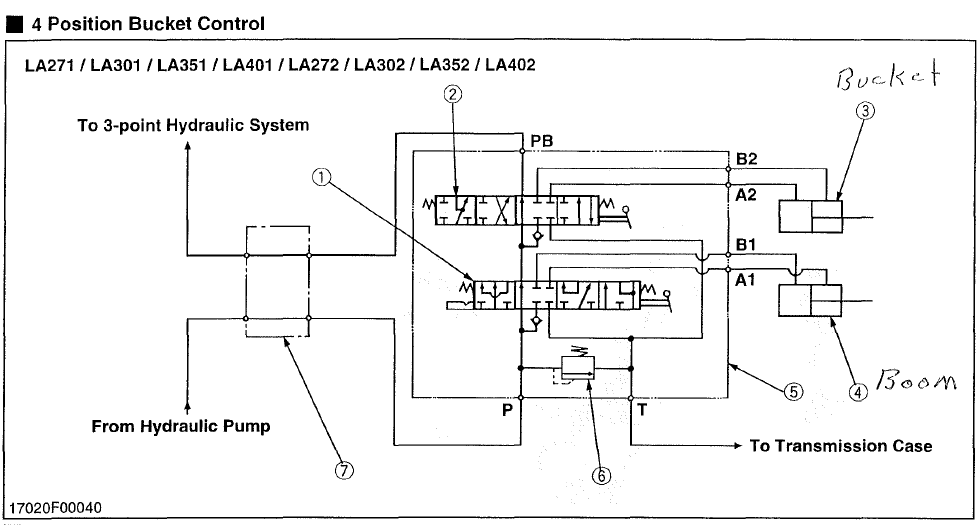

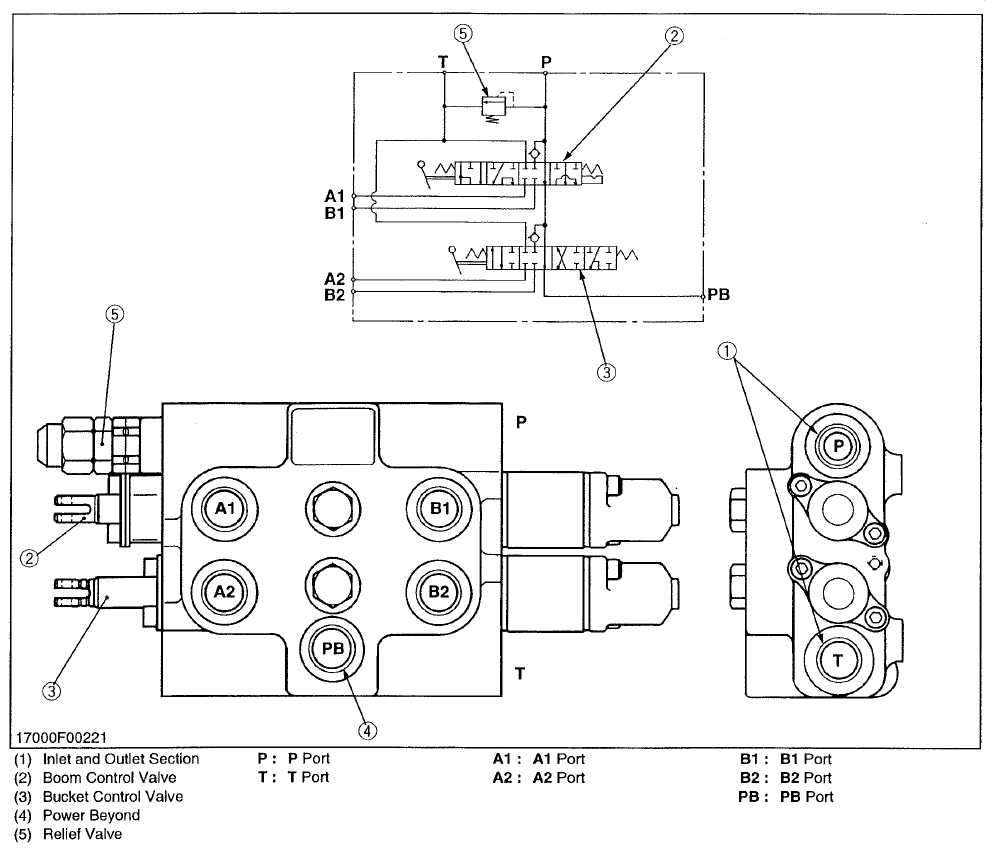

These diagrams are from the WSM, but I am at a loss.
There are 4 ports on the control, with 4 quick-disconnects to the loader (it's a quick remove type).
I did visually inspect the couplers, but didn't see anything obvious.

I am talking about the three hoses that connect the valve to the tractor. No quick connects on them. Power beyond is the port labeled PB on your WSM diagram. The hose connected to it goes to an inlet/outlet block on the tractor.
Fully lowering the 3pt control lever is a really simple check - try that first.
