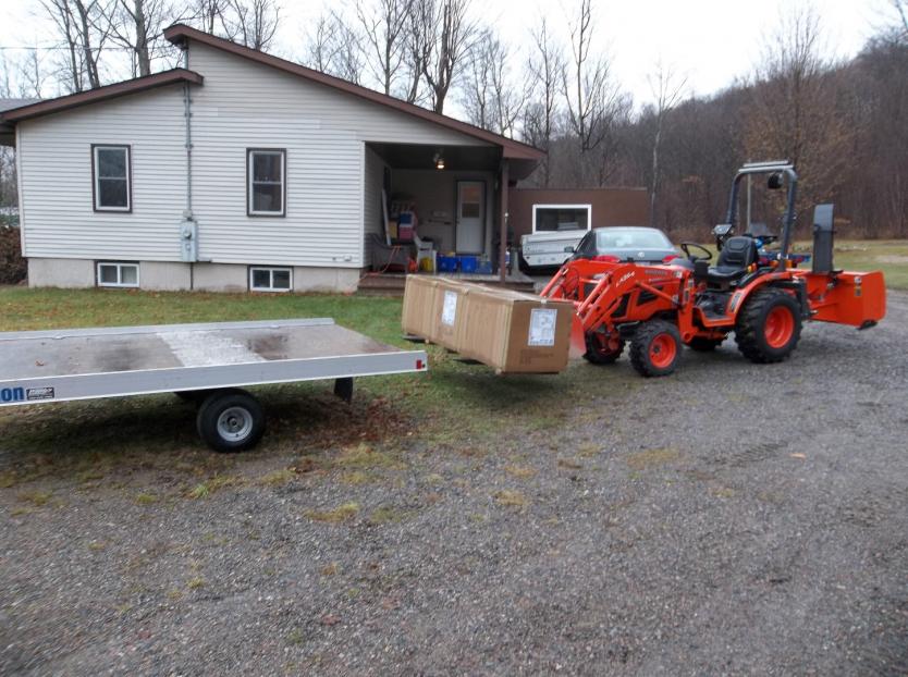

Does sound kinda weak because my B2620 lifted a crated log splitter that was 534 pounds including the shipping crate and I have clamp on forks out in front of the bucket. And I still had more capacity yet....it didn't struggle at all.
