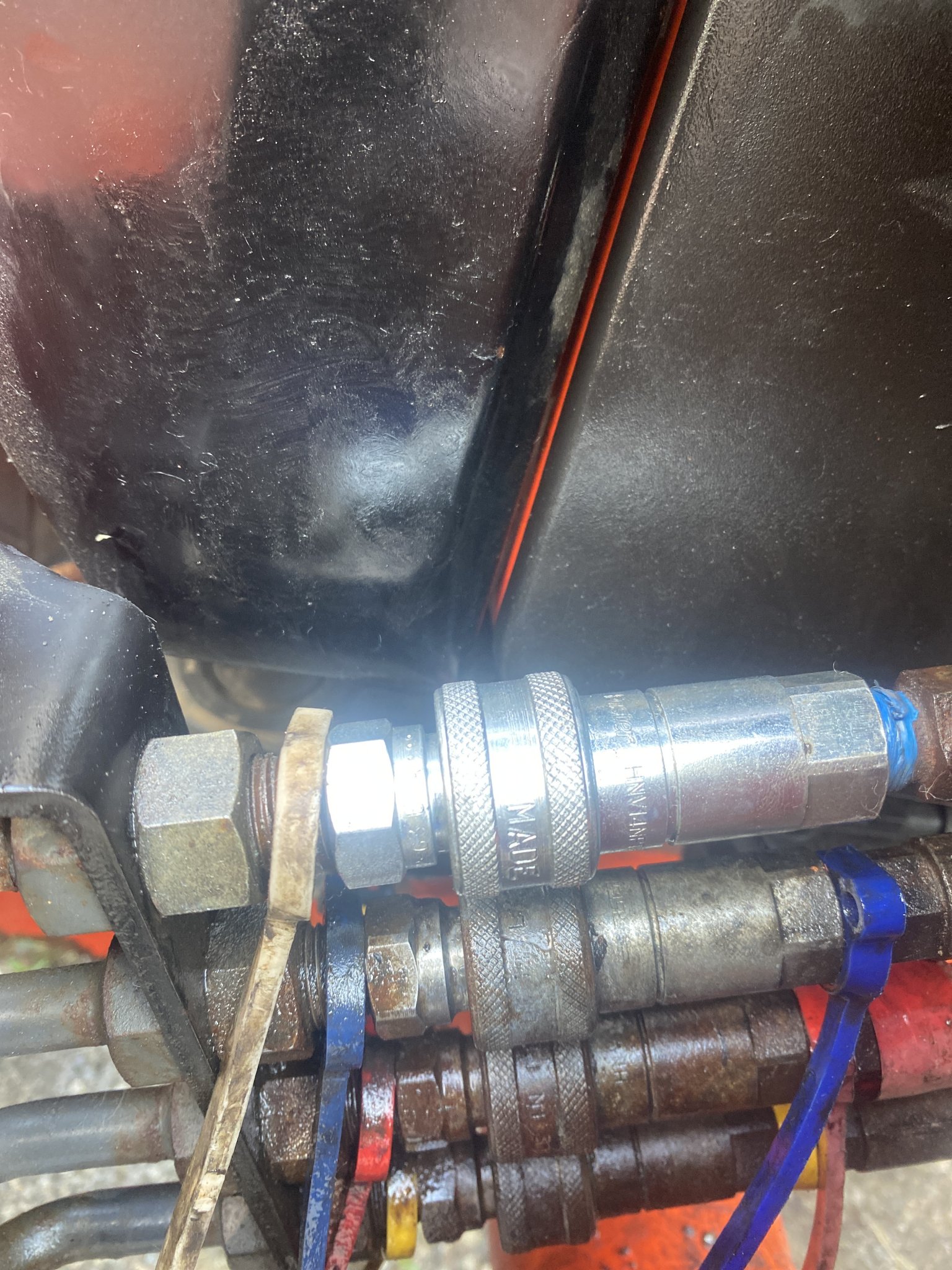

Need help please! Original owner here do all my own maintenance and a decent wrench! Loader will barely lift and 3piint is not in full Max position I am aware of that issue. Fluid is at proper level. It is intermittent after using 3 point it seems. After start up loader will raise normal for one or two times and then just barely move. Low idle if I bang the up and down frees it up but as the throttle is increased it looses lift again? I have moved hoses from roll to lift and it functions great so not the loader. It will work normal for a few days and then do this again for long periods of time. I pulled connector off of pump block and pet fluid spit to clear any blockage but it didn’t cure the issue. Something is blocking that lowest circuit on the lift block from higher pressure. You am lost thanks in advance

It does have quick connects! It is too intermittent IMOP why does it work so well at start up and idle? Acts just like when 3point is lever up all the way. Except instead of a slow raise I get no raise in lift cylinders but idle down and play with joystick and moves a again. Thank you for the advice. I will move the quick coupler to another function like bucket roll and see if that sorts it out. Everything seem weird like more pressure than normal on 3point lever?

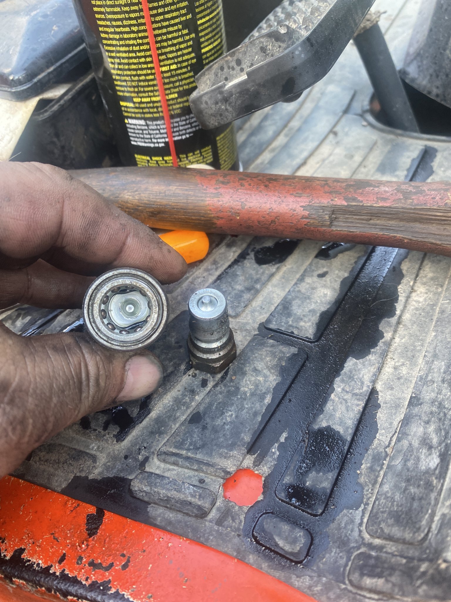

Thanks all I think I found it! White coupler line was holding pressure coming back from loader. Even though I have never taken my loader off or played with the quick couplers one went bad. With the gauge I was able to see the loader block was sending fluid properly. The pin would not release pressure in the quick coupler. Hope it’s fixed and helps someone down the line. Thank you all
