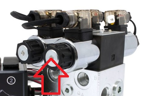

As said, you can manually operate most electric valves. In this common example, the point here can be pushed in with a small tool or nail.
If the valve is working, next is to check for power to it.
It could be power supply, shifter-switch, DIN connections to the solenoid, or the solenoid. Work from either direction to see where the issue is. See if you have voltage at the switch first, or check that you have voltage at the solenoid, then work backwards. In this example the DIN connector comes off with one Phillips screw, you can look there first to see if it is time to order a solenoid. If you have this same common valve, I can also double check polarity of the terminals for you if you want to jump the valve with 12 volts.
