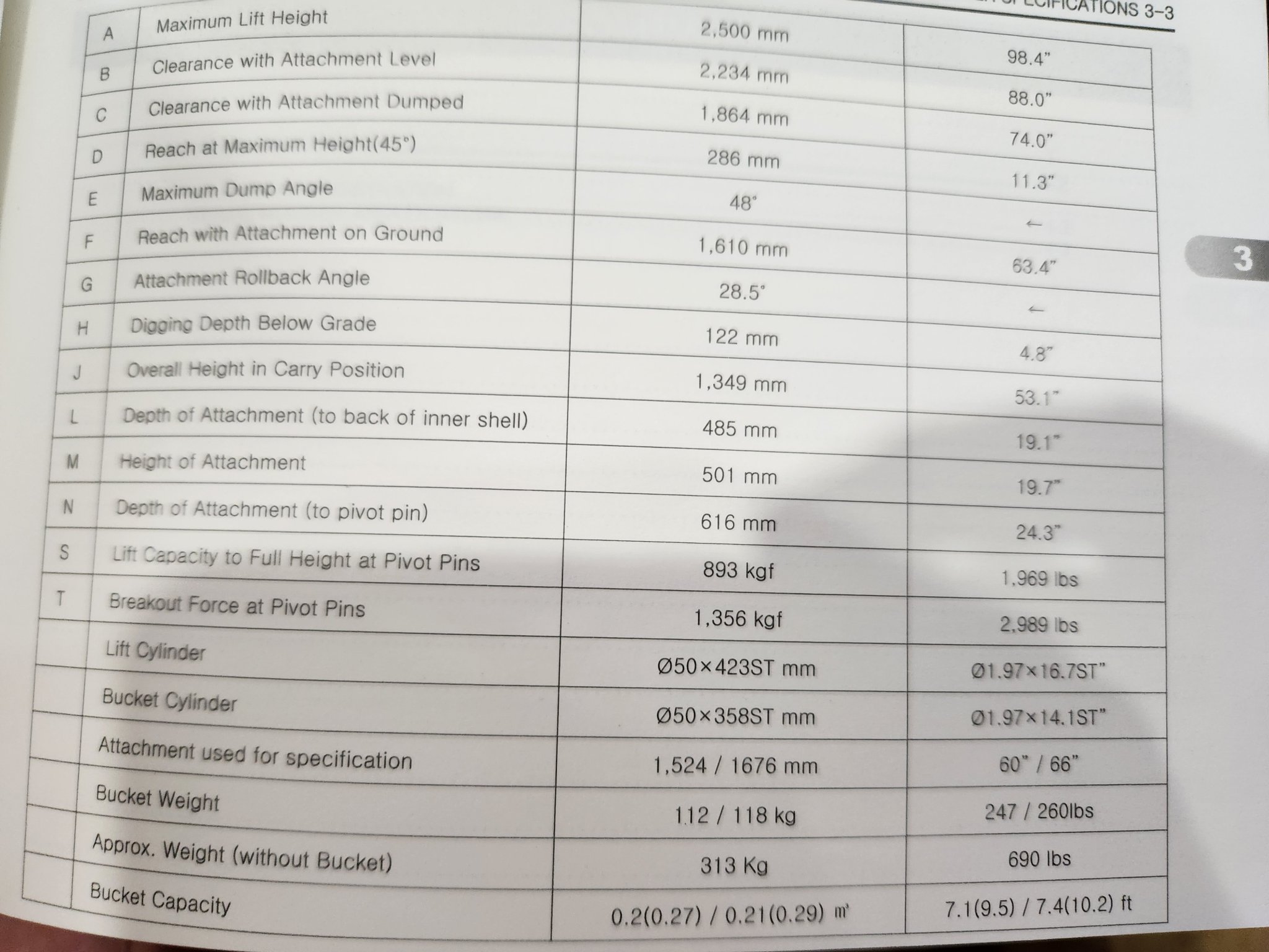

Well I've got a CK2610 with KL4030C loader, and the manual for said loader lists lift capacity at full height to be 1,969 pounds at the pivot pin. That bit at the end is key; this thing can lift a lot, but you're not about to pick up 1.9k lbs on a pallet. Frankly, I wouldn't want to either, as that's a lot of weight.
Website data has been known to be incorrect at times. Checking with the Kioti website the KL4030C has a lift capacity of 1,969 lbs pivot pins but NOT full height. This spec is at 1520 mm or just a tad under 60 inches. As the loader transitions to the full height that number will drop considerably. Even so KL4030L loader specs are impressive for being mounted on the CK2610!

Not only is the information on the site just a bit off, the CK2610 has had a few different loader options available throughout it's life. Initially it was the underwhelming KL2610, and now the KL4030/KL4030C, which share a name and similar specs but are separate loaders. The CK2610 weighs 2,634 pounds, the loader 690 lbs, and the bucket 250; that's about 3,500 pounds, plus filled front and rear tires, and I keep about 600 pounds on the back.
I've attached the specifications page from the KL4030C manual.
As for 1900 pounds being a practical lifting weight, well no, of course it's not. It's a heavy tractor, but lifting a static weight in ideal conditions is different than flopping through a field with your bucket too high, waiting for your chance to go ass over tit, lol. If I were to guess, I'd put it around 1500 that I've lifted comfortably; really, just use your brain and you'll be fine.

Thanks for posting a picture of the loader specs! I found the 1,969 lbs pivot pins but NOT full height. This spec is at 1520 mm or just a tad under 60 inches as specified from the Kioti website. kl4030c
The 1,969 lbs figure at full height at the pins is outstanding for sure.
Do you know if the breakout force listed on the Kioti website is accurate for the KL4030 and KL4030c loaders? I find it interesting that the KL4030 has roughly 475 lbs more breakout force than the the KL4030c loader while the Kl4030c has more capacity at full height.
