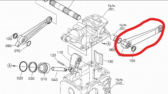

There are dots on the shaft and arms for alignment of the arms to the rock shaft. You may have to pull the snap rings off the ends to see if they are lined up. The arms on my B7510 drop down to about an inch or two off the ground and raise up to just over the halfway point of the rear tires. (Sorry going off memory, I'll try to get some pics and measurements tomorrow)

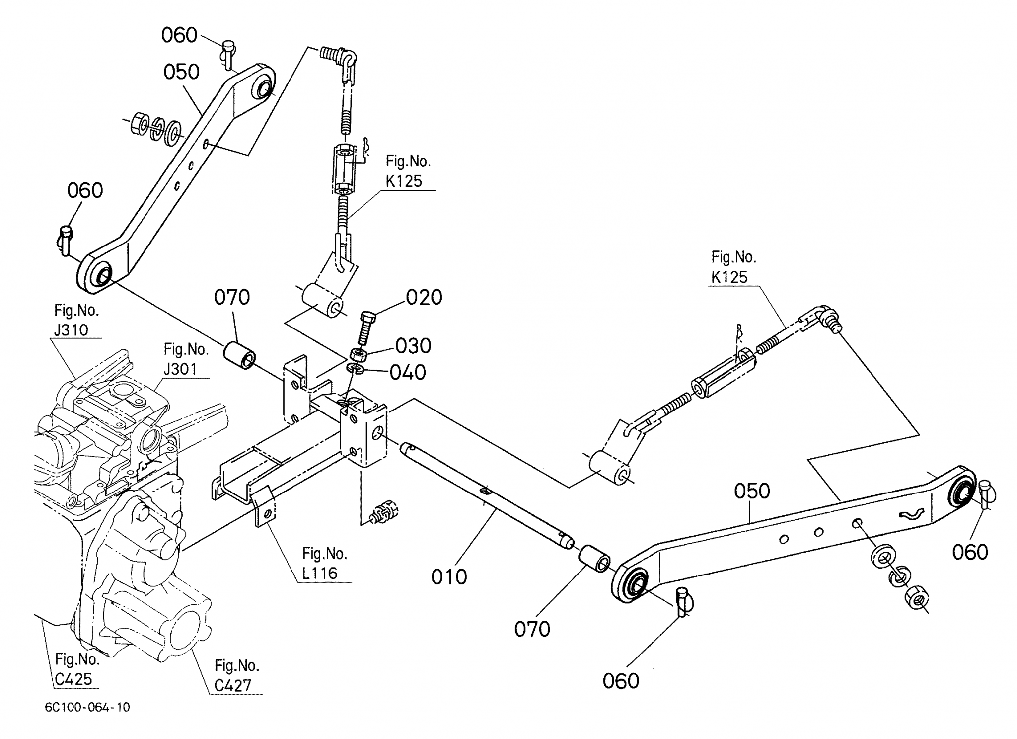

It's unlikely you'll have to remove/adjust/replace the 'lift arms' ( upper ones - in red circle ). After about a month they'd be dang near impossible to easily remove,over time it gets even harder(BTDT).
Unless the unit was repaired, no need for the arms to have ever been off.
Then again, someone in the past may have done just that, to mate with their implement better ?

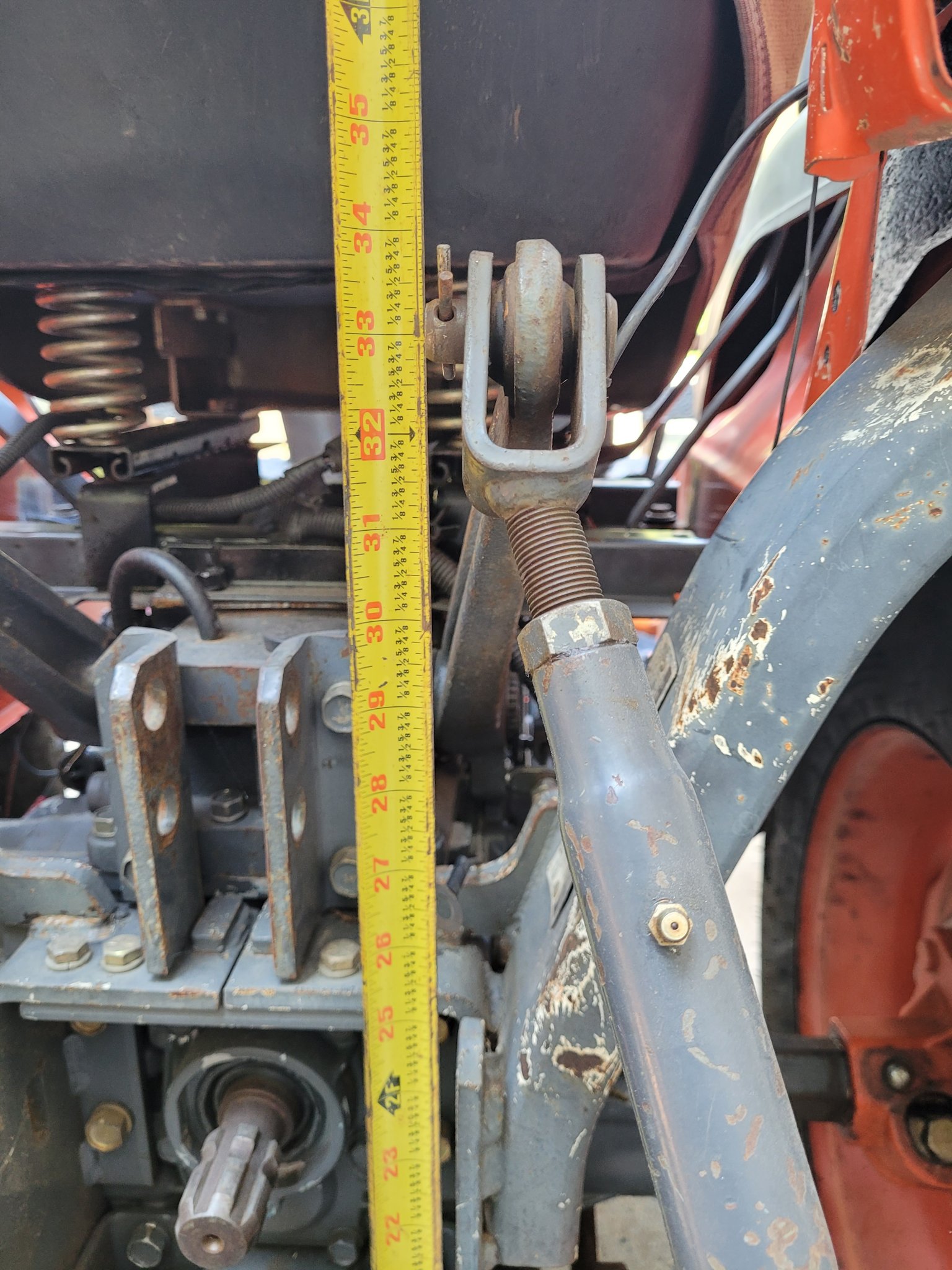

Here's a few pictures for you. Took them at the lift arms and the drag arms.
These are very helpful, thank you!! So, looks like about 7" total lift (26" to 33") for the link arms (top pieces) from the high setting to low. I'll see if I'm getting the same and report back.

I was able to measure the link arm at the ball end in the fully raised position and it's right at 33", which matches what DieselD has measured. So, I think it's probably ok. Fully raised my Bush Hog is only 9" off the ground using the lower top link hole. If I move the top link to the upper hole it's only 7" off the ground. Both seem pretty low to me, but perhaps it is what it is. Thanks everyone for the feedback and help!
