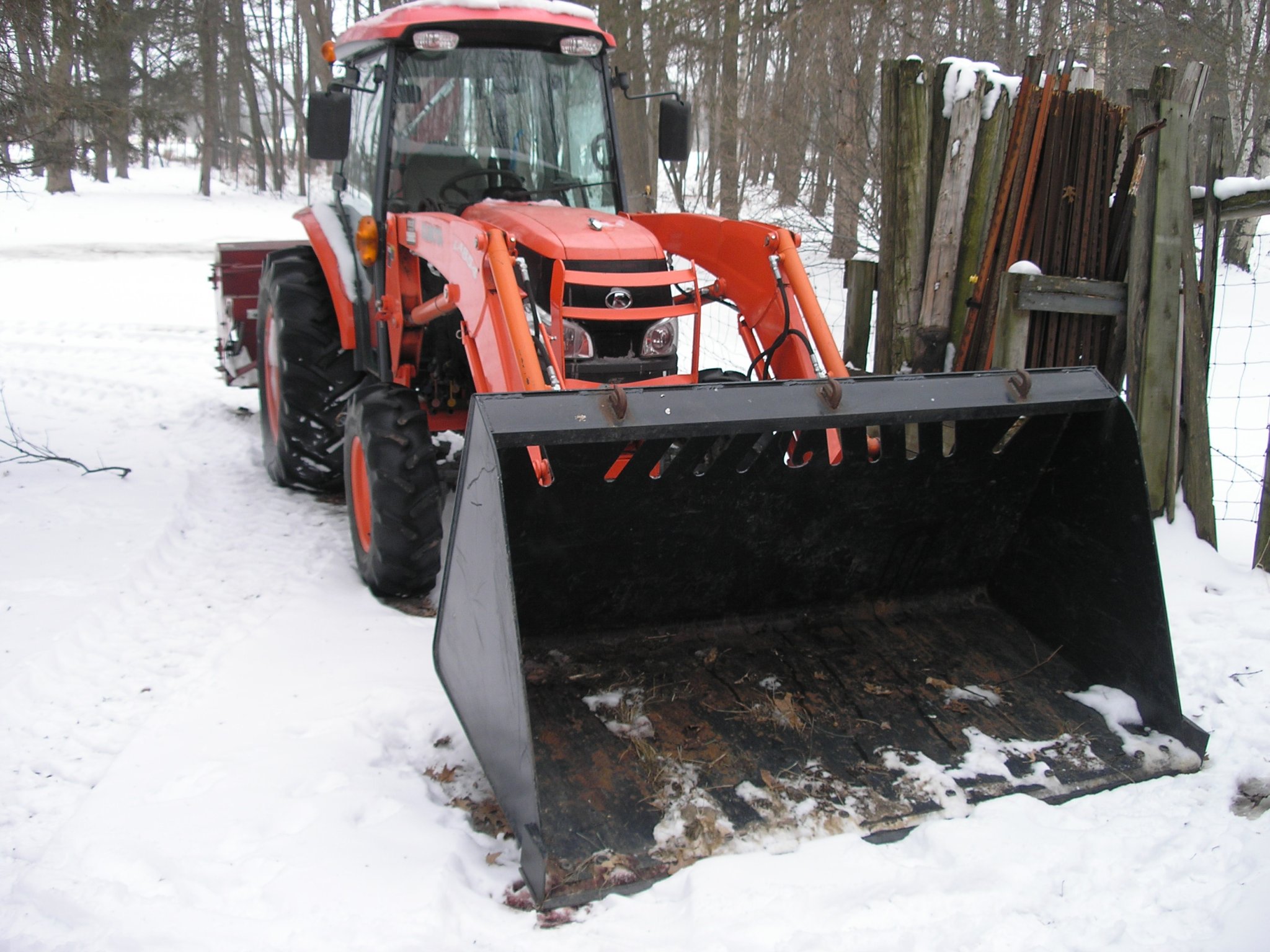

Hey now…I did weld them to the plate!
I had welded them on the original bucket which was before I installed the quick attach plate. I found that in certain odd applications I may want to switch around the D rings so I did the bolt on plates for this one.

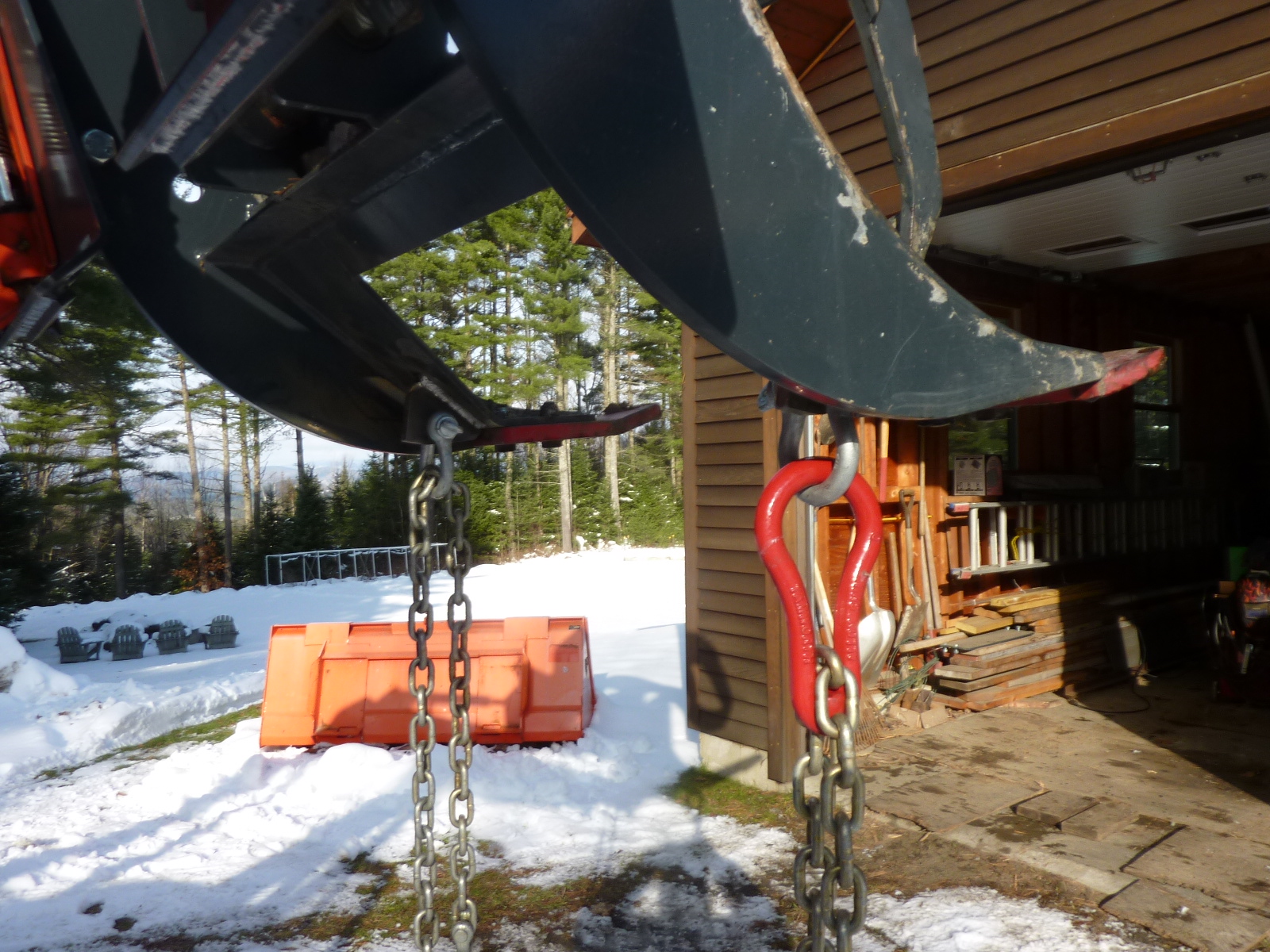

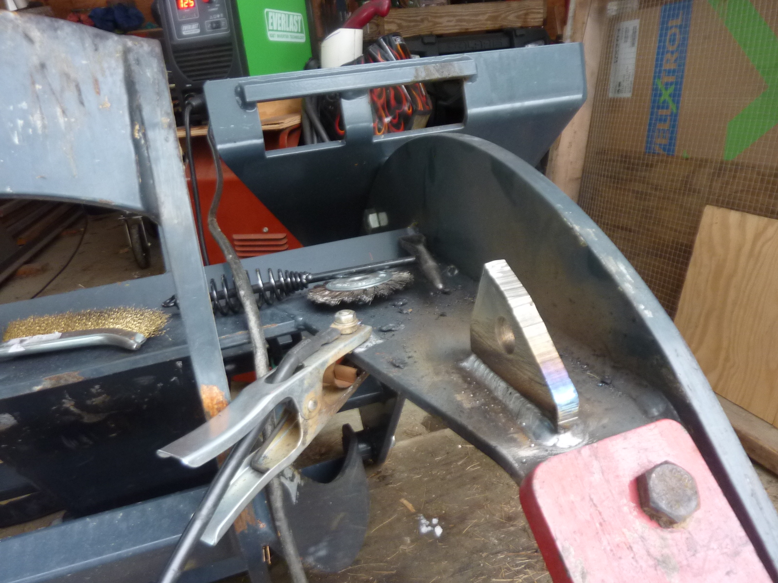

I put some shackle lugs on my FrostBite Grapple.
I can hook stuff in a variety of ways
I found most of the time I just wanted a grab hook and didn't like the complication of the shackle just for a grab connection so I added a grab hook too

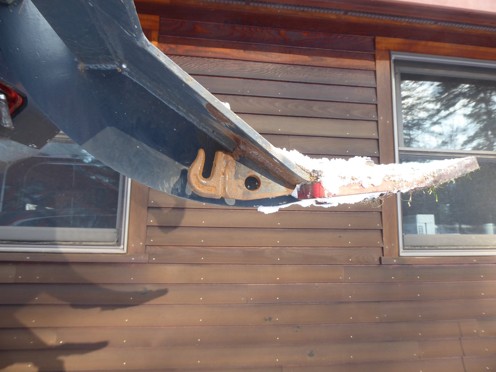

I bought a used M5640 that had a middle bucket hook. Added A set of hooks and a lug in line with the Loader Arms. First hook I put on backwards - DUH - Decided to leave it and put one on both sides with a correct facing one. I actually use the backwards hooks for hanging heavy stuff close the the lift pins.

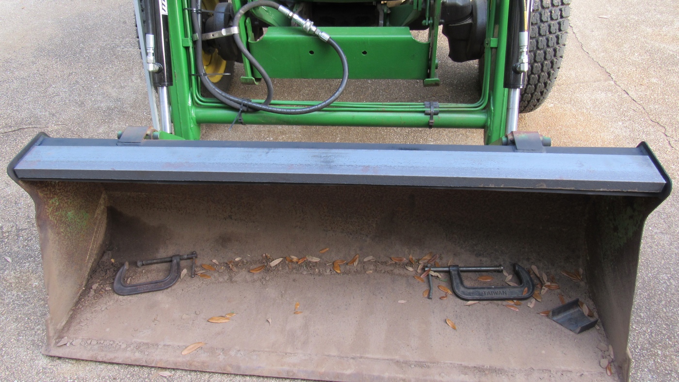

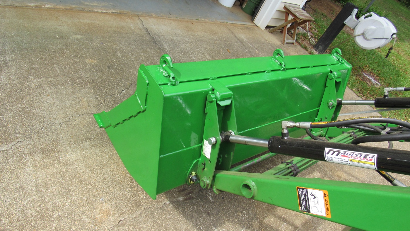

This is how I modified my light duty JD bucket. I cut one leg off of a 4x4x1/4 piece of angle with a plasma cutter leaving about 3/4" on the front side. I cut one leg off some forged HF hooks and welded those onto the top. I used the leg I cut off the angle to make pieces to reinforce the side like the HD bucket has.

I put 3 hooks on my JD and reinforced the top of the bucket. I very seldom use the center hook. I normally connect to both of the outer hooks when hoisting things. My outer hooks are outside the cylinder centers and I haven't had any trouble. I do have generic cylinders with larger than stock bore and rods though.
I have a couple of hooks ordered to weld onto my light duty Kubota bucket. I am planning to weld them directly to the bucket because I feel it will be at least as strong as the loader capacity on my tractor. I am going to align them with the cylinders but I'm not sure how that matters since the Quick Attach pads are set off center of them.
