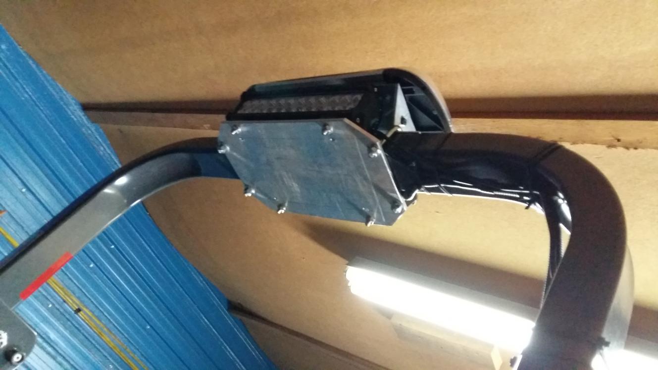

Photo 1 shows the side view of the mounting bracket with lights. I did not want to drill in to the ROPS, so with some 1/4" Aluminum Plate, some Aluminum Chemical Tray cut in half lengthwise, and U-Bolts, I was able to securely fasten everything together. The design is purposely compact, and features the Professional Grade warning Beacon and 2-12 inch LED Work Lights.

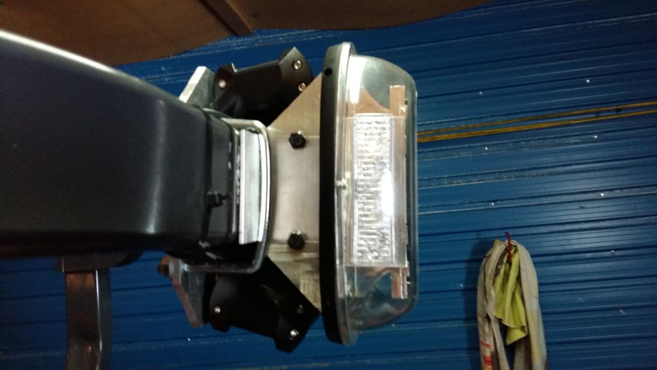

Photo 2 Shows the rear view of the set up.
