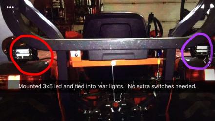

Today I finished installing new lights on my Rops. 2 facing forward and 2 back. Got the lights and waterproof switches off of Amazon.

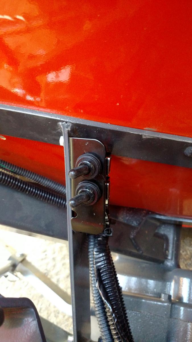

I pulled back the wiring out of the factory harness for the rear work light to the left brace for the left fender and made a bracket to mount up the switches. They are in a good spot out of the way, that switch view is looking down between the seat and left fender.
