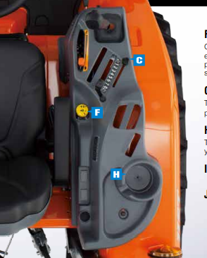

Here's a good place to ask my dumb question. I have looked but y'all can give me the answer easier. To the left of "H" there's 2 covers and the round black cover. Light switches and 12v power port with cab version? The power port would be nice to use for charging or a handheld light. Is it pre-wired or added easily?

Those two blanks above the 12v socket are for the switches if you get the quick attach remote hydraulics. On the cab models, the light switches are in the right side B pillar. Non cab models don't have auxiliary light switches, just the main switch on the dash.

I can tell you the least used slot out of all the empty ones is the one to the left of the hitch lever. It's for the draft control. The other three open slots are for the rear remotes. 3rd function is a switch attached to the joystick. The only thing not available on either the cab or OOS are USB jacks like you can get on the Green tractors. That's something I will come up with on my own.
