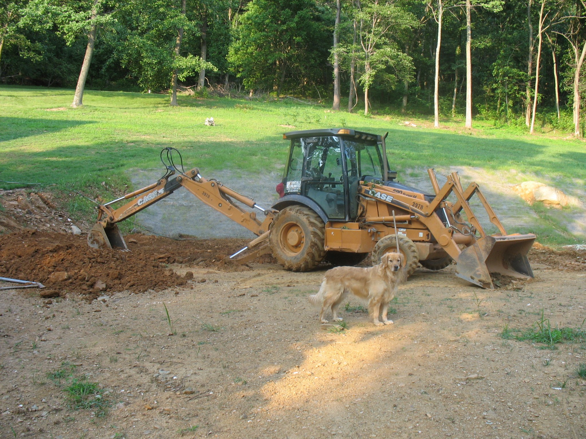

A yard of 3/4" gravel clocks in at about 2500# so I don't see a problem with weight. That loader will easily handle 2800 lb at transport height. Heaped capacity of the optional round back bucket @350# is 15 cu ft = .55 yard so that bucket and gravel combined is under a ton. If I REALLY needed to bucket large volumes I'd be considering renting a bigger machine. Around here a Case 580 with 1 yard bucket rents for $250/day and $875/week with a $50 hauling fee.. I've rented this machine more than once and it's always been a very cost effective solution for me.

kinda wondering what a 'lot of road' is ? To me 1/2 mile would be a lot of road, to a citybot 100' ! As TOH says, renting a bigger machine might make sense. Job could be done in a day, not weeks.....
