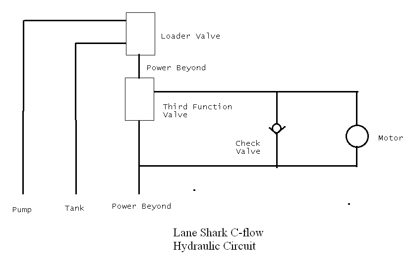

On my tractor I already have the Kubota 3rd function kit with sump drain. My understanding is, I would need to purchase and install the electrical switch assy. offered through LS for proper operation.
Did you already have 3rd function on your tractor? Is this how you are set up? Is your mx5400 HST? Does your loader operate well with the LS?
I was in touch with LS and they stated that excessive heat would only be a problem if my 3rd function did not return to sump. Something about restrictions causing heat build up.
Thanks!
12,900
7,321
Thanks!
Lane Shark seems to struggle with this issue. AFAIK none of the Kubota third functions return to sump. The 3rd function outlet goes to power beyond for downstream power to 3pt, rear remotes, backhoe, etc. If you plumb the Lane Shark return into the power beyond outlet the route to tank goes through all of those devices.
That said the Lane Shark return does not have to be plumbed into the 3rd function outlet. It can be plumbed directly to sump via the tank return on the loader valve. That minimizes return restrictions and eliminates the possibilty of deadheading the rotating mass of the mower but it comes at the cost at the cost of loosing all use of 3pt and any other downstream valves/outlets when the LS is connected AND running. When the Lane Shark motor is OFF everything behaves as usual.
You DO NOT need their switch. All you need is a way to hold the the the third function on and a simple toggle switch wired into one side of the the 3rd function circuit will do that.
