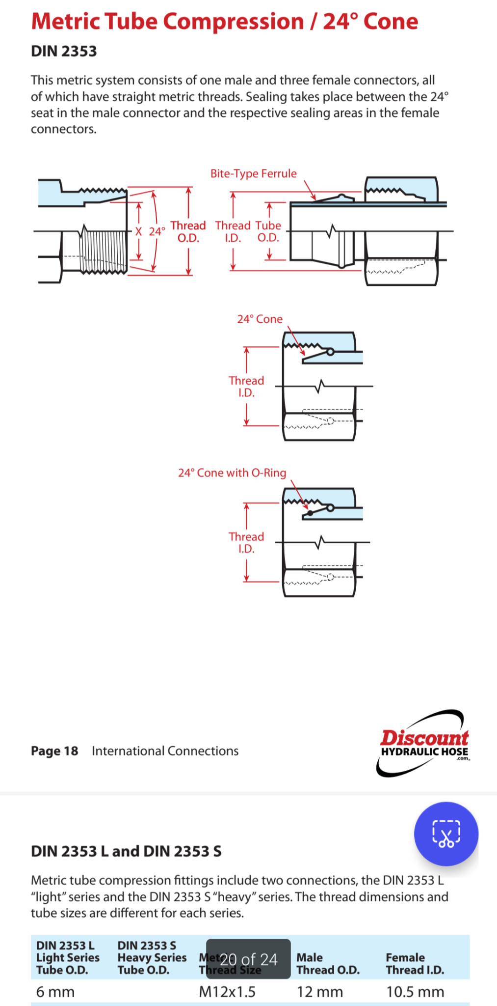

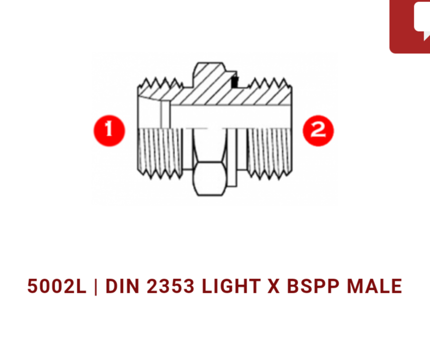

Like the ones at the bottom, with o-rings. Apparently they use the same male fittings for metric tube compression connections. So the adapters are DIN2353 X BSP.
This assumes my measurements were correct and everything fits when it arrives. 🙏 🤞

I am having trouble visualizibg this.
Male BSPP with oring is a standard port adapter. But I dont understsnd how the DIN 2353 end attaches to a hose swivel. It would normally attach to a metal tube end with tube nut and compression sleeve as shown in your second attachment.
You sure that hose swivel and the hose end of the adapter are not ordinary BSP? Thats the BSP analog to a "Mericun" NPT female hose swivel and like NPT seals against a cone base. The exact cone angle escapes me at the moment but its not 24 degrees.

Well this has been educational. I had not run across these before. Seems to match your description and the picture perfectly.
[https://www.discounthydraulichose.com/FDINHX90-06-20.html
Thanks - looks like I learned something new today.

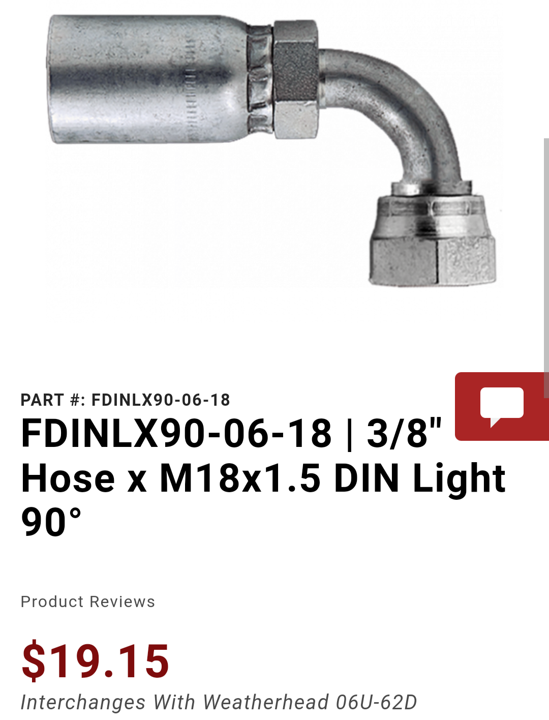

Yeah, except mine are the light series. I'd hate to have to buy many hose assemblies.
Here's the real thing
DHH is pricey on anything metric or BSP. I am sure my loval Parker store wants double that.
This Is more in line with a JIC female swivel end.
This is actually a clever design with what amounts to a plain stand tube hose end with factory installed/preset compression sleeve and nut. You could do the same thing with SAE tube and JIC fittings. I have mentally bookmarked that idea.
