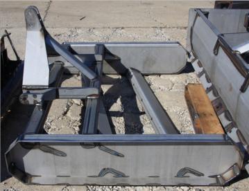

I saved this picture to use for reference from EA site it looks like a good start.
Good luck with your build.

I found some new Land Pride box blade replacement cutting edges online for $45 or so each. They were 60" x 4"x3/8". I'm guessing that if they are stout enough for a box blade they would be ok for land plane. I'll use 3 or 4" angle to back up the cutting edges. I want it heavy so it doesn't bounce around. I'm thinking of building it similar to your picture, maybe a foot or two longer.
