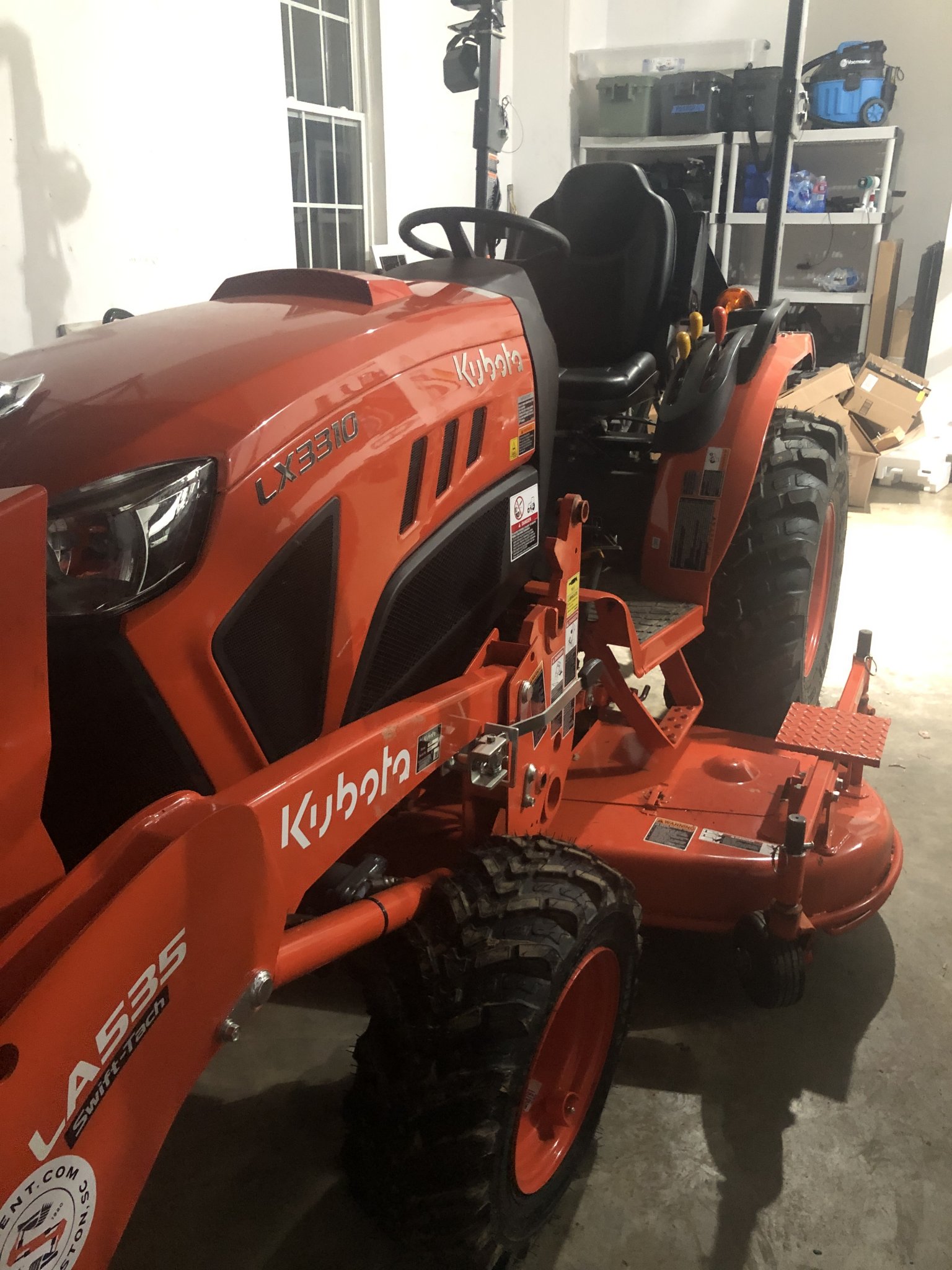

I am the proud new owner of a LX3310 with a LA535 swift tach loader. I took delivery approx. 5 days ago. As of yesterday I thought the loader looked like it was bent on one side. My local dealer recommended I dethatch the loader then reattach it.....as it will like straighten out.....long story short while reattaching the loader it did not seat properly and fell with the hydraulics resting on the tractors front axels...How this happen I am not positive. I am sure I did something wrong. However, I was following the manual step by step. Given the weight of the loader I plan on using two floor jacks to lift the loader arms of the axels.

here are pictures...
Pics are helpful even though they don’t show the stand / bucket end. You have a WAY different system than mine when it comes to comes to the stand arms, so ignore everything I said about stand arms. I did see a video on how yours works:

Long story short a Kubota tech came out and lifted the loader off the axels. His approach to the situation was almost identical to how I planned on attempting to lift the loader. However, he had the great idea to disconnect the upper hydraulics from the top pins. This allowed the loader to lift/raise up while allowing the stand legs to swing back into the lock position. Also, the front wheel had to come off.
