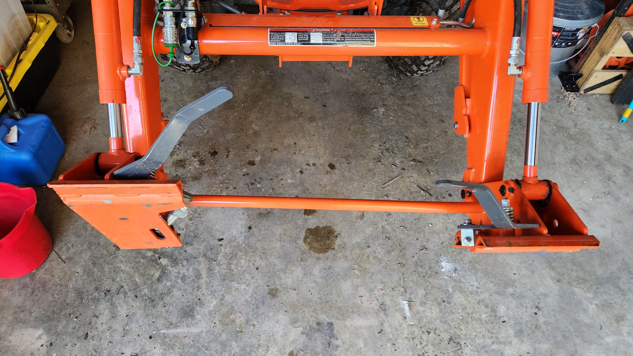

I have a L3302 with the LA526 loader and SSQA. I was removing brush/overgrowth from my field when a branch must have disengaged my right latch causing the grapple to become unattached on that side. This caused the quick hitch weldment to twist and resulted in one side sticking out quite a bit father than the other.
I came here looking for suggestions other than purchasing a new weldment ($2095.00). I watched both videos above posted by NCL4701
I then proceeded with the suggested repair. It worked perfectly. Be careful not to bend it too far back, or you will end up having to redo the process on the other arm.
I also drilled my latches and attached cables like the ones in the above pic. Even though this was an easy fix I don’t want to have to do it again.
This is a great forum. Thanks for the help.
Pics:
Top: After straightening as per video above
Center: Safety cables added to prevent re-occurrence
Bottom: Twisted Quick Attach.
