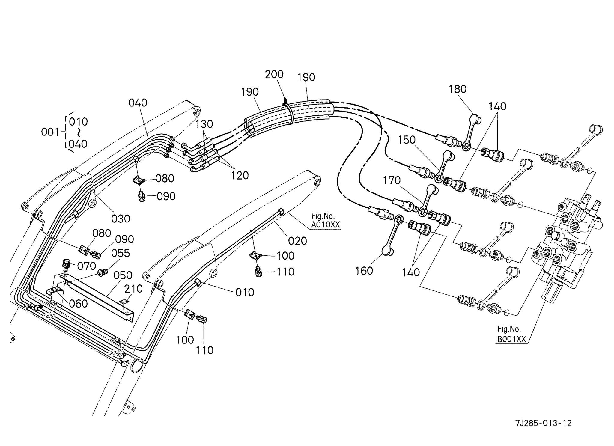

One of the lines on my LA524 attachment of my L3200H burst today. I ordered 4 new hoses to avoid more issues going forward and they'll arrive Tuesday.
Can anyone provide any insight on the job of changing those hoses? Is the low end a coupler? The top end appears to be a basic fitting, but I can't tell if the low end screws off, or what.

Found this online, it may help.....
be sure you use proper sized wrenches on the fittings !
Kinda obvious but...do one at a time.

Have the bucket on the ground and run the controls through all of the positions with the engine off to relieve the pressure in the lines.
