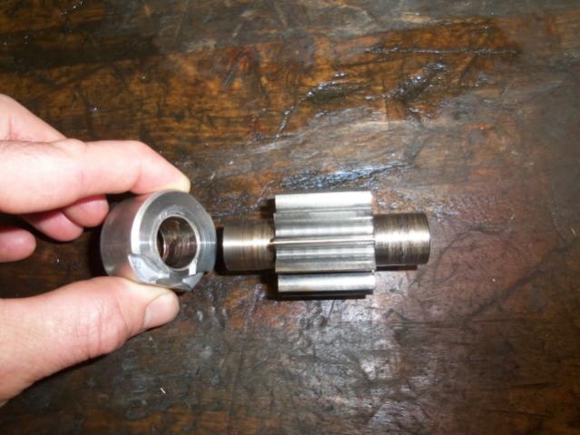

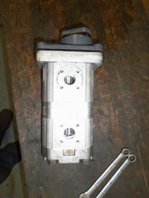

I am helping out with an L48 with around 2300 hours that has failed 4 front main pumps over the last year and 300 or so hours of use. The first 3 lasted about 2 hours each. The driven gear in the main pump eats into its support bushings and into the housing, causing a loss of flow and pressure, especially when warm. It's a tandem pump made by Hitachi, and the P/S portion looks fine. Even the drive gear and shaft look OK in the main pump. The factory service manual pretty much just shows a direct pump test, which it fails now, but passed when the pump was new. Pressure is OK beyond the main relief when cold, but drops off when warm.
Not sure what else to test. Blockage? Overheated oil?
After the other failures, the tractor had lines flushed, new factory oil and factory filters. The last time the tractor got a new main relief valve and new couplers out to the backhoe. They were a potential source of restriction.
Even before this pump was pulled off, the machine seemed normal until it warmed up. The pressure and flow test pointed toward a bad pump, and removing it confirmed it.
Any ideas or anybody seen a pump look like this? A good Hitachi pump service center?
Thanks for any advice.
